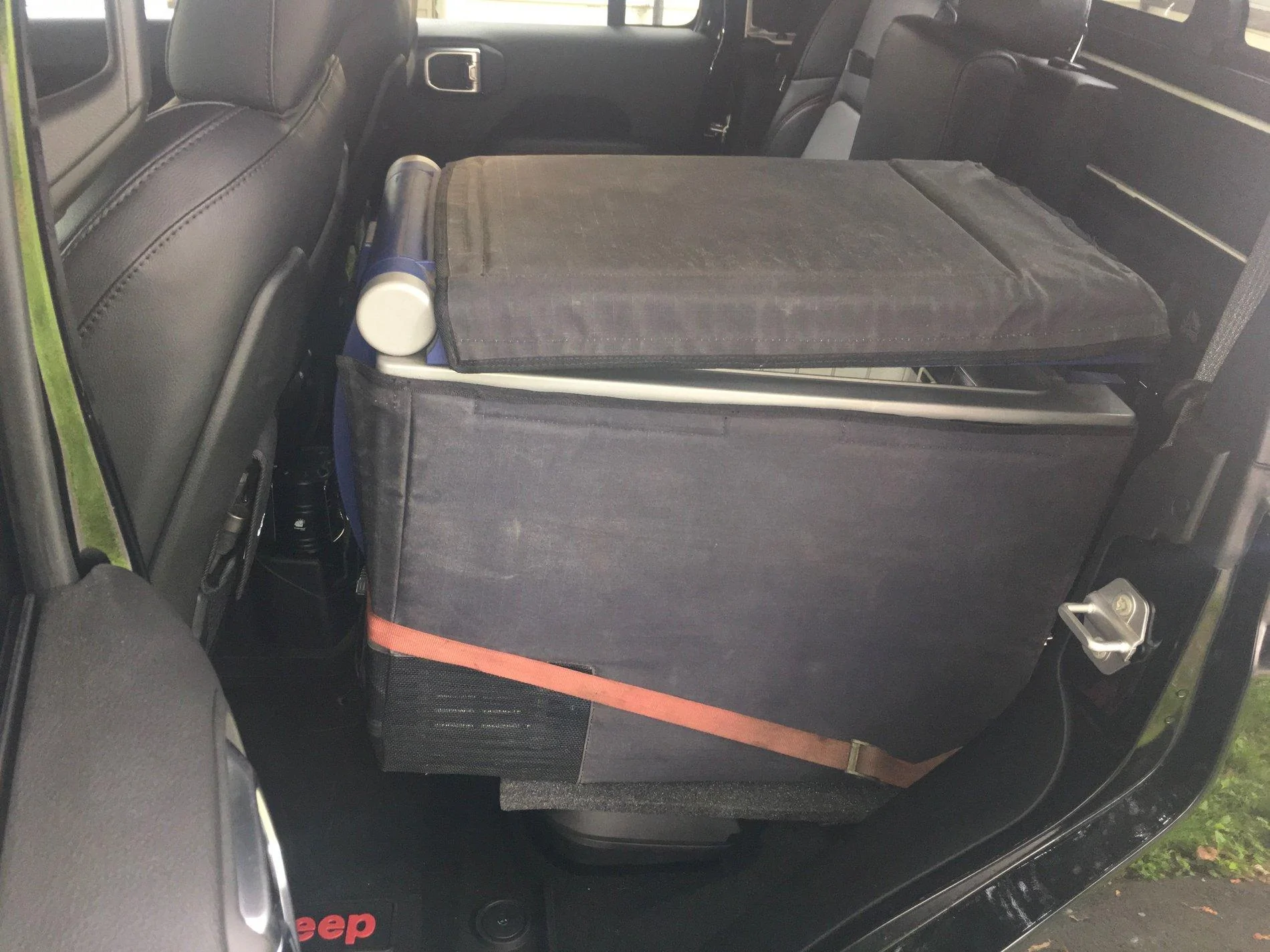

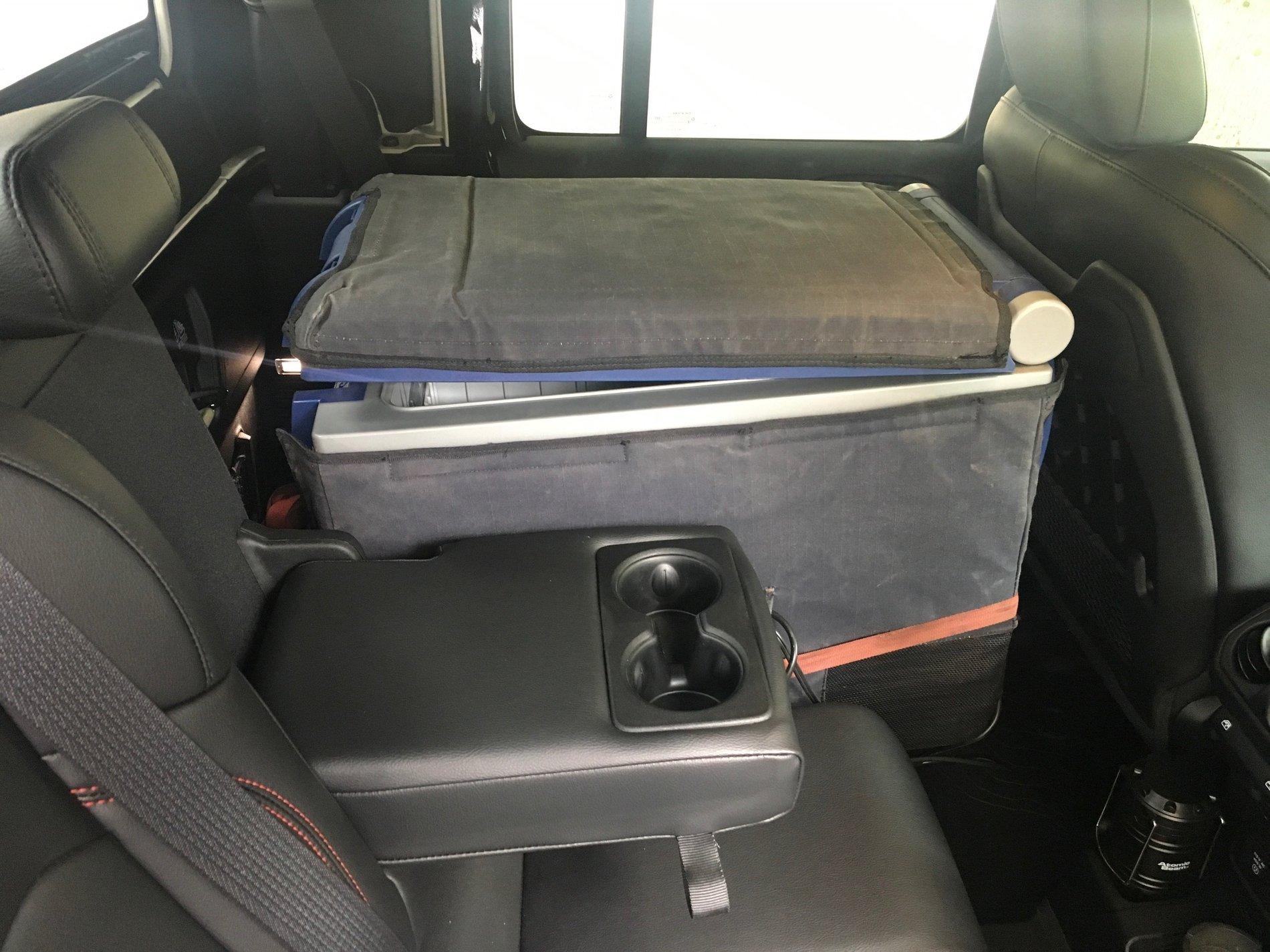

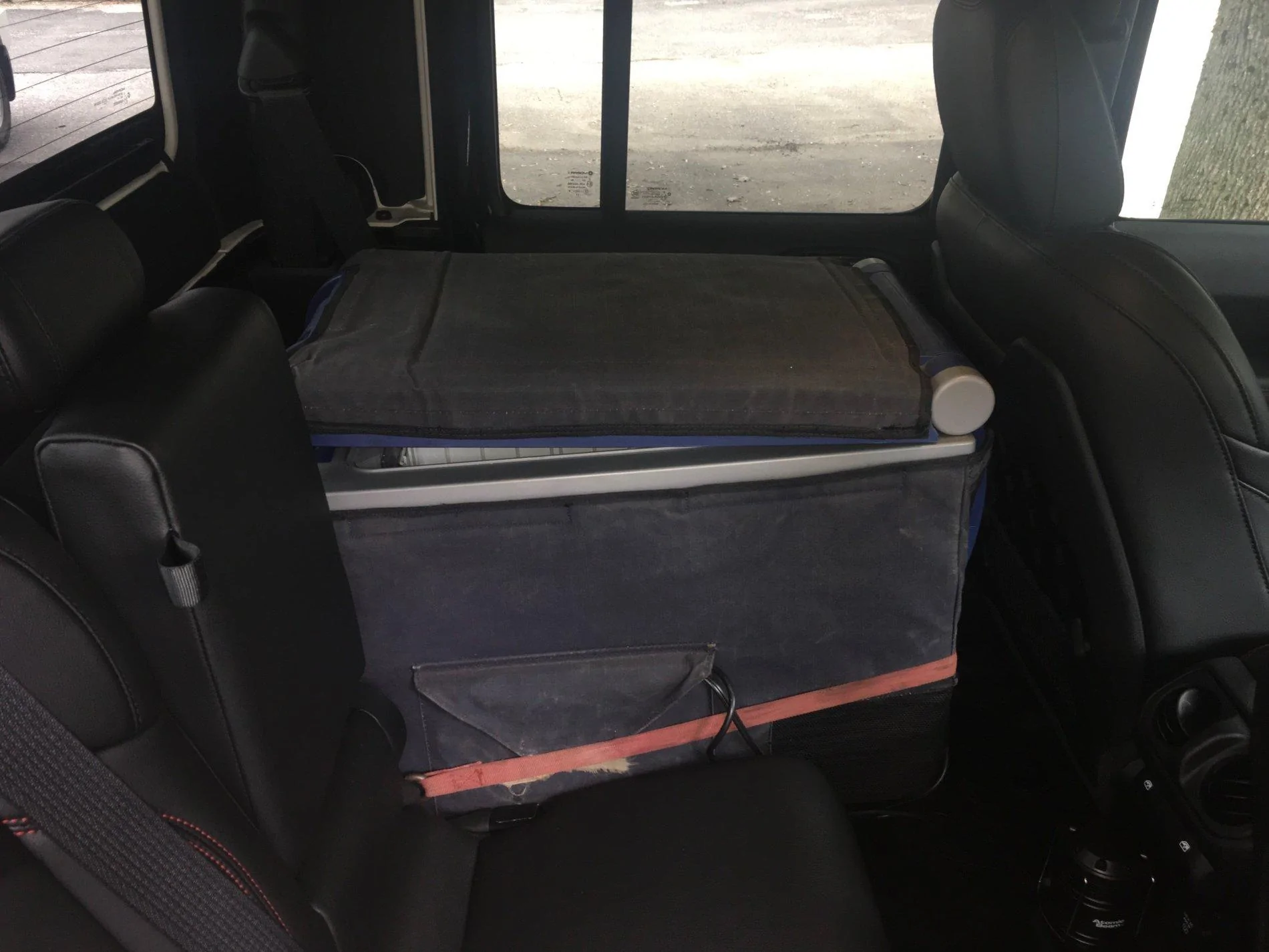

i've been running this fridge freezer for ten years now. Best money I ever spent for camping. 12vdc/110vac, low power consumption, well insulated, plenty of room for grub.
Decided the best spot was behind the driver. The various passenger seat positions really didn't give what I wanted. The seat had to go! Easy to do, 4 floor bolts, two 10mm bolts to the other seat and two torx screws for a plastic trim piece and out it comes.
At this point the floor and storage box provide a decent platform and a strap attached to two of the floor bracket bolts holds it in place.
This will be powered from one of the aux. switches. For now it runs from the 110ac outlet.

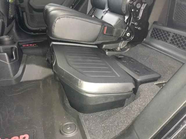

@Rokon could you post a pic of the seat (mounting area) that you removed when you get a chance? Thx
I'm planning on removing the 60% side for a fridge, air comp, etc.

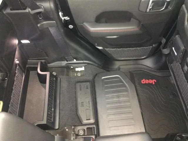

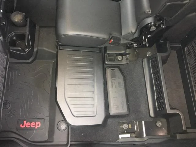

Your setup looks nice.

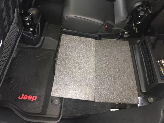

Here are some pics of the “blank slate” space after removal of the drivers side rear seat. The drivers seat is full to the rear. Also a shot of the 1/2” dense foam pads that the fridge sits on atop the storage box and hardware box.

Thank you for post the pics.
A lot simpler than what you have to do to a JKU.

I may fab up an aluminum base frame that bolts to the seat bracket holes with legs that sit on the floor mat. Then secure the fridge to that frame.
Currently the only drawback to this setup is it is hard to read the fridge readout as it is at the rear. Turning the fridge around, the lid hits the crossbar of the roll cage and doesn't open as far. That and the fridge's air vents aren't as clear.

@Rokon What are the dimensions of your fridge?
TheITGuy
May 21, 2019
74
604
587
NW Iowa
2017 Honda Ridgeline RTL-E, 2021 Toyota Rav4 Limit
15” wide x 20” tall x 26” long. These are max dimensions.
Thanks. My Yeti is 17.5" wide x 16" tall x 30.5" long. I think it will be too long to fit the way you have your fridge in. :(

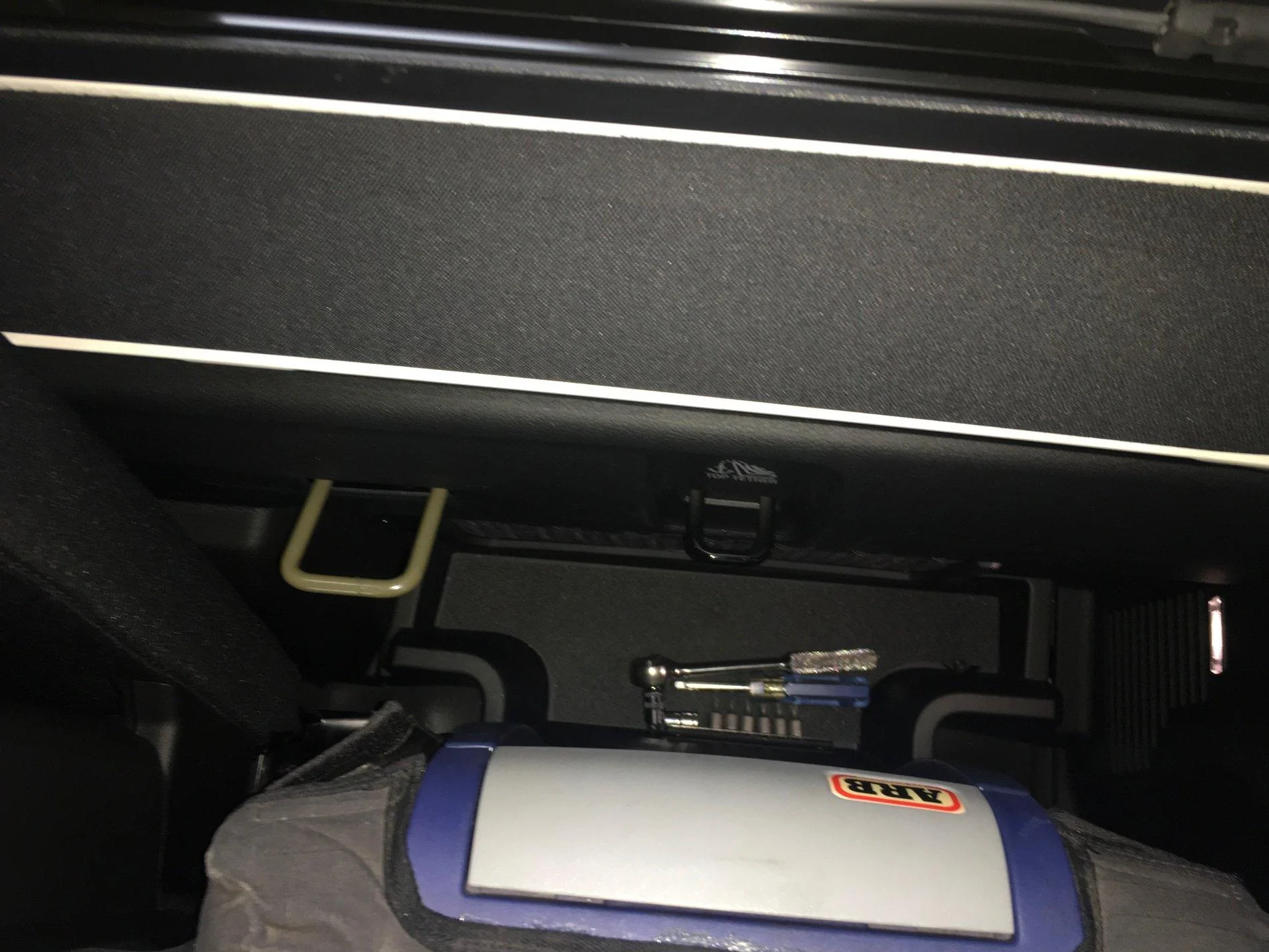

It might still fit. Your fridge isn't as tall. If you fab a platform frame that brings the base even with the backseat storage compartment top edge you'll pick up almost 6” for length. If the drivers seat position isn't all the way back you can gain some more.
After taking a pic I see the seat back latch hoop eats room. Hopefully that can be unbolted but I don't know if that is the case.
