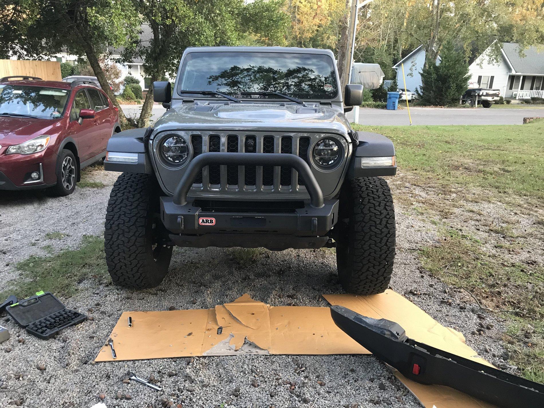

I’m new to the gladiator scene and I’m in the process of setting up my 2020 JTR 6spd in stingray. So far I have installed the teraflex 1.5” and daystar 3/4” spacers, had 315/70 KO2 mounted and installed the ARB stubby on the front end.
For the install I was worried about the front bash plate not fitting without some trimming but, it cleared the bottom of the ARB bumper just fine. The bumper looks a little empty since the mounting point for the winch is a large cavern in the middle but it works until I can purchase a winch.
All in all I’m pretty stoked about the truck. I’m coming from a Nissan Frontier and the aftermarket options for the jt is insane compared to the frontier.
As for the rest of the build I’m not looking at adding too much more. The winch and some fog or driving lights are about the extent of my plans, the jt stock is leaps and bounds ahead of its peers.

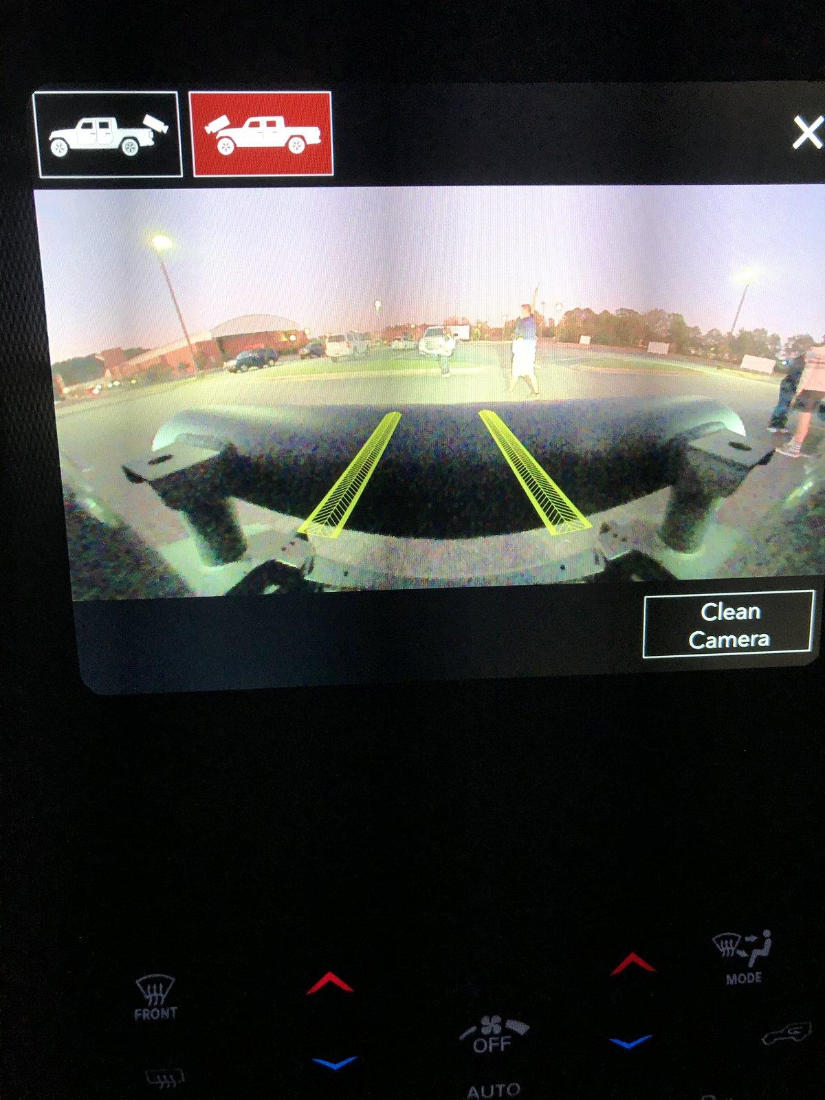

How is the camera view with the top hoop?
The hoop basically blocks the center of the camera. Not great but it’s still allows you to see what’s below the hood line.

OK thanks. Any chance you could grab a picture sometime?

Shot from the trail cam
Jeep Gladiator ARB stubby bumper D0B3C973-A208-4988-BC3D-42A160B42F54
the bar does block the center but, it is what it is.

Thanks! I'll be looking for something without the upper bar when I get a winch.

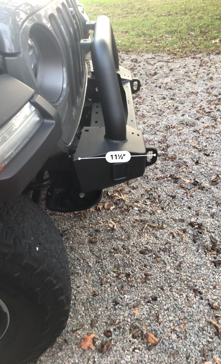

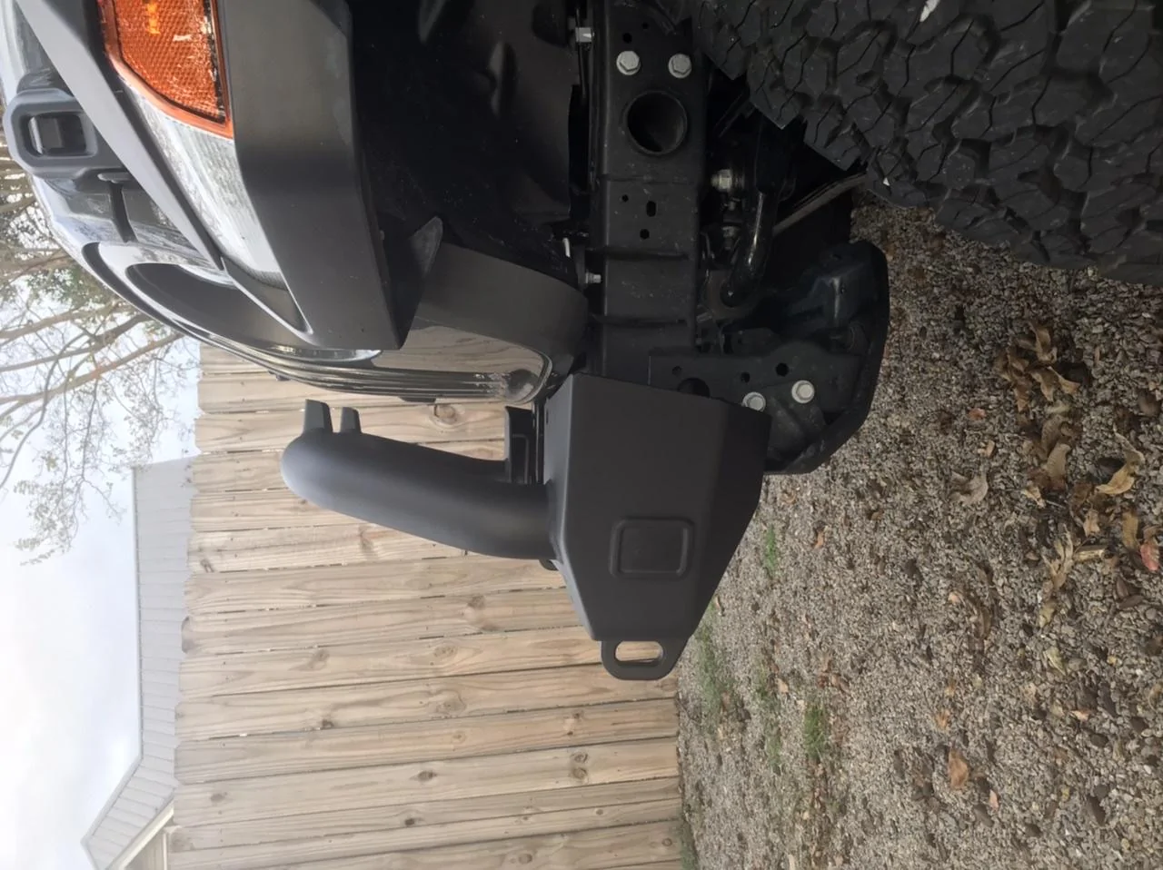

could I trouble you for a side photo? I have a small garage and I need a bumper that doesn’t add too much length in order to fit. A lot of the override bars seem to lean out forward a ways but this seems more upright.
Maybe even measure from the grill out to the front edge of the bumper?

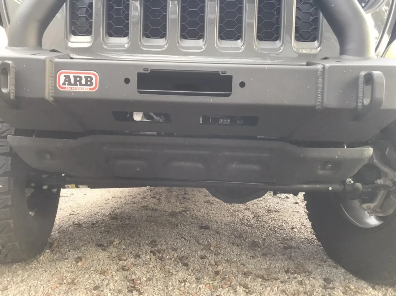

If we're adding picture requests, can I trouble you to take a lower shot that shows the fitament of the bash plate?
The bash plate fits perfect actually. The instructions are for the jl which had a different bash plate for the rubicons. I can get you a shot though.
