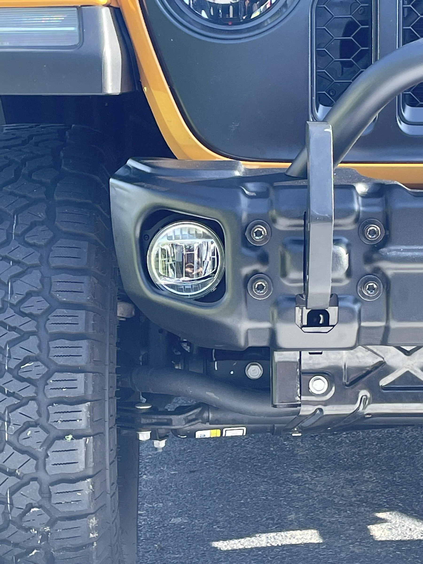

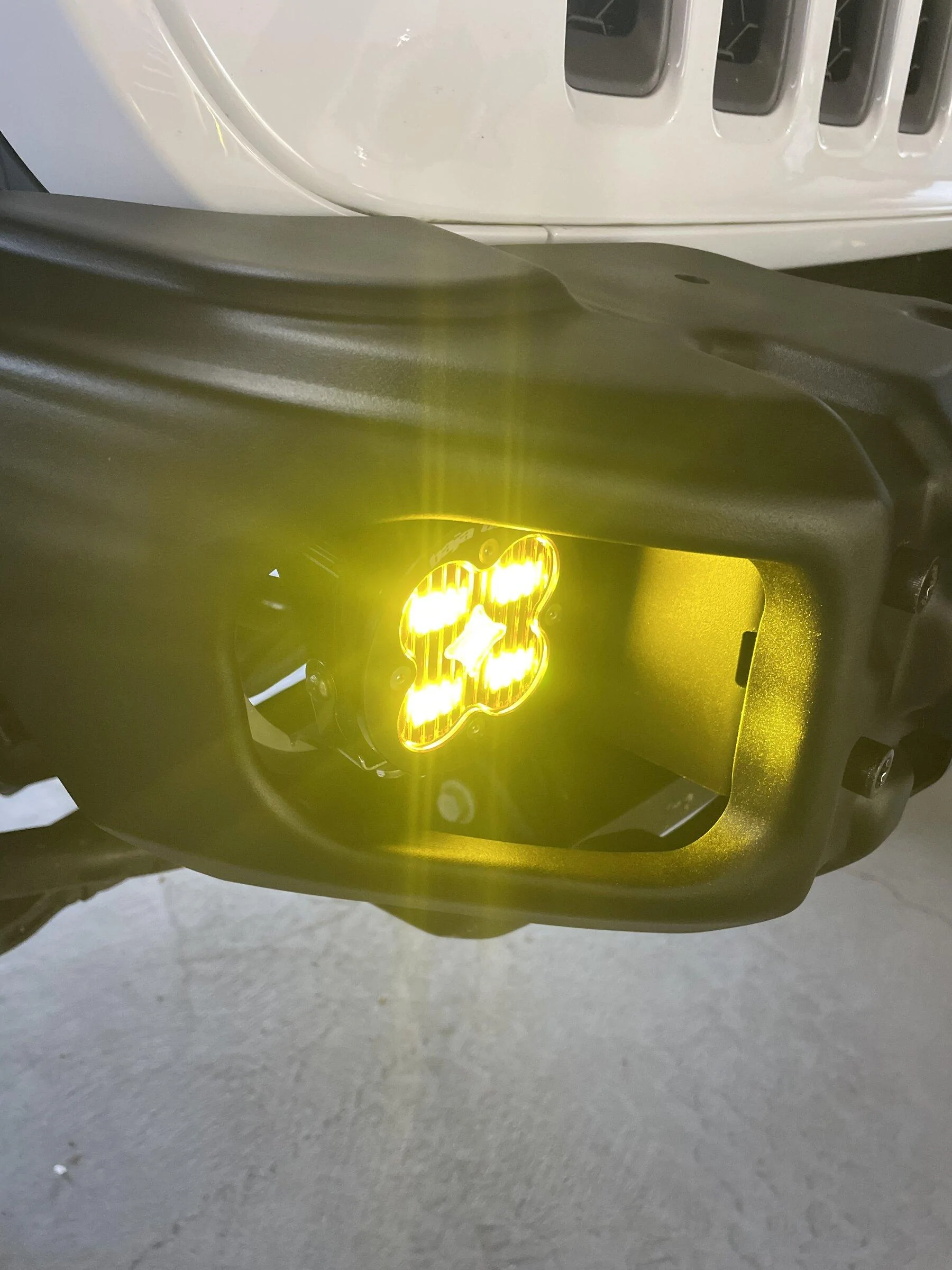

Wondering if anyone has run across this with the fog light brackets with the Arcus bumper.
If you look at the first pic everything snugs up fine. In the second pic you can see the tabs from the heat sink are right against the bracket before even tightening.
Thoughts??

Is it just me or is the light not facing the wrong way in the bracket? That cross support on the bottom of the second picture should be facing upwards and from what I recall I believe the light faces the other direction, no? I mounted Baja designs lights, so I made my own brackets - well adapted the ones that came with the kit.
Jeep Gladiator Arcus bumper fog light bracket issue 5B0C03D7-9DDF-4A99-8962-3F88D9F22317
This is a poor quality image because the light is on, but I’ll snag another pic when I get outside to see if it helps.
Rockabillyroy
Nov 8, 2020
828
878
CA
JT
So one, the light is behind the bracket and the other, the light is on front of the bracket?

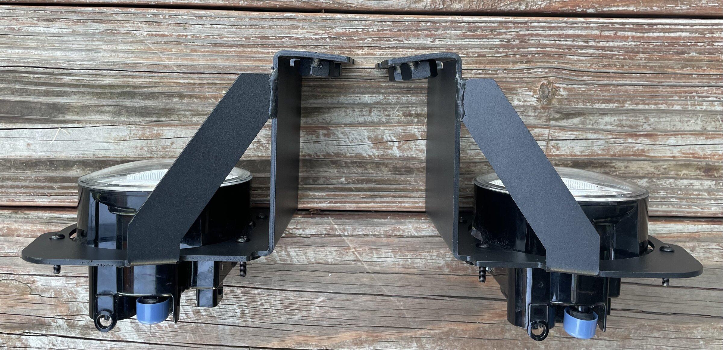

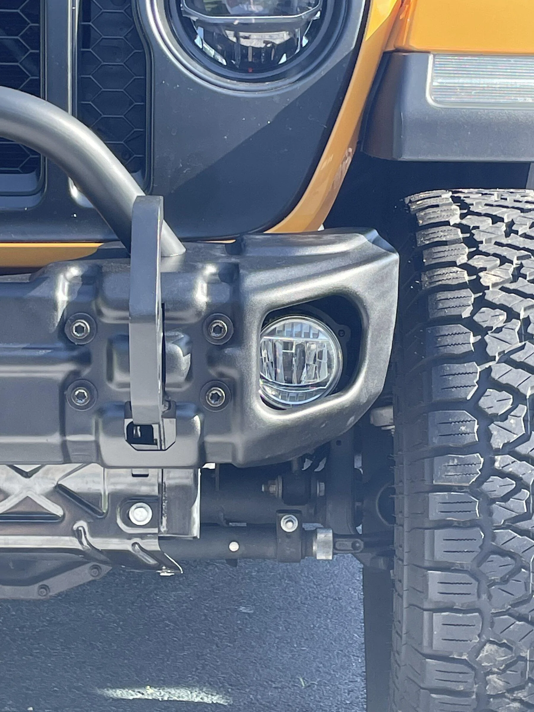

Everything done. Looks like there is an issue with the drivers side fog light bracket.

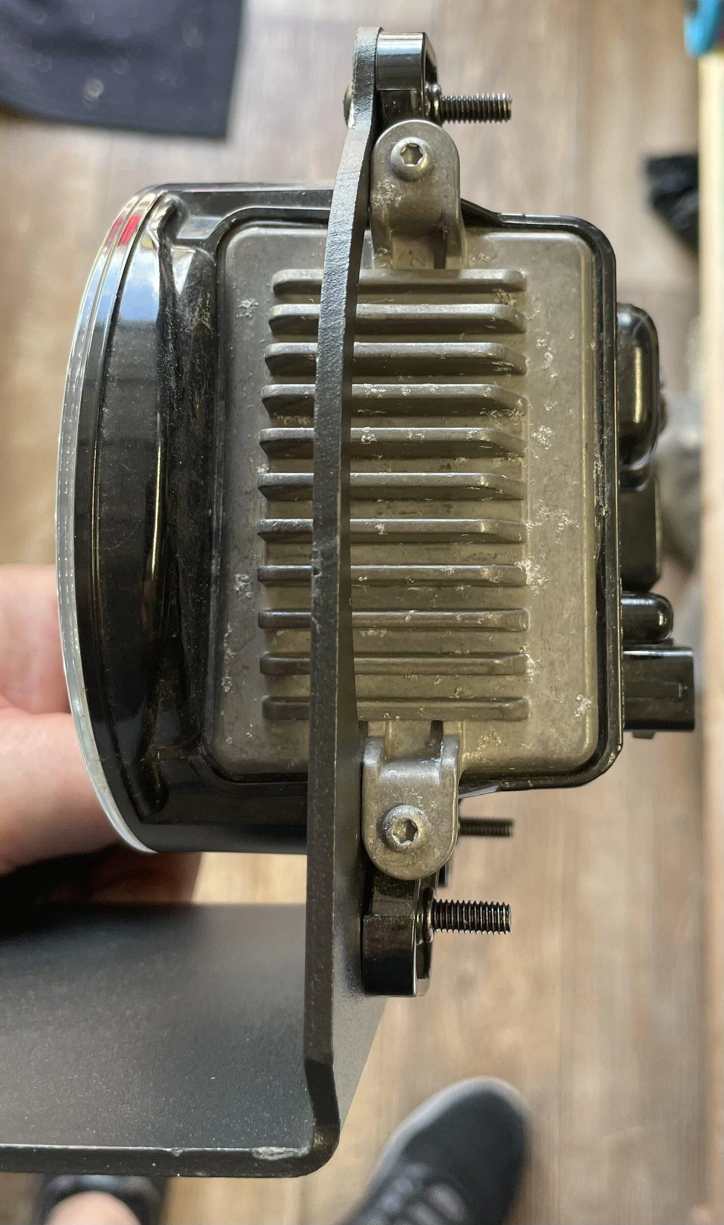

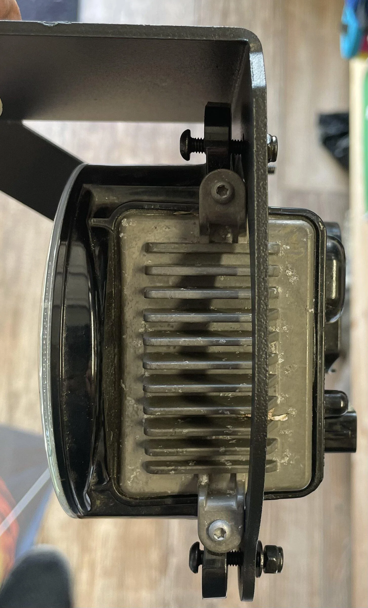

And there's the problem. Looks like both brackets are bent to some degree.
Jeep Gladiator Arcus bumper fog light bracket issue C6E2BCC1-8CC6-4870-B5CA-56881BFF76BD
Damn.... Now I am going to go look at my brackets. Ordered Arcus because of the Amazon deal, but Gladiator is still being built.

Yep. One of mine was tweaked too. Nothing a couple of love taps from mjolnir can't fix.
