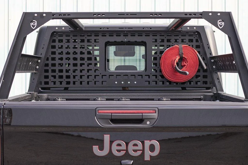

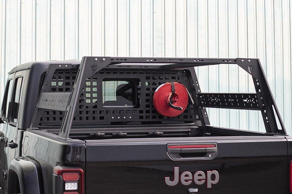

Our rack sits about 1 - 1.5" under the roofline on center and maybe .75" on the sides. That shouldn't affect your kayak mounting, they would just be sitting at a very slight angle. I mount my rec kayaks on J-mounts on the rack only, but I understand with lake kayaks you may want to support them over the roof as well.

Thanks Daryl, with the kayaks being on the long side we'll want to try and get the support as level as we can. I'll play with the numbers and see if I can get a mix of Yakima towers to work with that difference.
