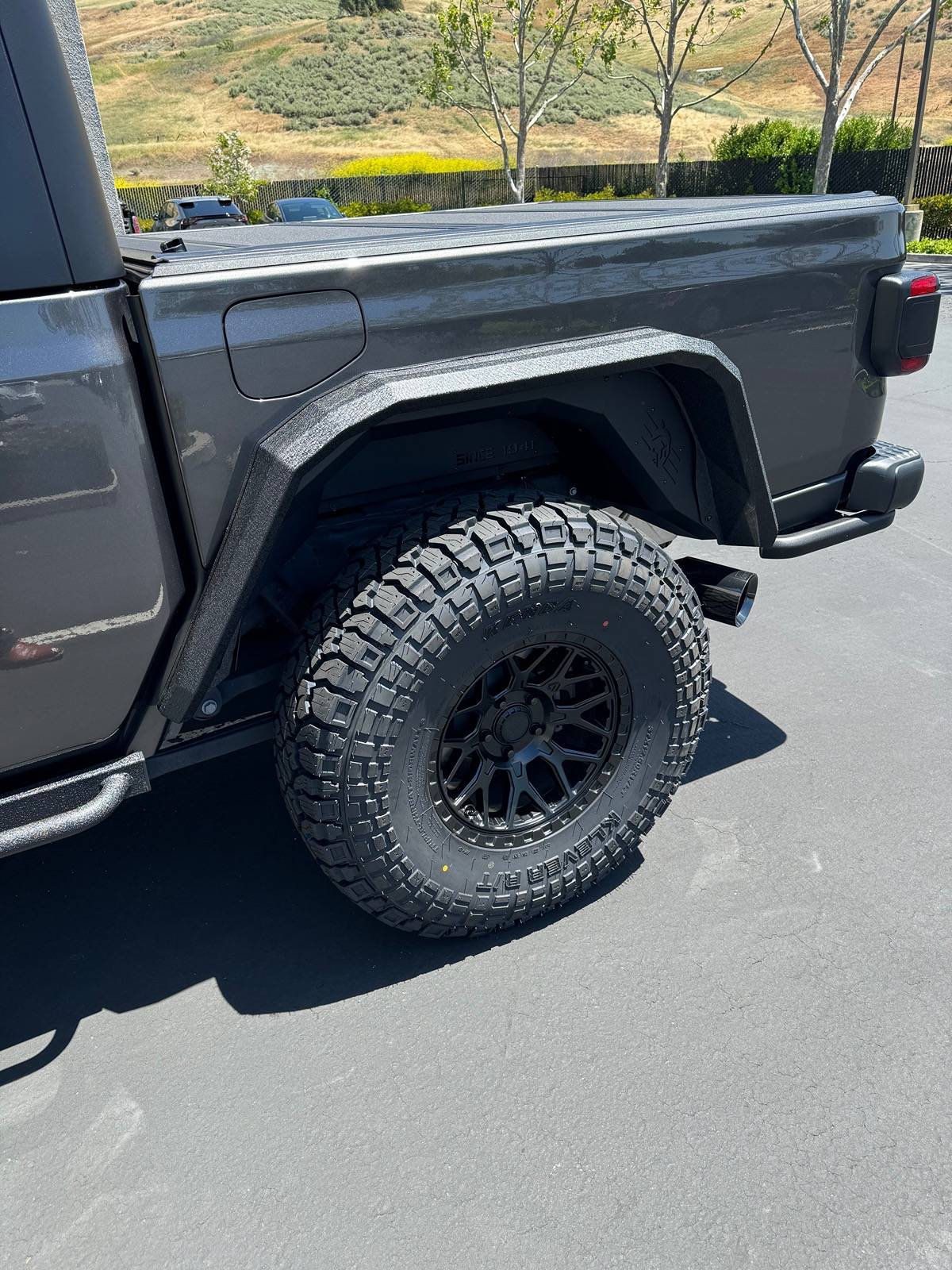

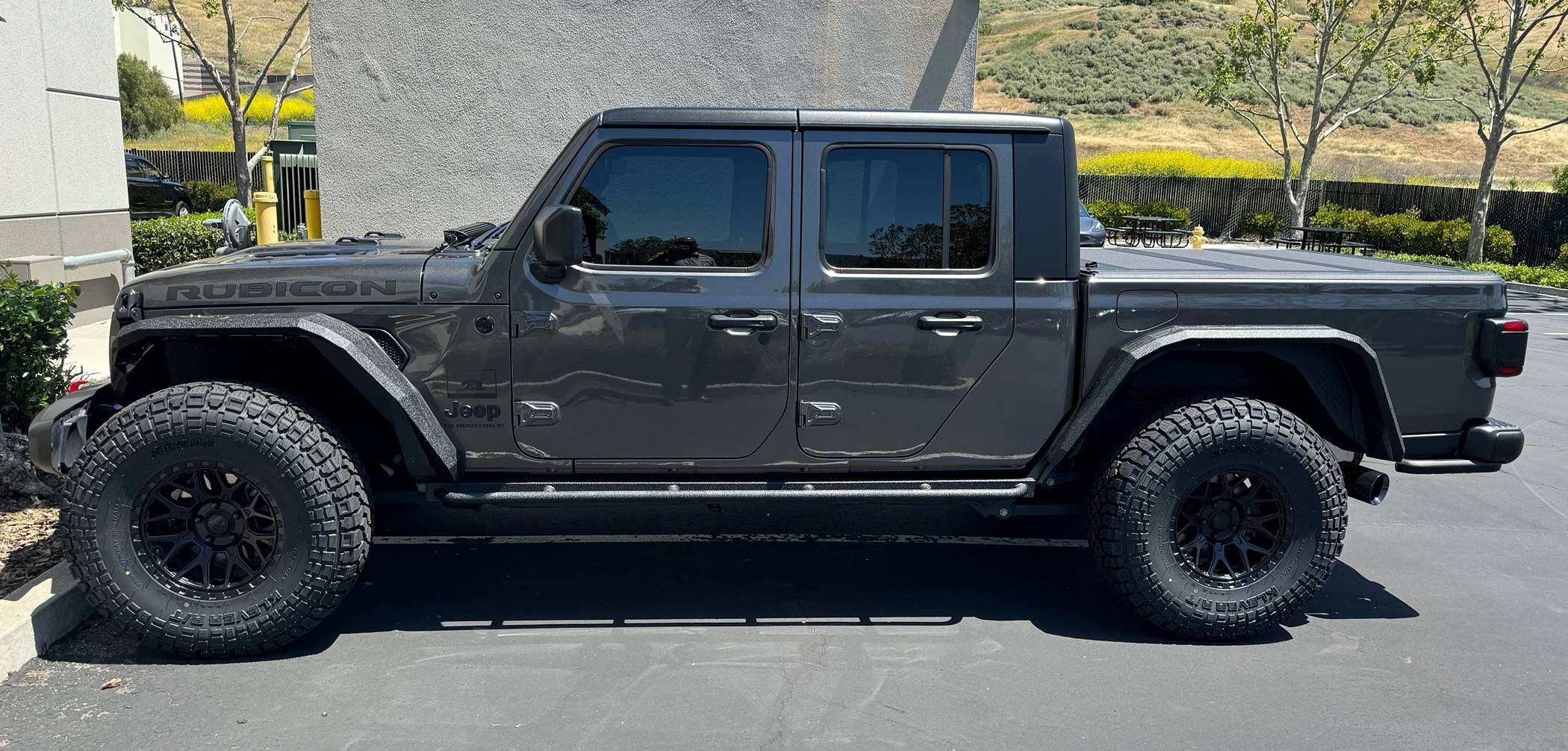

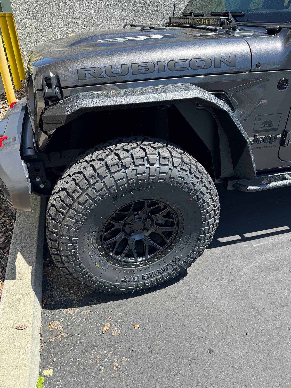

I have 37s with aftermarket wheels, 0 offset. No rubbing, lock to lock … mainly street so far. From what I can see … still plenty of room for my needs - beach, fire trails and snow in the winter.
I did rehear tho.
So far so good for me. 👍🏼
Hope this helps…
