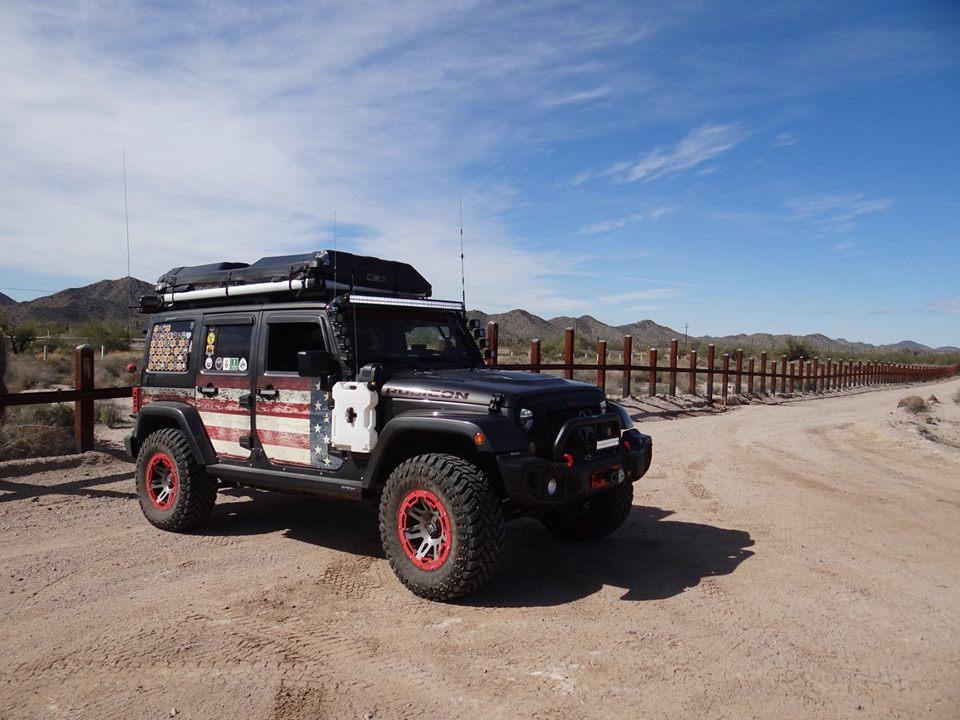

Both of my Overland Built JKs (1 Sahara, 1 Rubicon) weigh in at 6700lbs, Standard springs that come with lift kits cannot compensate for all the gear, supplies, fuel and roof top tent on a 4dr Wrangler. I went to TeraFlex Outback springs which helped but to keep the Jeeps from sagging like an old Wagoneer in the rear, I had to install air bags. I wondered if this was out of the ordinary and found out that several members of my overland Jeep club (JeepExpeditions.org) said they've had their Jeeps weighed when loaded for a week long adventure and they also tipped the scales at over 6000lbs.
So yes, if you are overlanding and hit the road for 5, 8, 14 day or longer trips like my club does, your gear will add a "ton" of extra weight that stock and most aftermarket suspensions were built for in a 4 door Wrangler. However with the Max Tow option your Gladiator is more than capable of dealing with the weight of an overland build.
Hopefully later this year when I can order a Mojave Diesel Gladiator, I can post pictures of my build here.
My Rubicon Overland Build (was at SEMA 2018 in the South Hall) along the border fence with Mexico on a 160 mile overland trip in February.

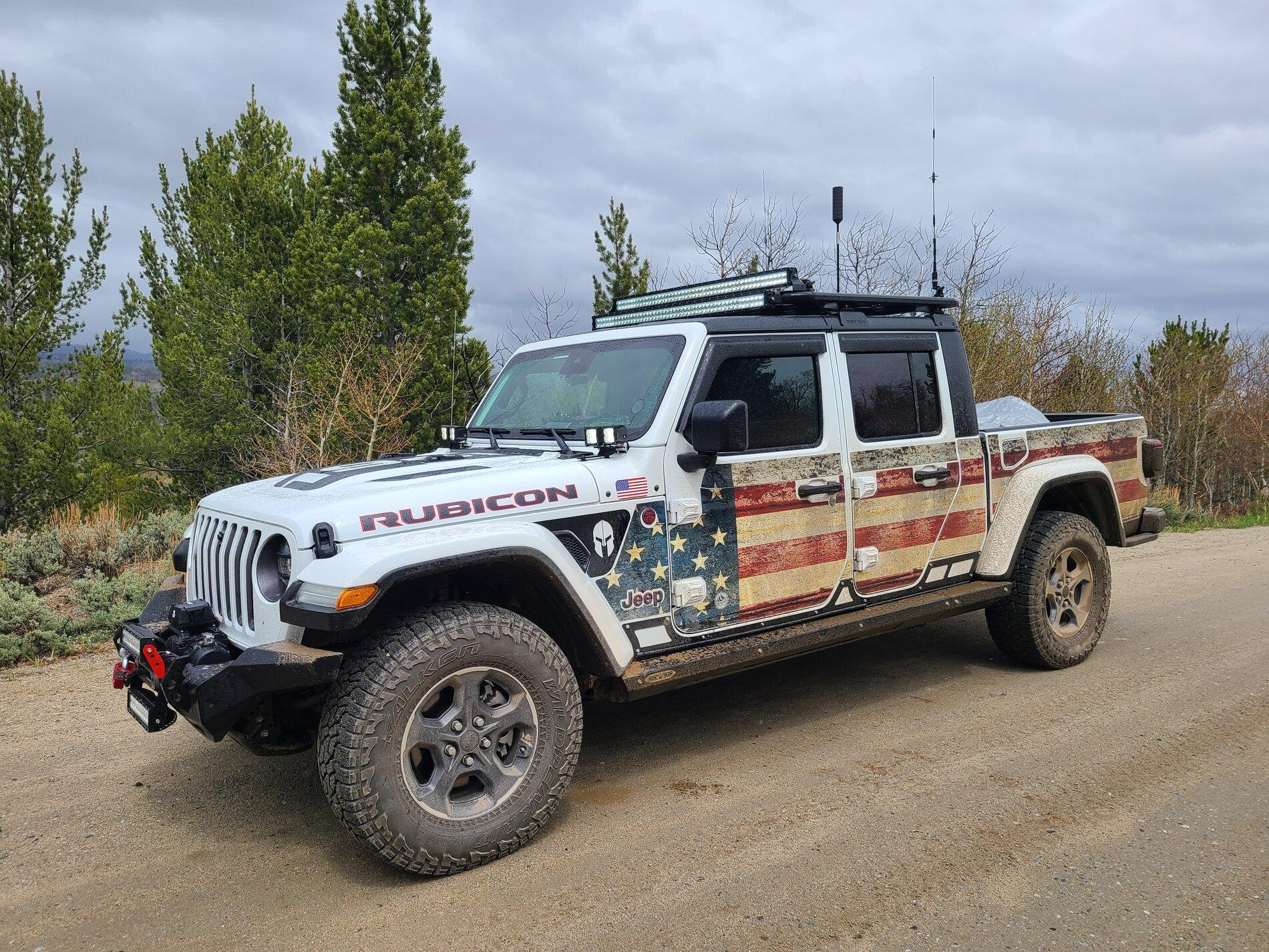

Here I am on my 1st big trip, the 6 state, 2800 mile Heart of the West Trail. This is somewhere in Wyoming before we did the Jeep Badge of Honor trail - Monument Ridge.
Jeep Gladiator Are most Overlanding rigs overweight? 20210521_145245
