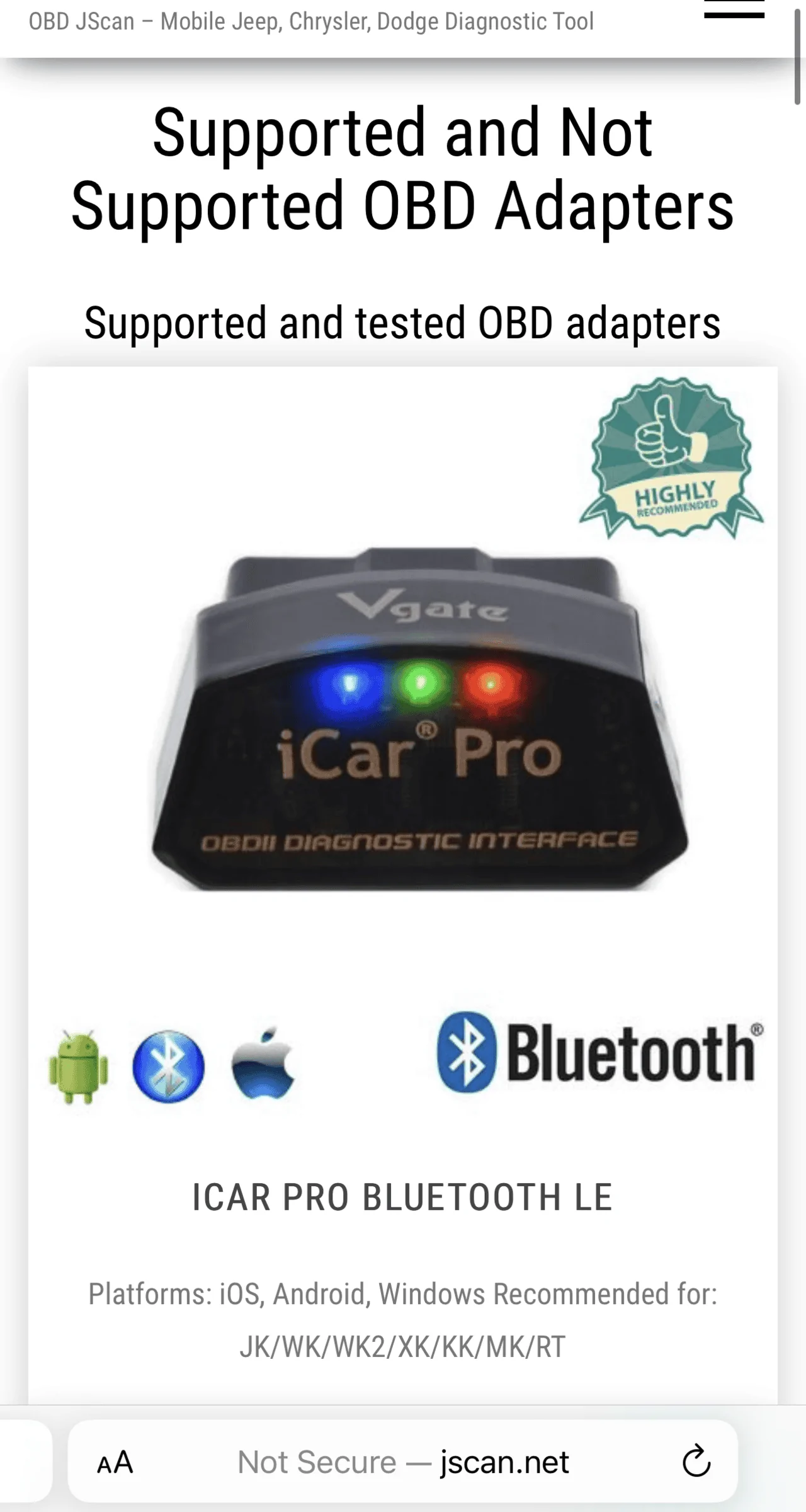

So that OBD works with your JT? I only ask because JScan doesn’t have that one listed as recommended for the JT. This is straight from their website.
Jeep Gladiator Assistance/Advice Needed for JScan - Changing tire size. 1639316294851
I’d love to buy this one because it’s like a third of the cost of the two they recommend.

I have the Vgate you displayed - and it works with jscan but due to the speed requirements of certain things in the Jeep system, jscan can't do SOME things with that adapter. For most people that adapter which is what, about 25 bucks? will do fine. It works with tire settings and other things.
I just found a couple of areas it didn't let me reach (and sorry, I can't recall which! It's possible I was just snooping around trying to see what damage.......... er, what I could learn when I got the error message. ) so I turned around and bought the more expensive one.
I don't dare let my wife know because she always gets all over me for trying to save a couple of bucks. She'd ask "so why didn't you buy THAT one to begin with, ya big dummy?, you know better than that".
Anyway, that Vgate iCar pro works fine for most things. Tire size settings will be fine with it.

Ok, thank you. So that makes sense why they don’t recommend it for the JT. I’ll just buy the more expensive one they recommend because the functions that don’t work with the cheaper one would probably be what I end up needing at some point, 🤣
The one your picturing is the 'Vgate iCar pro LE' The one he bought was the 'Vgate iCar pro BLE'
The 'BLE' is the same one I have that works just fine. Similar but different models names on the adapters.
This is the one I bought from Amazon:
https://www.amazon.com/dp/B06XGB4873
