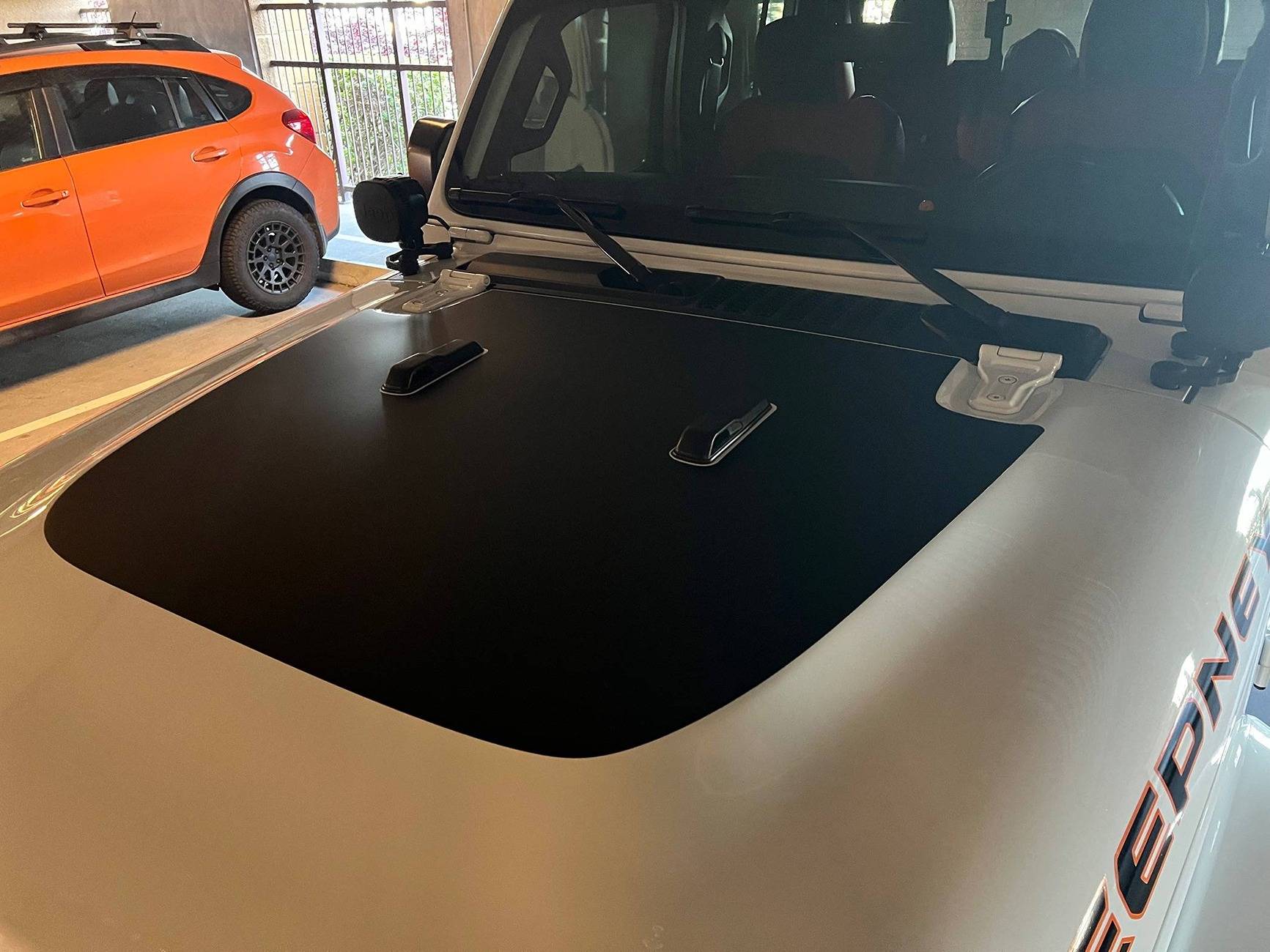

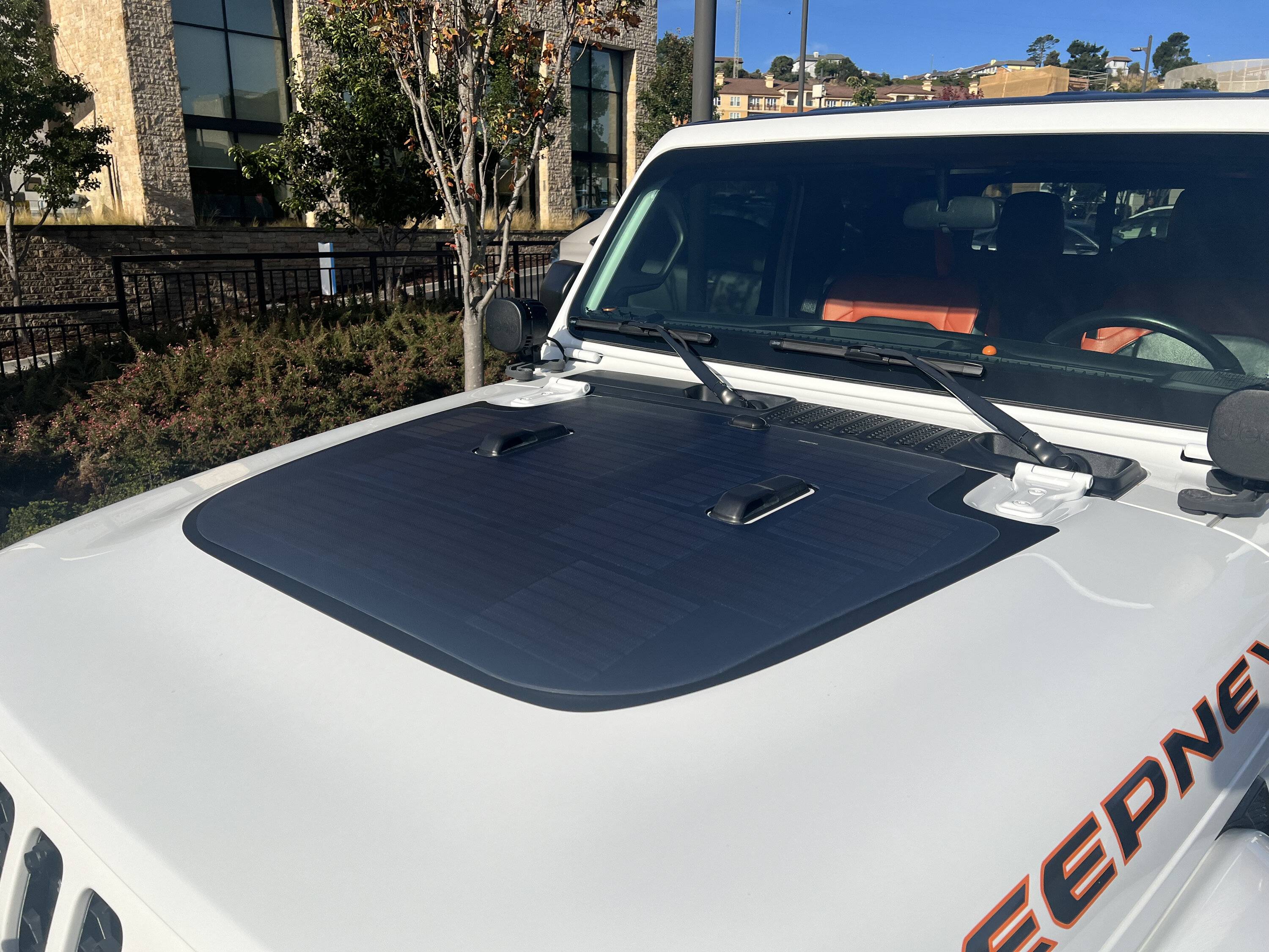

But mine actually works to keep my main battery topped off.
I daily drive my Glad a total of 6 miles round trip and as expected those 6 miles is barely a drop in the bucket to keep my main battery optimally charged. Since installing, the voltage is steady at 12.7V @ IDLE!!! I'd be lucky to have that kind of voltage after a few days with a freshly charged new battery. Granted my Glad has to be parked outside at work in the sun for 8hr/5 days a week.
Best Jeep Mod I've done to my 2021 Sport S.

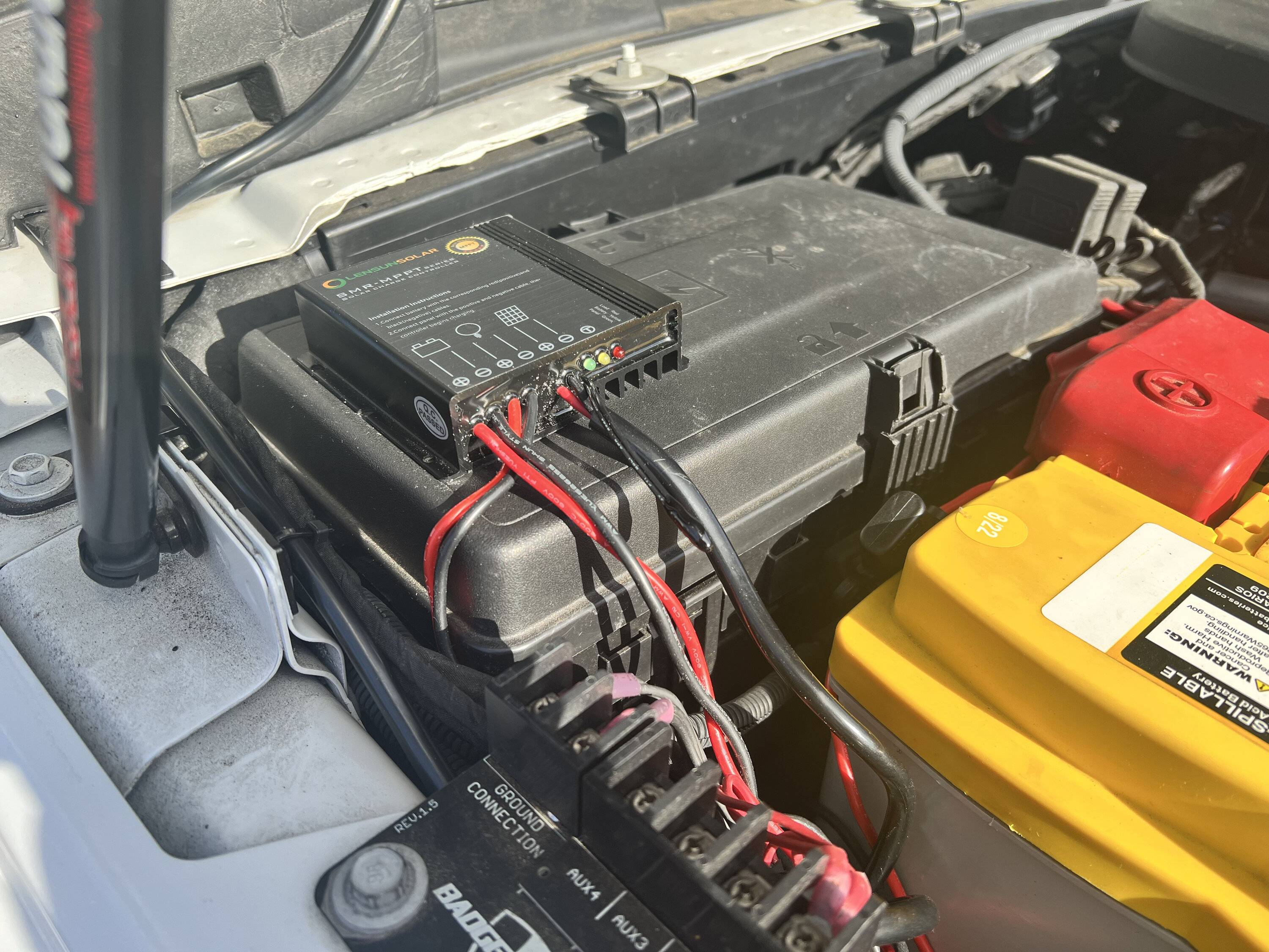

Did you do the Aux Battery Delete? Curious to see if I can reconnect Aux Battery and have the panel charge both.
I'm not who you asked but it does with mine. It's been installed since 2020, the ESS battery failed last month almost 4 years old. The main battery was / is still good but replaced in Jeep still.
