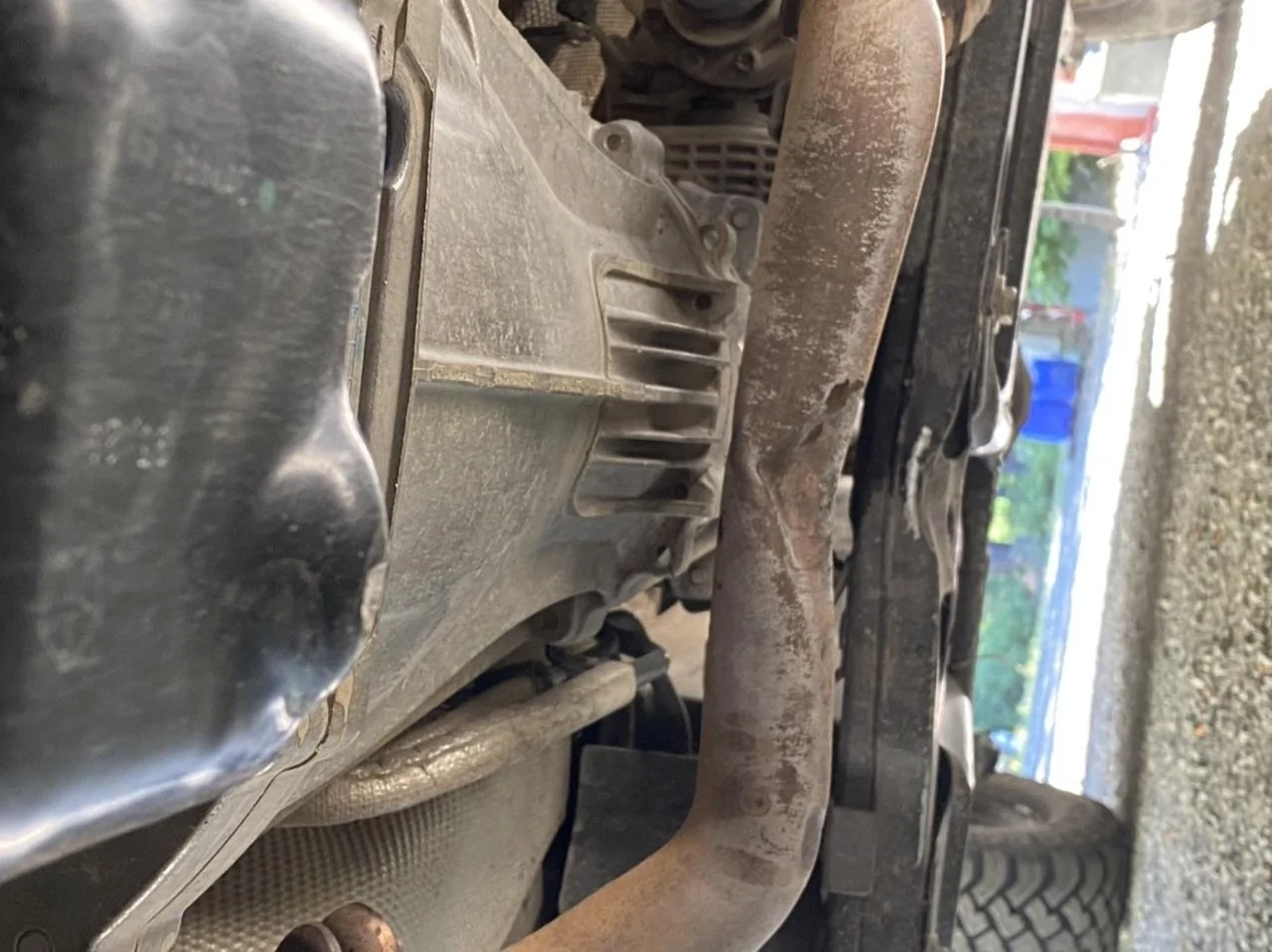

Definitely the oil pan/transmission skid.
It’s supremely vulnerable and soft. The shocks and diffs are all really solid steel so can take a glancing blow. But the oil pan and Y pipe are soft and don’t take much to deform.

Jeep Gladiator At what point are additional skids needed? 641322EB-536B-455A-8E9A-6E533923D973
This is true, but where its higher up I went with an aluminum engine/trans skid from ASFIR. Yours looks like a manual transmission though so the exhaust may be a little different
Yeah, i have a manual. So theres no added crossbar across. I ordered up a new Ypipe to replace the damaged one, and got Quadratecs aluminum skid on its way to cover up that area.
