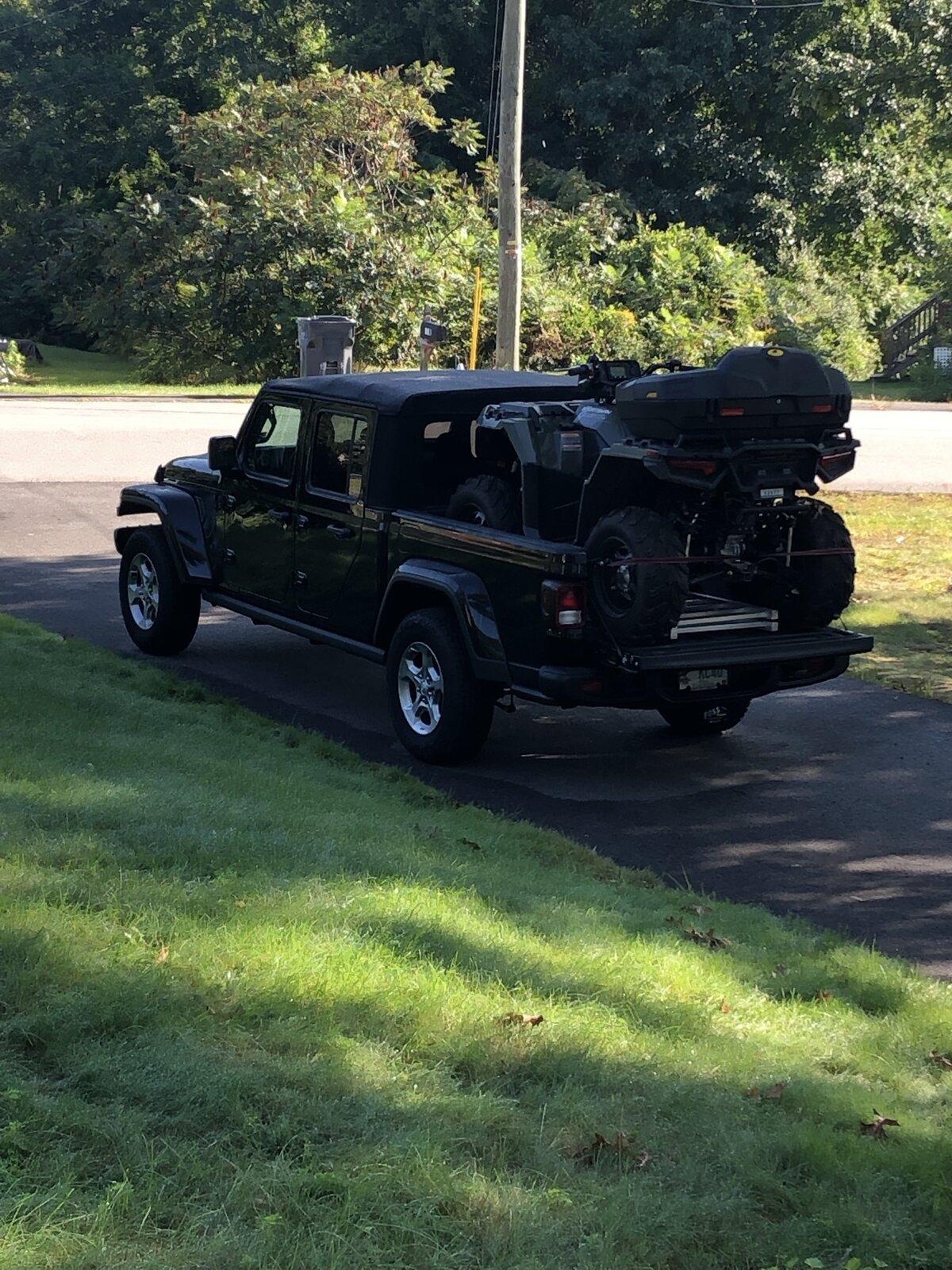

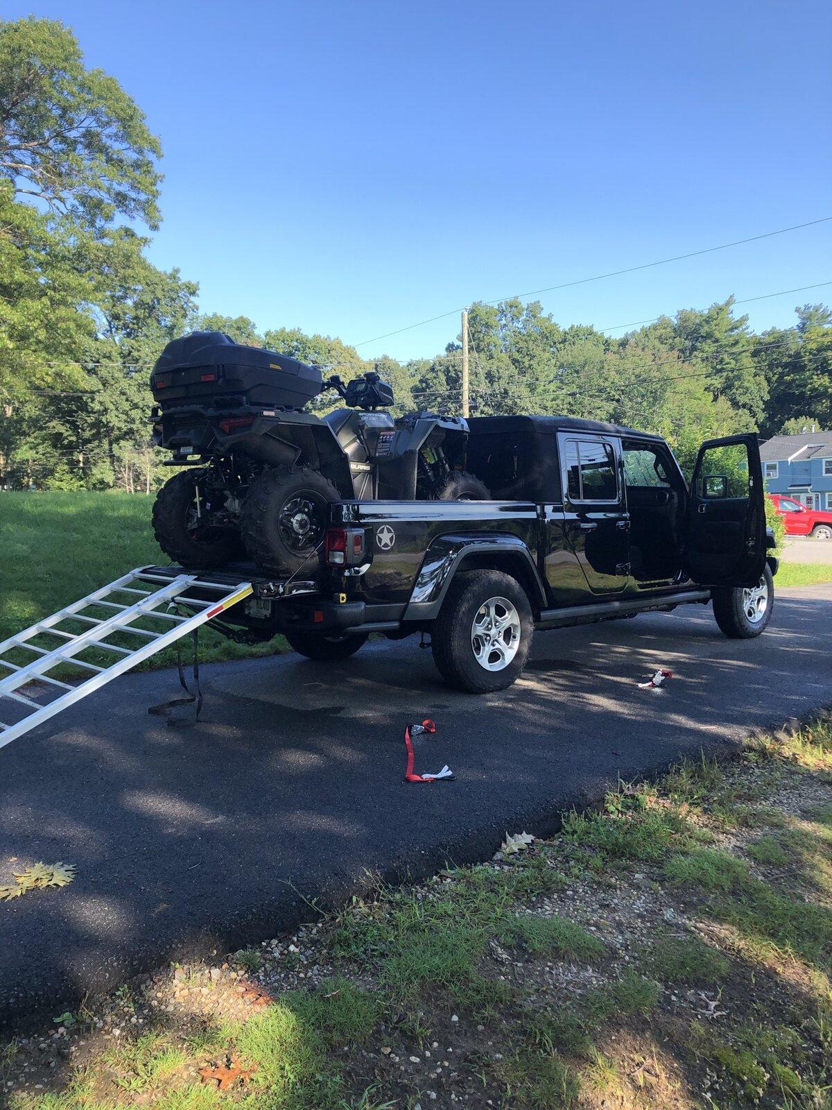

So I put my Polaris 850 in the bed of my gladiator. The tires are stock but says can hold up to 2200 lbs at 44psi. The tires on the keep where still a little wide on the pavement. Should I be ok or get a different tire grade? I know people are going to say get a trailer but it’s easier throwing it in the back of the keep.
The Atv is roughly 800lbs

That’s 800lbs dry right? With passenger and other gear you’re likely close to the limit. I don’t think the tires are your biggest limiting factor but from the rough math they should work.
How far would you be driving and what road conditions?

800 dry yes. I mean I’d like to drive roughly 2 to 3 hours. Mostly pavement to get to the trails. I drove 45 min with it in the back and I was worried about the tires mostly. But It did good. I just don’t want anything to happen and asking to make sure I’m doing things right.
If I make the drive up north that’s 2 to 3 hours it’s mountains mostly.

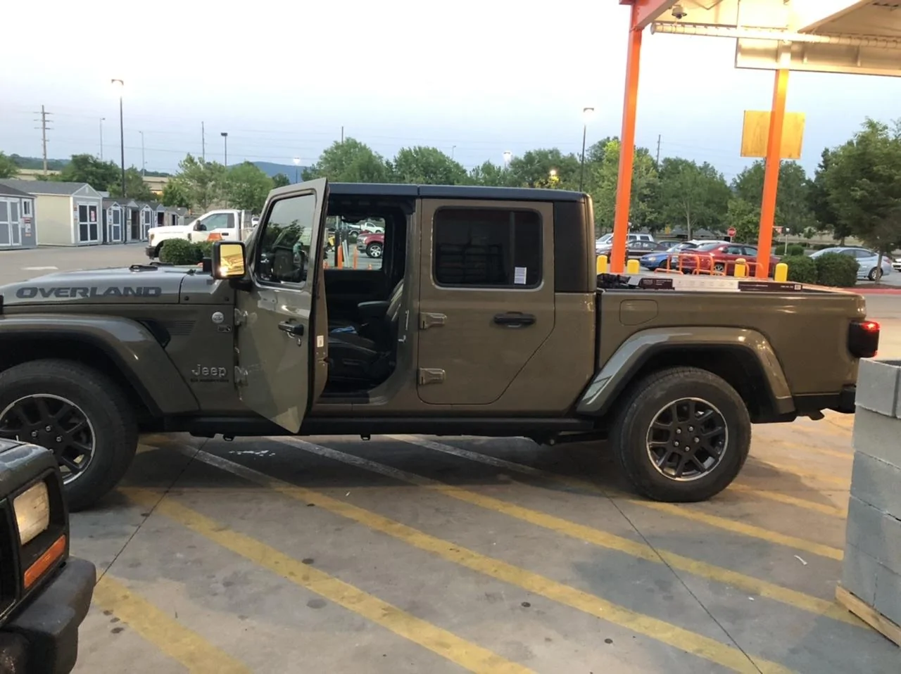

I've done a few trips this year with tile and flooring that I was probably at or over the limit with no issues, I just slowed down to give plenty of reaction time. A couple trips were with a pallet of LVT... 30 cases of it.

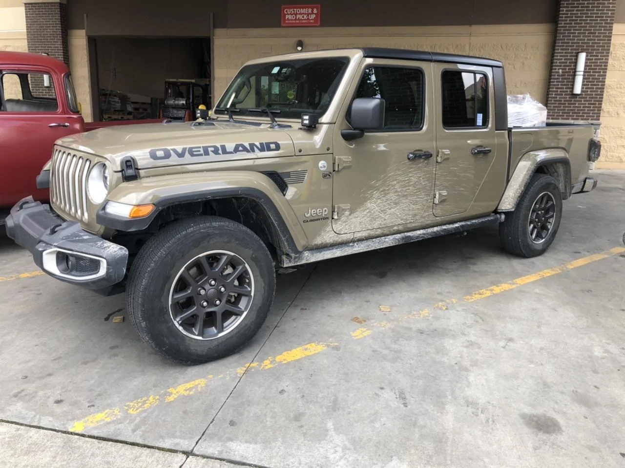

This was the last trip…
Jeep Gladiator Atv in gladiator bed 1FEB1752-D54D-40D6-8368-E94532CA4A34
And before that, tile…
Jeep Gladiator Atv in gladiator bed EF6B0691-2C4E-42DE-B1FC-7A3F672F20F0

Its fine. Just make sure your tires are at the upper end of normal and everything will be good.
The biggest issue on a long trip is tire heat build up. Tire heat buildup is caused by excessive flexing of the tire carcas each time a point in the tire is compressed as it rolls.
The solution to limit tire carcas flexing is more air pressure..
So again, don't sweat it. Anyone who thinks this is going to cause catastrophic problems has too few real problems to worry about.
p.s. The truck doesn't suddenly explode if you are 100 lbs over cargo limits and suddenly run perfectly if you are 1 lb under it. Check the tire pressure, drive sedately and you will be fine.

Also, don't forget the there are people on this forum that drive around EVERY DAY with 500 lbs of steel bumpers, winches, bed racks and compressors on their gladiators.
The will wear things out MUCH MUCH faster than a few hundred extra pounds for 2000 miles per year.
Some here reference load and tow ratings like its the word of the Lord.
Lots of factors can combine to make the practical limits either higher or lower than the rated limit.
