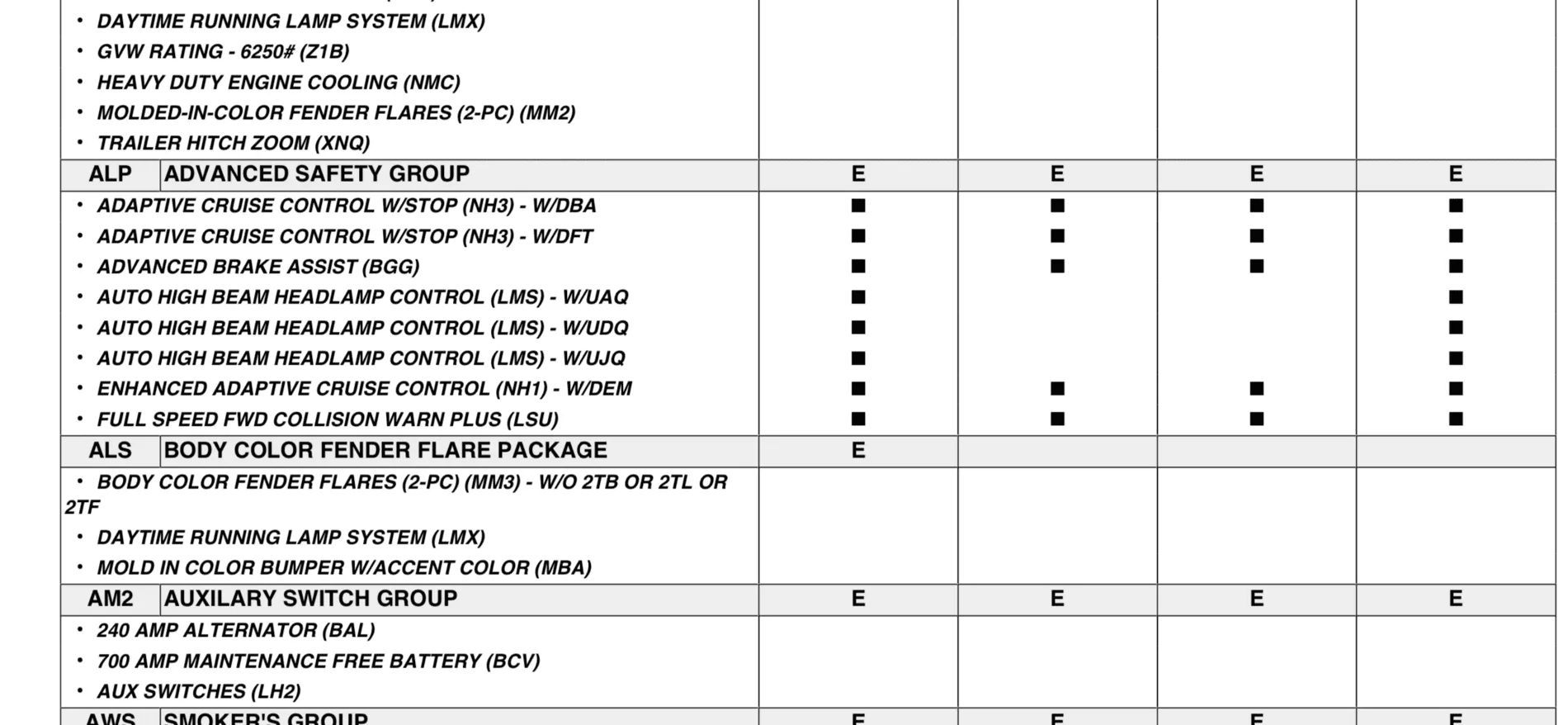

I have the rubicon Trim and I always wondered why the Gladiator didn’t have the Auto High-beam head lamp controls like the JL does. Well, I just noticed (shocking considering how many times I’ve looked at the order guide) that the Mojave and Sport S models actually DO have it. It’s just the rubicon and overland that don’t have it. Anyone know why that is? Is this a missing component or something that perhaps programming (ie Tazer) could fix?
If you have a Sport S or Mojave could you post a pic and/or tell us where the setting is to toggle it on/off (ie within driver settings on the 8.4" screen, driver information screen, or is it on the light stalk)? For reference in the latest order guide, it goes Sport S, Overland, Rubicon, Mojave.

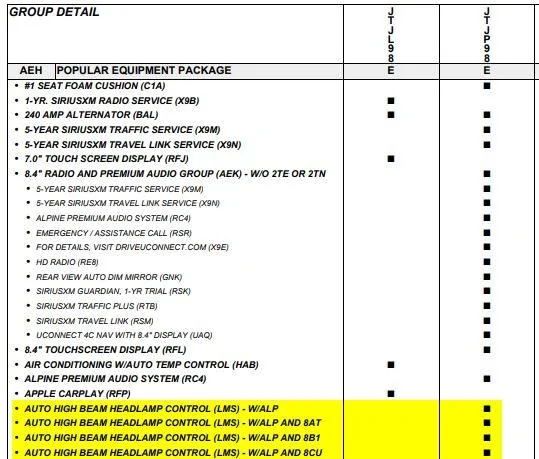

The Overland can get them with the Popular Equipment package. Seems like it's just the Rubicon that gets left out:

The plot thickens!

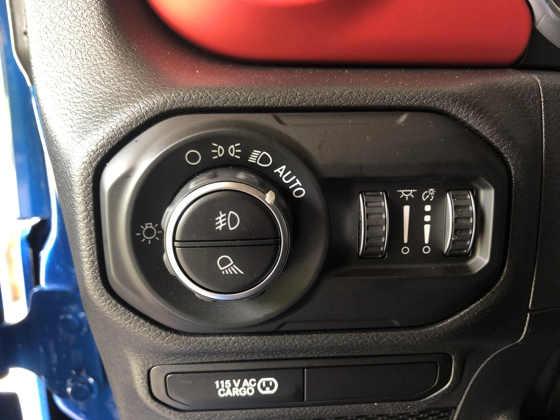

Rubicon with all options here, build sheet became available 12/18/2019. It was ordered 11/25/2019 and shipped 12/23/2019. It does have the Auto High Beam Headlamp Control. The control knob for the lights has AUTO as the farthest right position, which is where the white indicator line stays. Turning/clicking the knob to the right toggles the feature on and off. The knob returns to being lined up with AUTO after clicking it to the right.

There we have it, thanks @BSRubicon for the info.
So, if I’m understanding this correctly you turn the dial PAST the auto position (spring loaded maybe it sounds like) and it returns to auto and this is what activates the auto high beam feature. To deactivate it you would perform this feature again... is that what you’re saying?
Is there any indication on the dash that the auto high beam is active?

Mine must have just missed it. 12/19 manufacture date and the switch does not go past the auto position. Was hopeful when I read BSRubicon's post.

I have a JTR with the same Auto option on the light control nob. All it does for me is described in the manual. (see quoted text below) No automatic dimming of hight beams.
Automatic Headlights — If Equipped
The Automatic Headlight System will turn the headlights on or off according to ambient light levels. To turn the system on, rotate the headlight switch clockwise to the last detent for automatic headlight operation. When the system is on, the headlight time delay feature is also on. This means the headlights will stay on for up to 90 seconds (programmable through the Uconnect settings) after you place the ignition into the OFF position. To turn the automatic system off, move the headlight switch out of the AUTO position.
Refer to “Uconnect Settings” in “Multimedia” for further information on the headlight delay timing.
NOTE:
The engine must be running before the head- lights will come on in the automatic mode.
