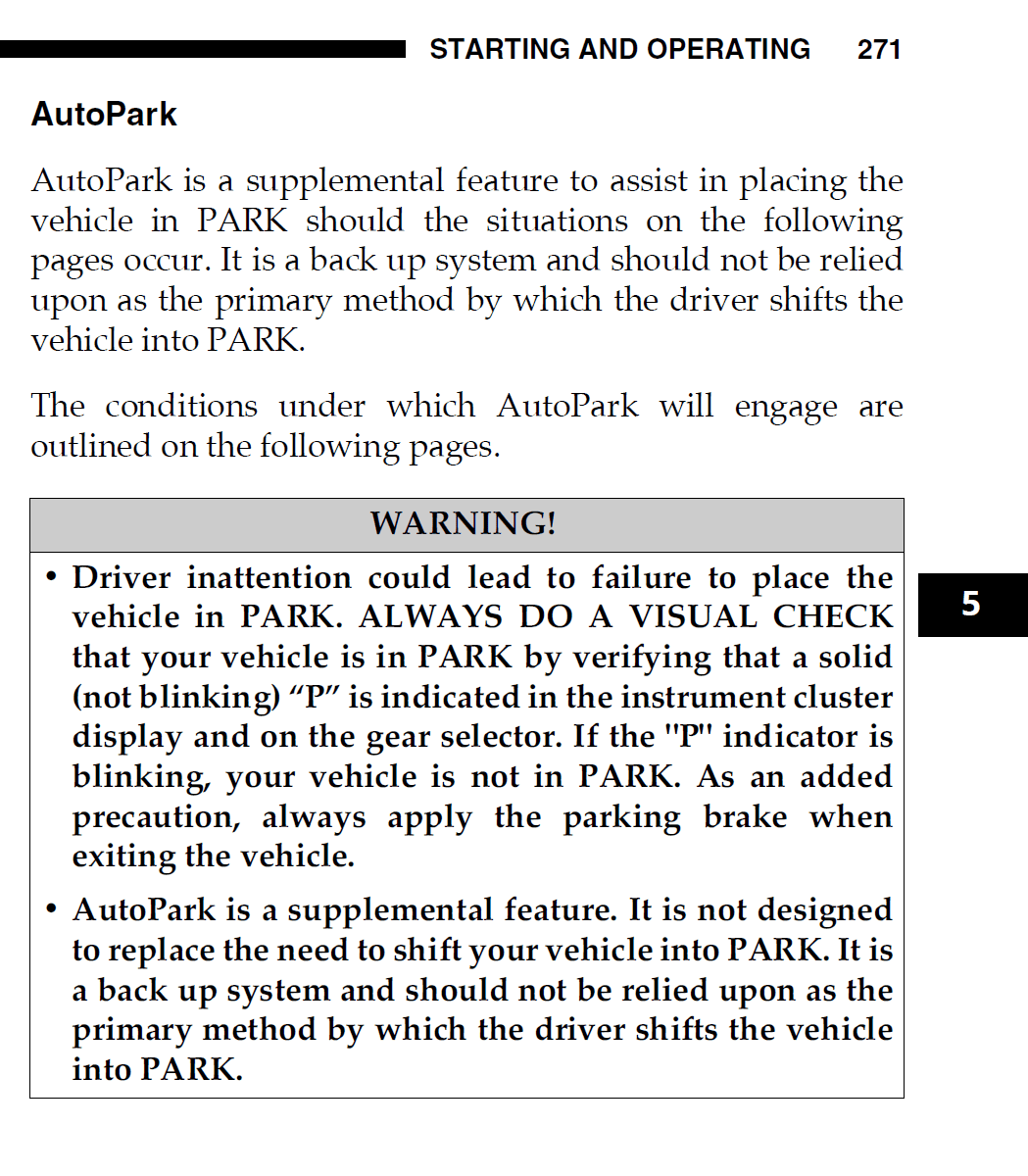

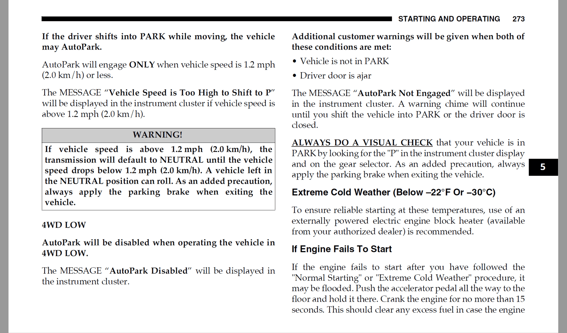

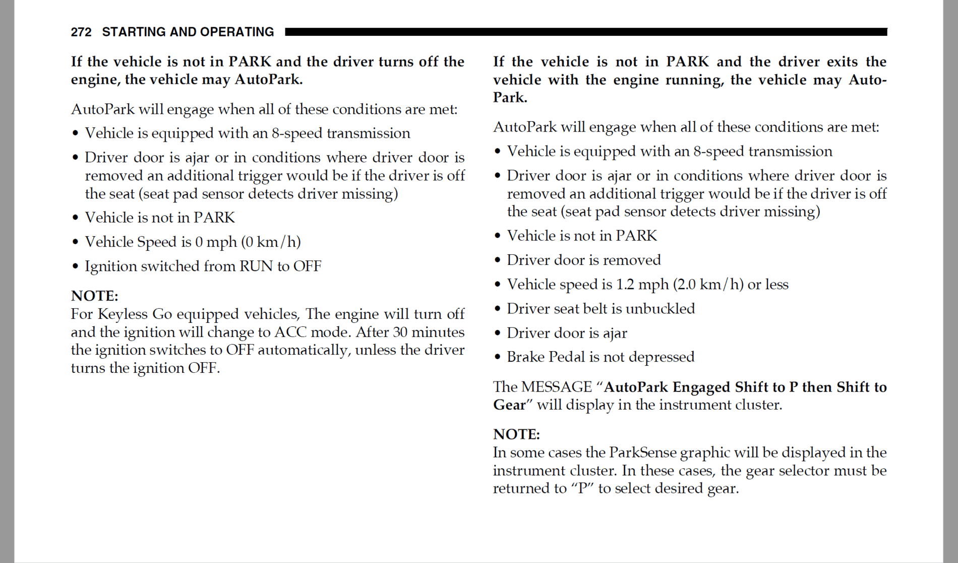

Found this in the manual (p271-273).
Some notables points:
  • AutoPark will engage ONLY when vehicle speed is 1.2 mph (2.0 km/h) or less.
  • If vehicle speed is above 1.2 mph (2.0 km/h), the transmission will default to NEUTRAL until the vehicle speed drops below 1.2 mph (2.0 km/h). A vehicle left in the NEUTRAL position can roll. As an added precaution, always apply the parking brake when exiting the vehicle.
  • 4WD Low does disable AutoPark.
  • Driver door is ajar or in conditions where driver door is removed an additional trigger would be if the driver is off
    the seat (seat pad sensor detects driver missing)

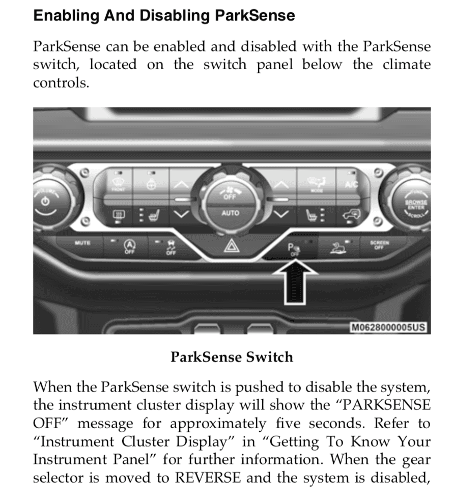

I hate this feature as well as I frequently have situations where having the door open to judge travel distances on the order of a few inches is helpful (hooking up a trailer, getting close to something on purpose). Not sure if Park Sense and AutoPark are related but According to the manual we can disable Park Sense
Unfortunately no, they are not related. I just tested disabling Park Sense to be sure and was still able to get AutoPark to do its thing.

Sigh..
180
29,415
34,988
Park sense is when you want to have the vehicle park itself - not put itself in the PARK position but put itself into a parking SPOT.
These will do like Buick, Ford and others - pull up behind a parking spot hit park sense and your turn signal and park sense will measure the spot as you drive ahead past the spot and then tell you to put it in reverse - let the wheel do its own thing.......... it will park - not P as in PRNDL but park as it move into a parking spot.
There are videos for this showing how it works.
At least that's my take on it.

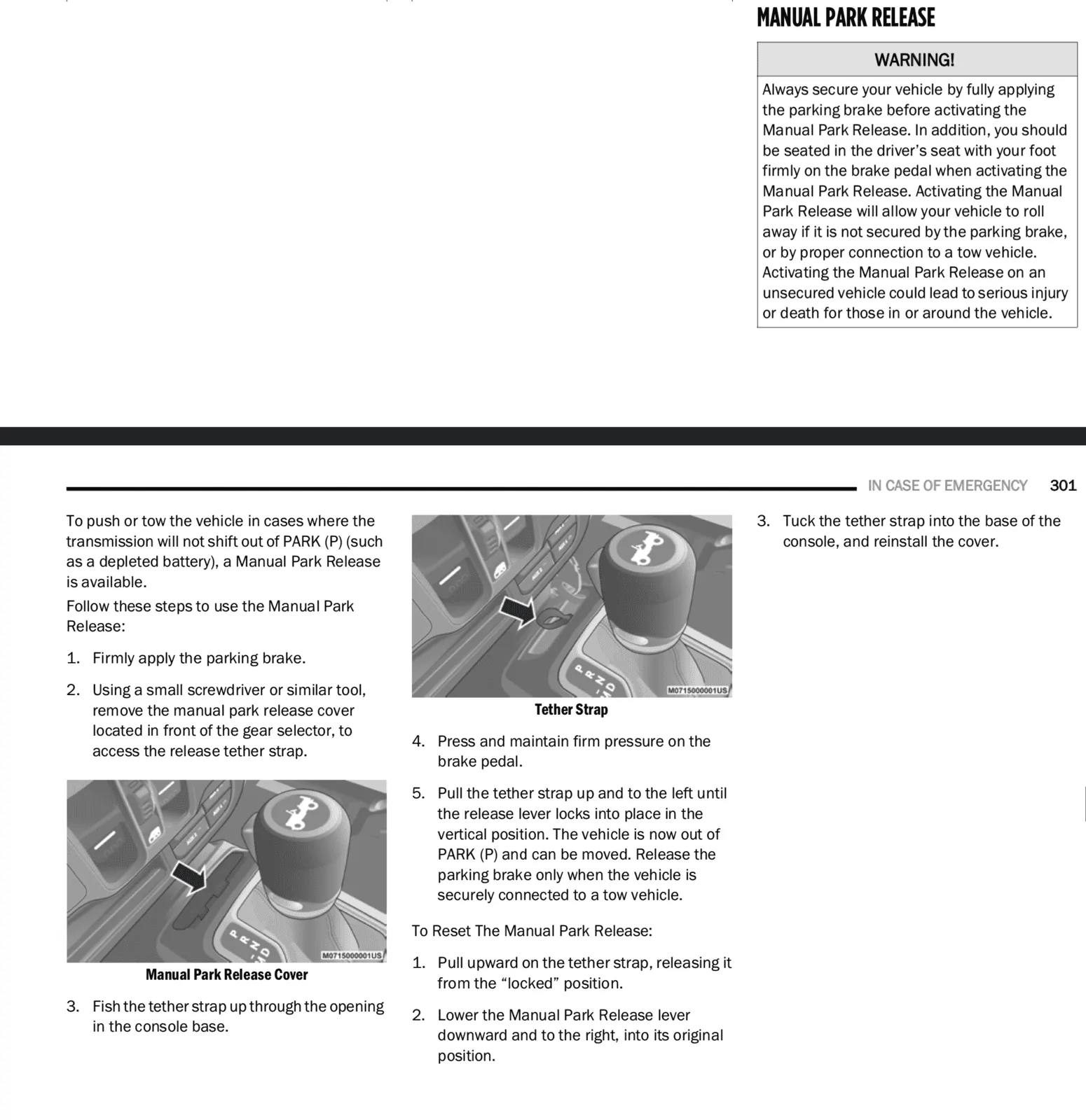

If you want to move your JT with the door open, buckle seat belt behind your back, or very lightly apply brake pressure to keep AutoPark from engaging while moving.
Also, good to know about Manual Park Release if you ever need to put the JT in neutral with engine on/off.
