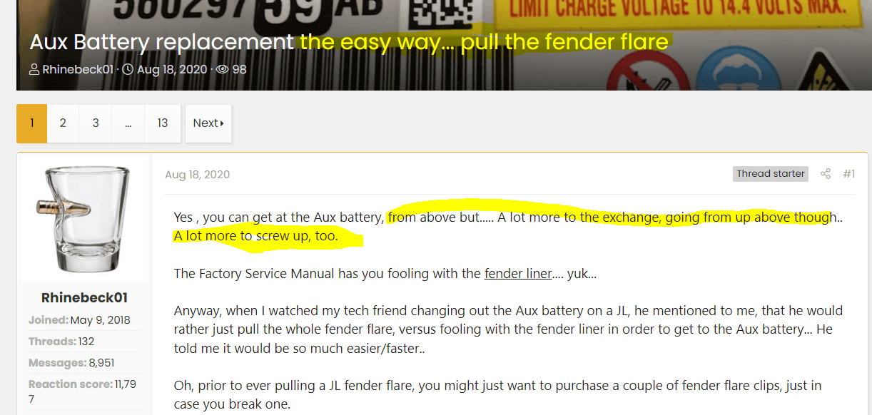

The fuse box does not need to be removed to replace the ESS battery. It can be reached by taking off the fender liner.
The Genesis kit replaces the main and ESS batteries with a pair of smaller Group 25 batteries. That's how they get it to fit in that space.
178
29,091
34,573
That's how "the book" says - and how dealers who diagnose and replace get paid to do it, through the fender liner area.
I'd rather not mess with the PDC and fuse panel connections anyway. I'd go through the fender, personally, and there are videos showing how it's done.

Yep, removing the fender inners is pretty simple and is the logical way to get it done. It's not a hard task to take on and something's that worth attempting yourself if your out of warranty. Dealership is about $400 to $500 for labor.

Yeah. Removing the fender liner is way easier than simply opening the hood and loosening two clamps 😂

Do whatever you damned well please, even mock those who find it easier going through the side, whatever you feel.............. fact is, many Jeep people feel through the side is easier, and it's been shown in the forums here that it's very possible to screw up electrical connections via the top down method.
2 clamps and all of those electrical connections on trucks that have enough electrical gremlins built-in from the factory.
You do what you want, the rest of us will avoid electrical trouble and go the tried and true ways.
