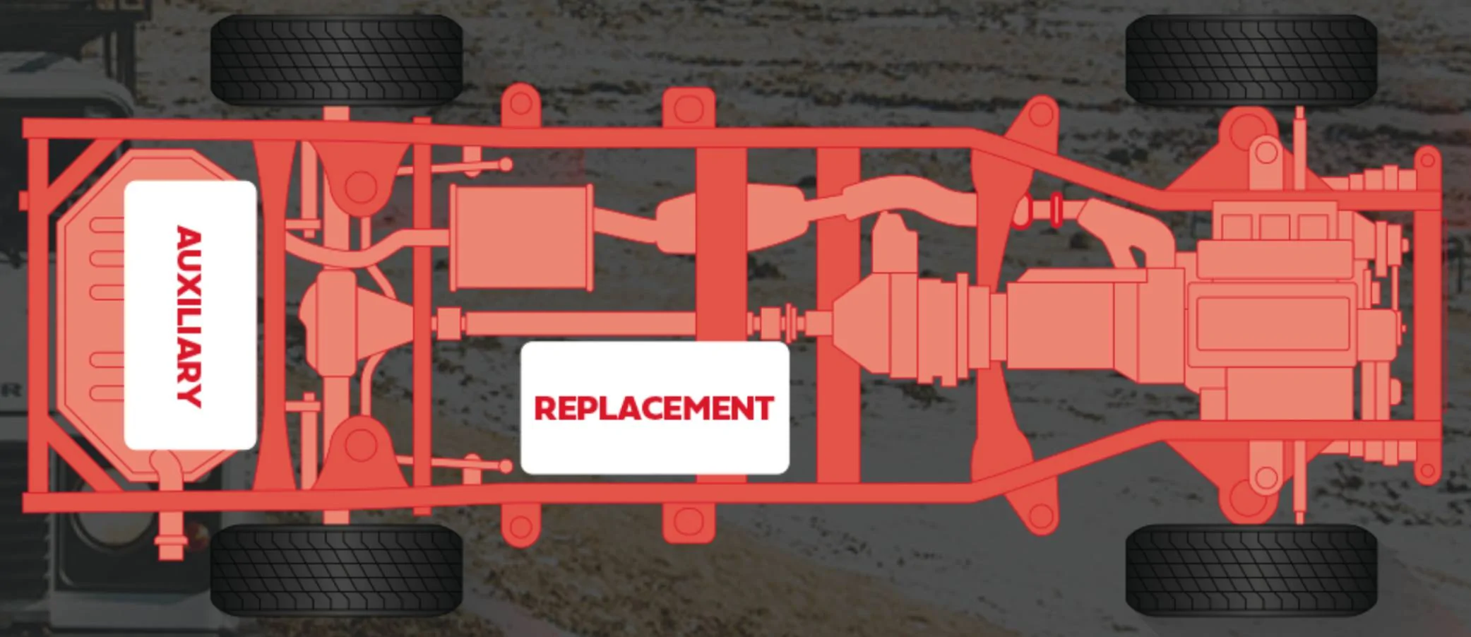

Hello and sorry for asking a stupid question! but why someone as came with a long range aux tank for diesel?
is because the jeep diesel is not available in Australia!

Long Range America was working on doing one for the diesel, but I'm not sure what happened with it

I just talk to long range america (LRA) , and they tell me "that they will not make one. there is no space under-neath the jeep, Unfortunately" I event ask to see if they going to make small version , and they tell me "NO".
I think it is up to AEV to came up with one. but on my conversation it seem that is really no space for one. so it have to be were it is the space tire. and relocate the space tire. but I ask some one that work for AEV and it tell " that there is noting that they are working on".
It seem that RMA for the it. is to much vs the profit of the product.
I think I have two solution.
1. Relocation of space tire: and look for an independent metal works, to make a tank, then look for a pump and etc.
2. delete the DPF/LGR/DEF and use that tank. other set of problem.
I really don't want a solution on bed of the pickup.
any other ideal you guys may have!
thank you .
