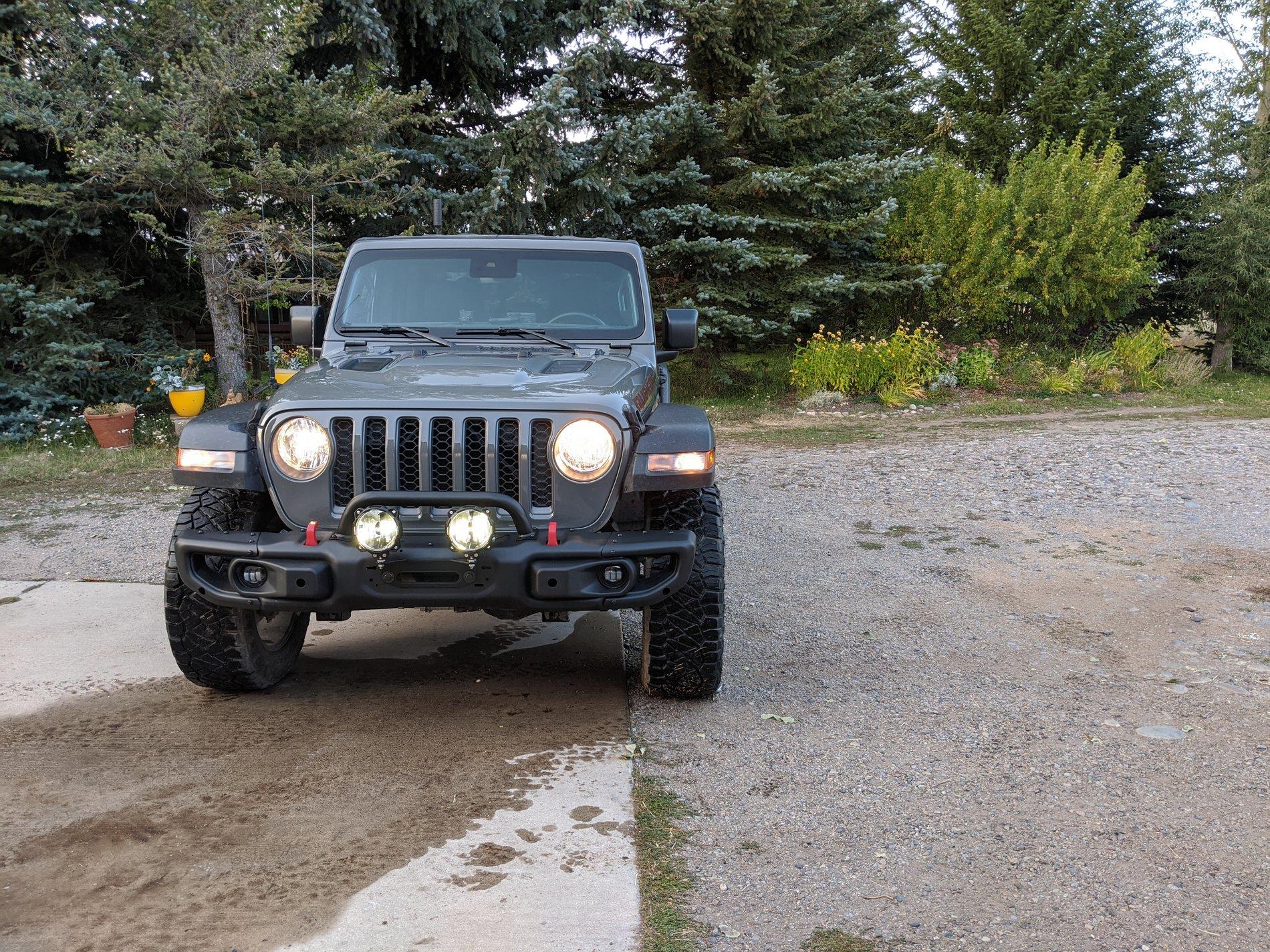

So that's exactly what I ended up doing. I settled on a pair of KC Pro 6 lights, and mounted them in front of the winch opening. It's their "driving" beam.
Jeep Gladiator Auxiliary Driving Lights IMG_20200914_185756
The lights are on a relay, so I need the AUX1 and high beams active for them to come on. I've only been out after dark once since the install earlier this week, but they really work well. I have the Pro 6 lights to compliment the high beams and LED fog lights as needed to compliment the low beams.

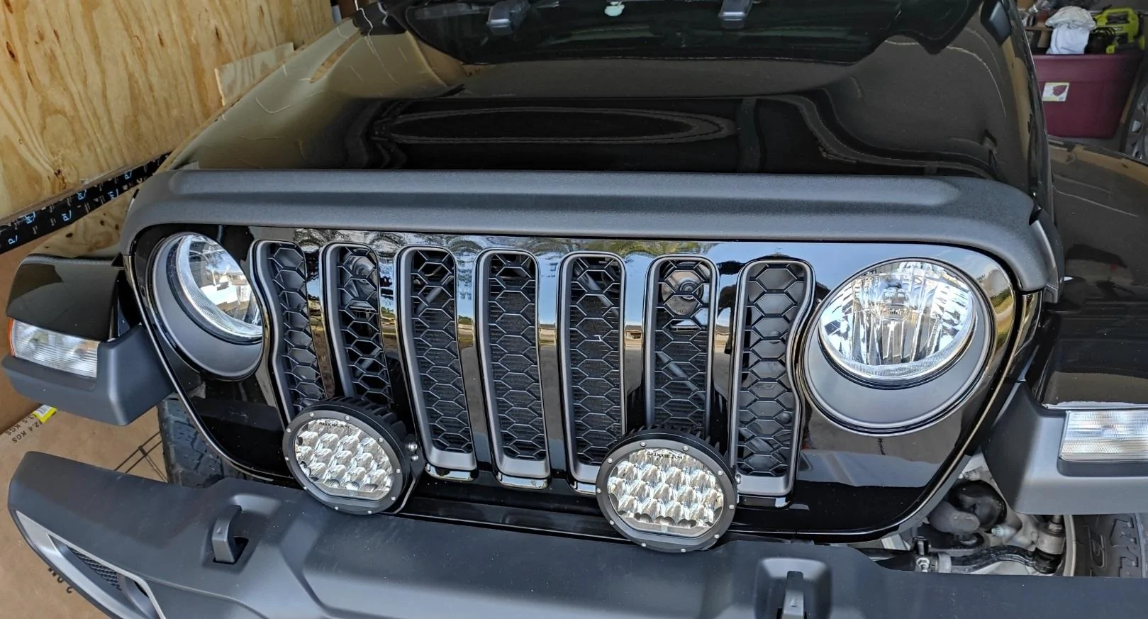

I replaced the halogens w/LED and added Auxbeams. I have the plastic wonder bumper, so a piece of unistrut was added for a solid mount.

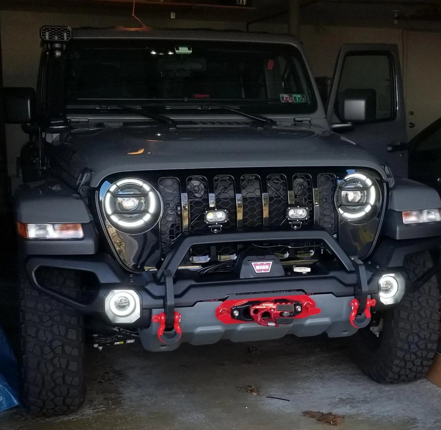

Halogens with leds look horrible. Just swap out the headlights. Im waiting for my drl led switchbacks to arrive, they look so bad at night next to the other leds.
