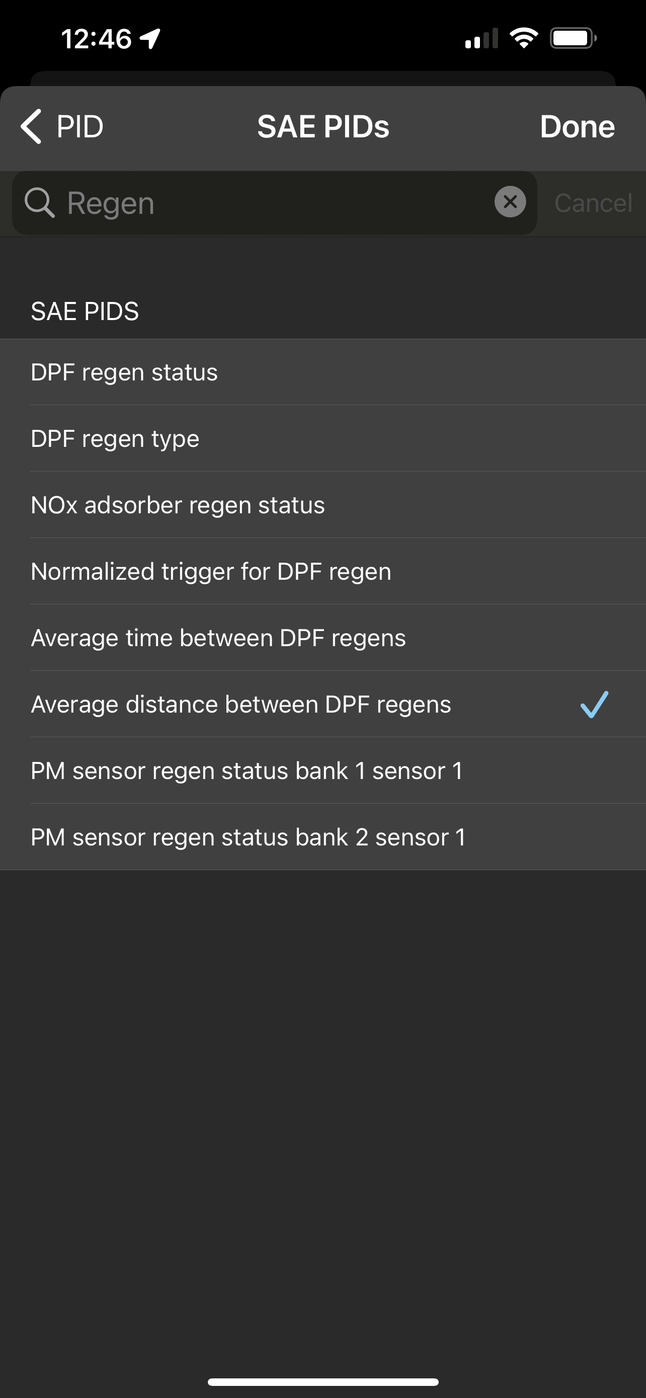

Just hooked up my MX+
I’m right about 500 miles between passive regens.
What are ya’ll?

Not sure about banks.
I’ve just started playing with the Mx+
Seems this MX device can see everything, seriously, everything!
