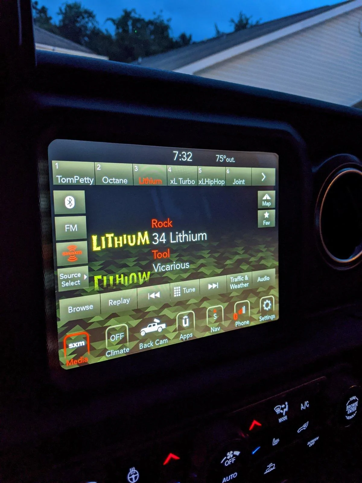

UPDATE. The latest recall fixes the camera brightness. It does not scale with the dial but it does drop down the brightness a noticeable amount when you do not have the gauge cluster set to the highest amount.
They did not have the update visible when they hooked it up to their ipad but when they entered the vin via their computer they were able to see one was available.
It took about 1.5 hours to push the update and works great now.
Also, the icon has changed.
