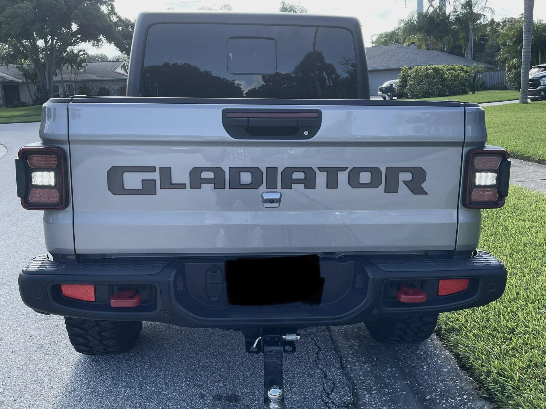

Anyone else having an issue with one or both back up lights flashing / staying on after unlocking the jeep since this last tazer mini update? It’s mostly the left side 9 out of 10 times but it will stay on regardless if I’m driving or not. The only way to get them to turn off is to lock the truck with the fob. It’s inconsistent but it’s happened dozens of times people are flagging me down telling me I have a light out because ones lit and one isn’t.
They were both on in this pic. They were on for the entire drive home. They only way to get them to turn off is to lock the truck and unlock it with the fob.

I had this and it’s a bad pairing. Do a full reset twice. Make sure your on the latest firmware.

It is a feature you can do on your key fob also. I contacted them about the same issue when I had it about a month ago. I ended up resetting 3 times and I have been good to go now.

Make sure you're on the most current firmware, too. They just released another version recently and I haven't had the back up light issue since.

Pro tip if you are by yourself. Just setup your phone to record and see if your lights are still on :) .mine seemed fine on one reset and then in drive the left one only came on lol.

FW 11.3.2, released 10/29.
