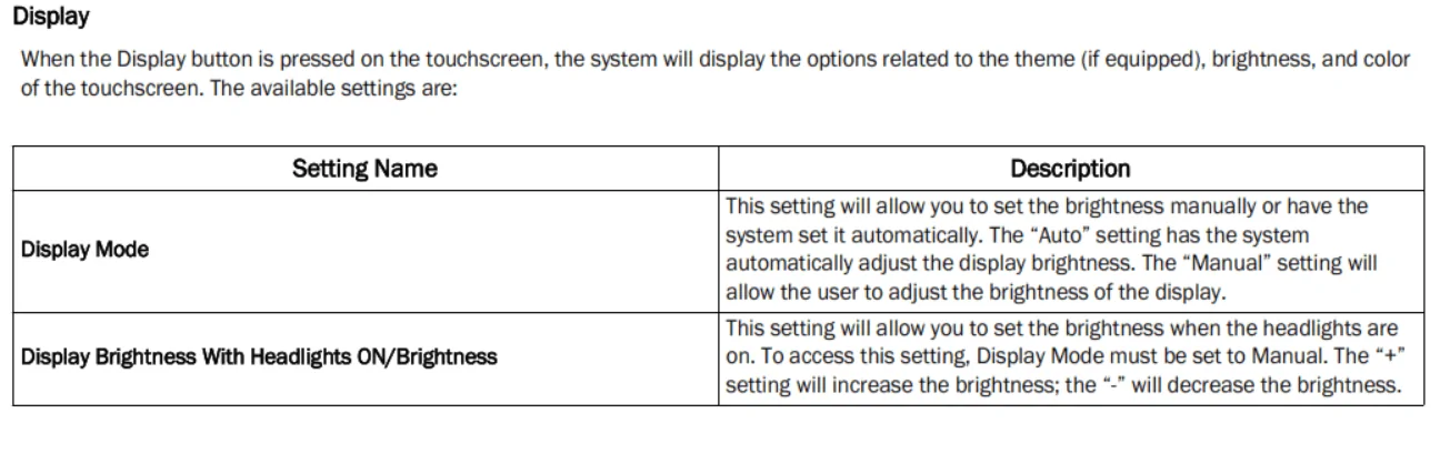

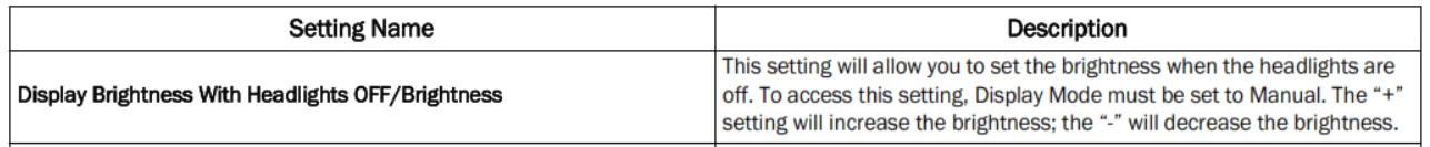

But how does that impact screen visibility during daylight use? DO you have to keep adjusting brightness between daytime and nighttime?
No, you can adjust the two brightness levels independently. From the manual:
Jeep Gladiator Backup Camera - Plate lights and screen brightness severely impair outside visibility 1639401952527
Jeep Gladiator Backup Camera - Plate lights and screen brightness severely impair outside visibility 1639401997304

Thanks! I will try that and see how it works out.
who would’ve known RTFM…..
