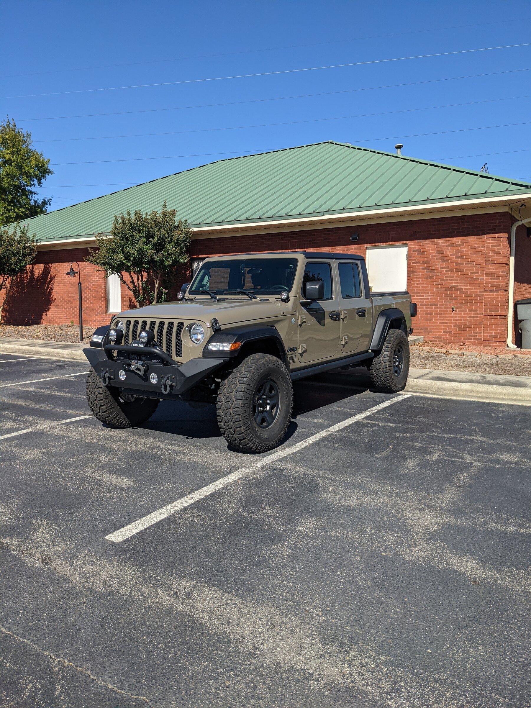

4.10 gears and you will be back to where you were at. I got 4.10 gears on my Sport Max Tow Nd I get 18.5-19 average and a little over 20 on longer trips and that's on 35's riding as seen in the picture
Jeep Gladiator Bad Mileage with 33" Tires PXL_20201219_123525410
What lift is on this magnificent gladiator? I have a Sport S with Max tow and I'm about to put on a set of Mojave wheels with 33's/Falken wildpeak, what kind of difference can I expect? I'm hoping 1 or 2 mpg.
Jeeperjamie
Jamie
Feb 12, 2020
131
4,650
5,211
Kannapolis nc
2020 jeep gladiator
Weyerhaeuser
That's probably about right on the Mpgs. As far as the lift, mine has a 2.5" Readylift SSt lift
Jeep Gladiator Bad Mileage with 33" Tires PXL_20211017_152546716
kit and Rubicon Front springs. I'm running 37's now, it looks like this now.
