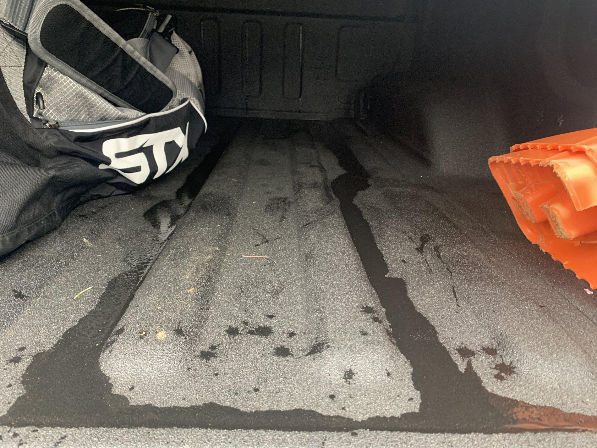

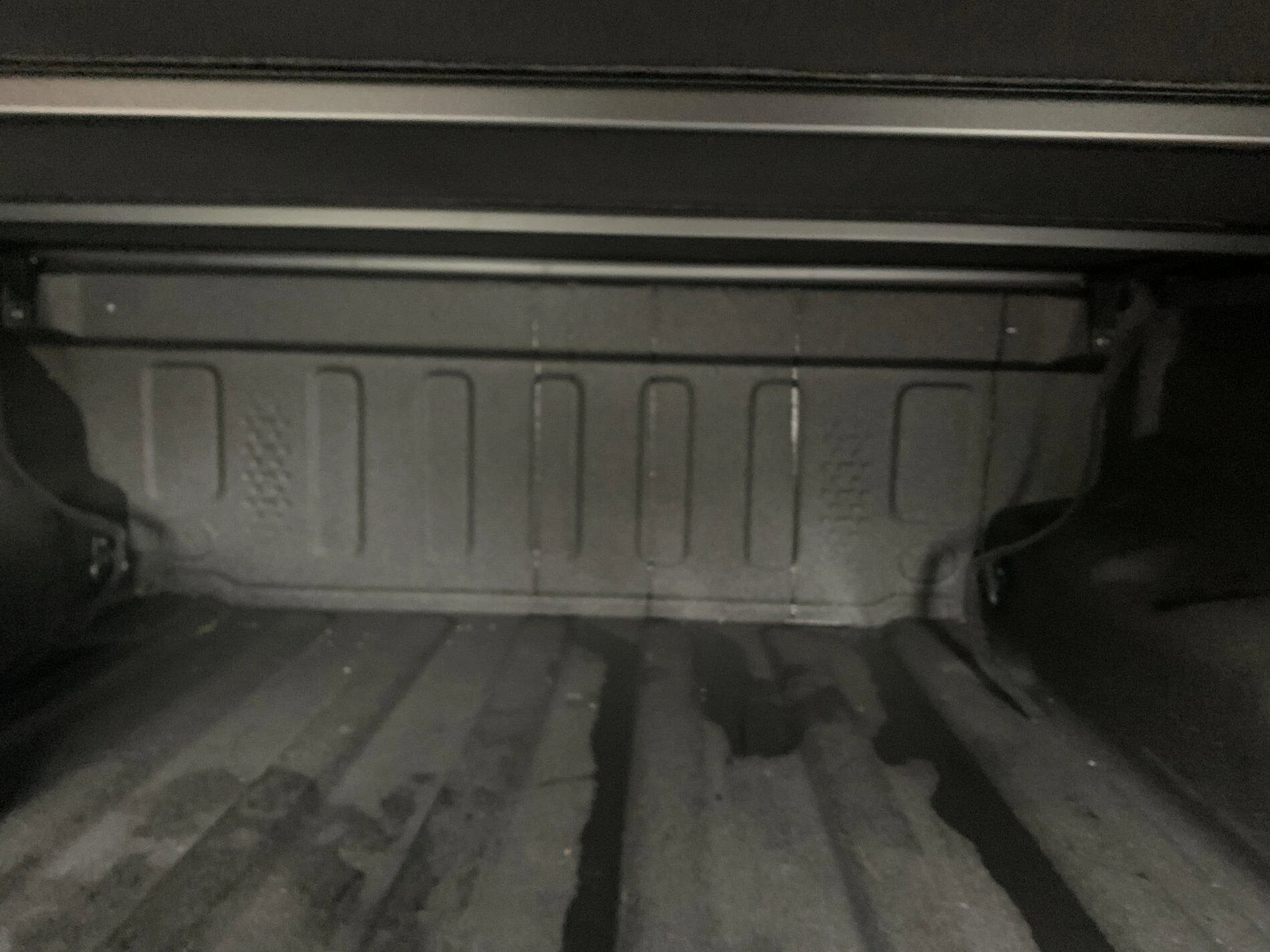

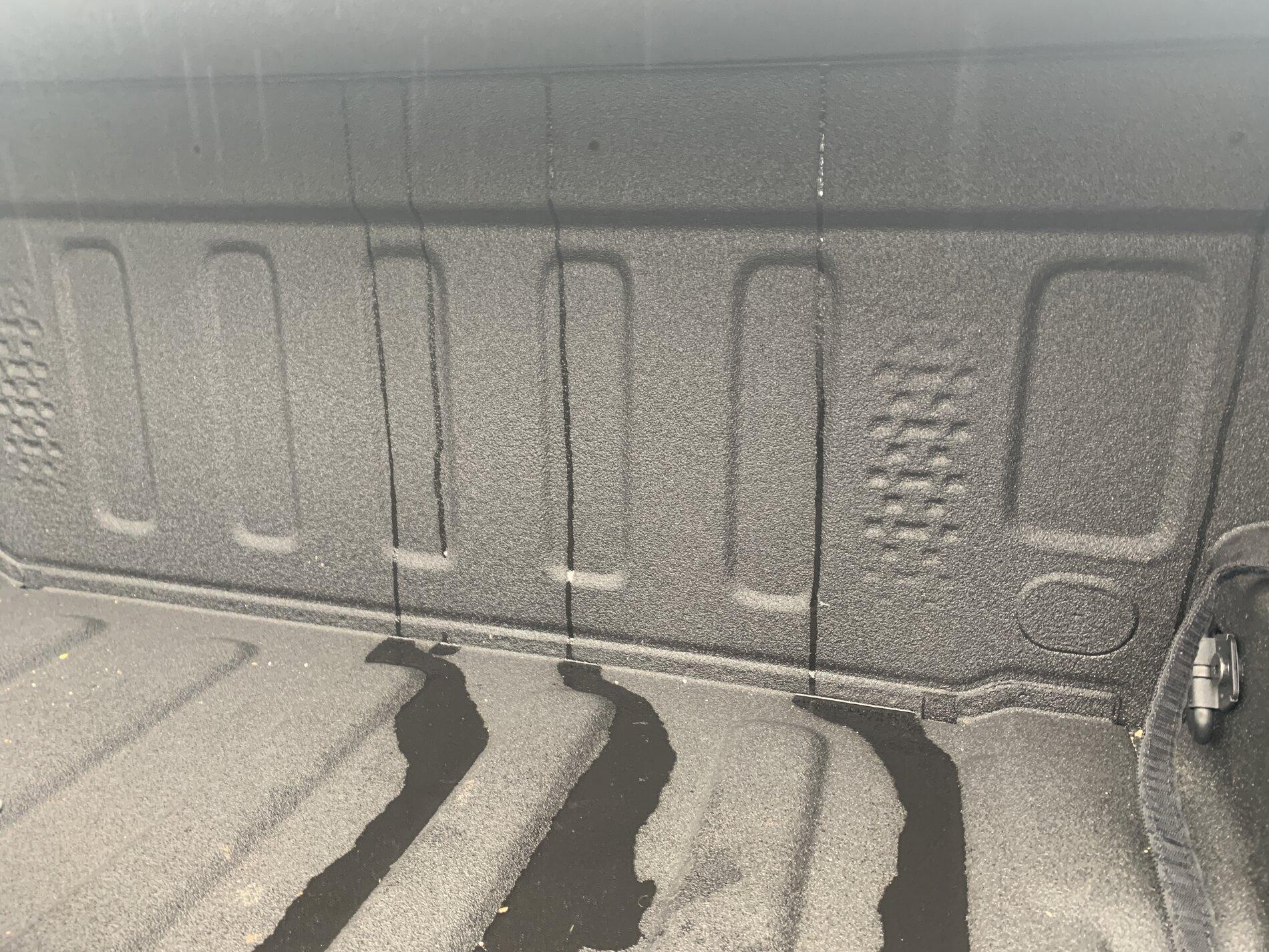

@JeepCares my dealer is claiming this is “normal”. What’s the point if it doesn’t keep water out of the bed. It leaks across the back of the bed near the cab. The seal seems faulty. Care to help?
I have a video as well but it’s too large to upload.

mine only leaks near tailgate gap and because sides not being tight allowing it to flap on sides. Leak is minimal for me added camper shell tape near gaps in tail gate. For the OP I would check seal near the cab. If it can’t be adjusted up front add tape to gaps. Close the cover crawl in and se where the gap is, add camper shell tape there.

before doing that in bolt the front near the cab. Check the seal how it lays, and for pinching, or it not laying properly. While it’s off apply a protective dressing to it like 303 protectant. The bolt back up paying attention to seal.

had it off several times and checked the seal. Actually found out the seal is installed backwards which is probably the main issue. Also, the brackets may not be sitting correctly causing the seal to not sit tightly on the bed rail.
they ordered me a new one so I’ll make the trip. Hopefully its fixed with a new cover.
