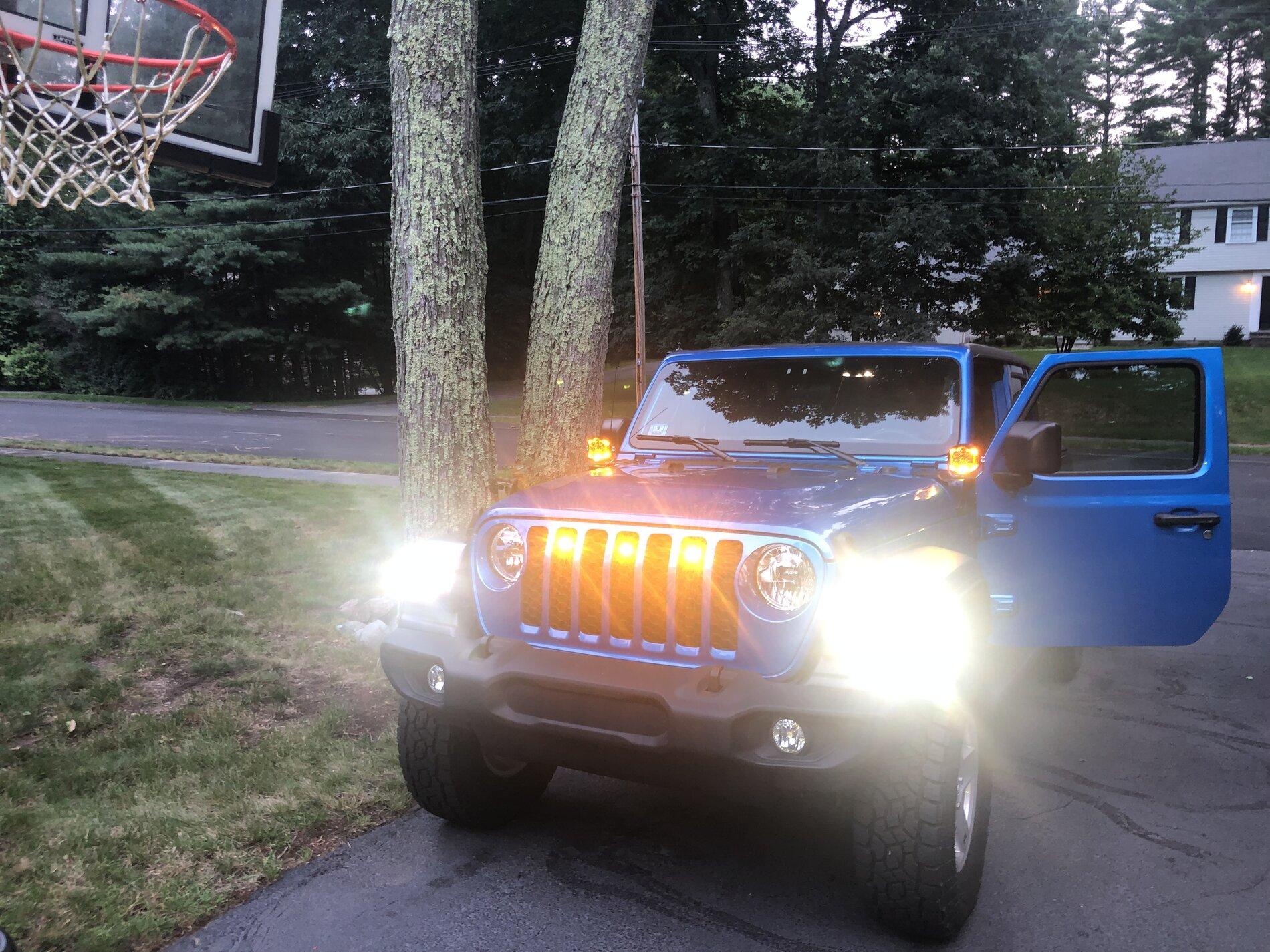

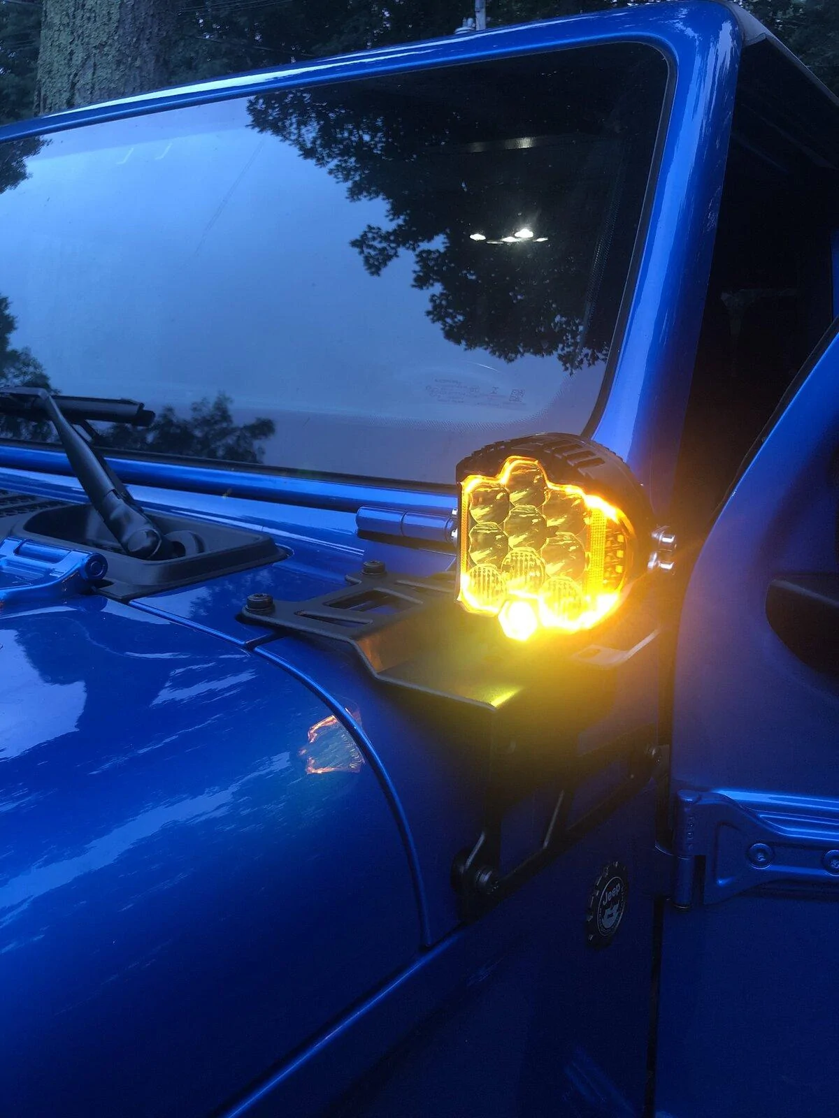

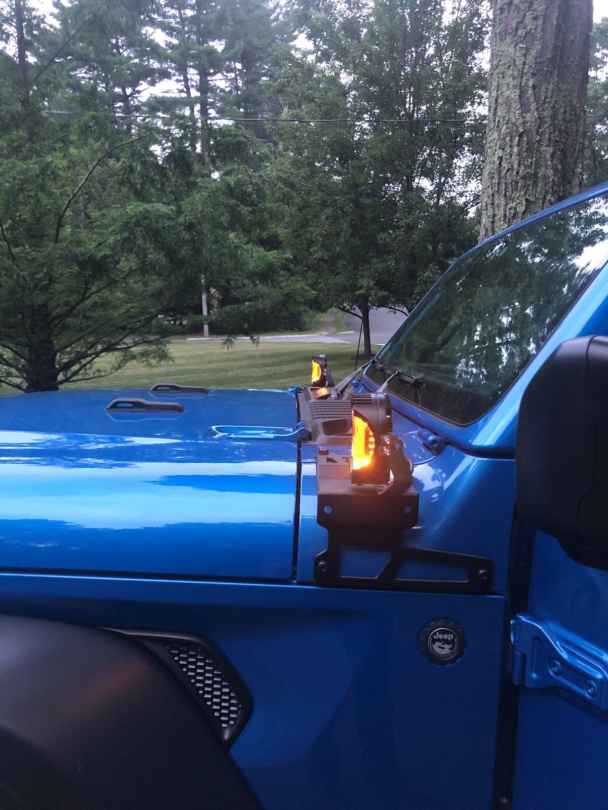

I just installed some lights very similar to the LP6, I wired the running lights to aux4 and the main lights to aux3. They work great, I also have raptor lights on the same aux4 switch.

I found them on eBay, if you search 5inch 50w led there are many sellers selling them in white and amber. I paid $85 for two and they were delivered two days after I ordered them. The light from the spot light portion is incredibly bright and far reaching. I only use them occasionally when I am on fire roads in Maine.
