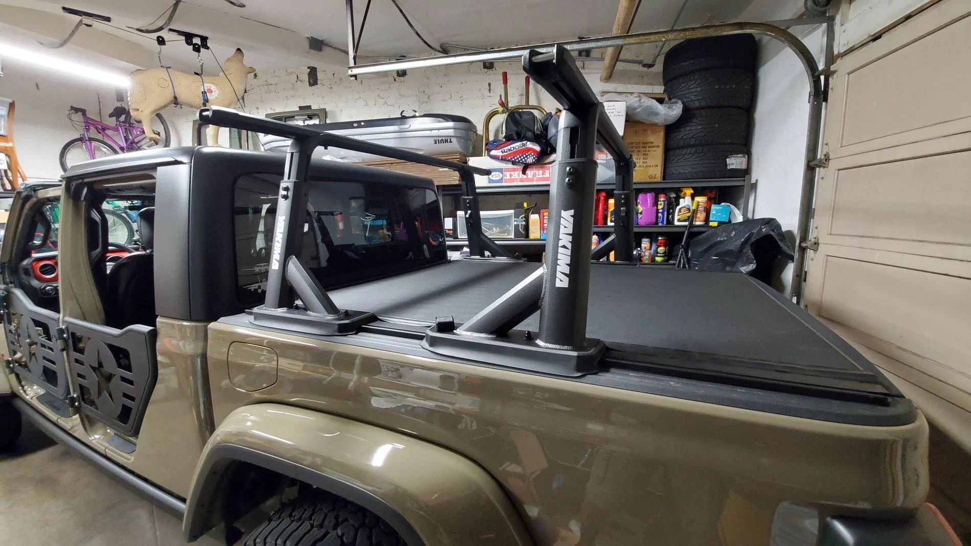

Here is mines installed with a Max Modular 18in rack.

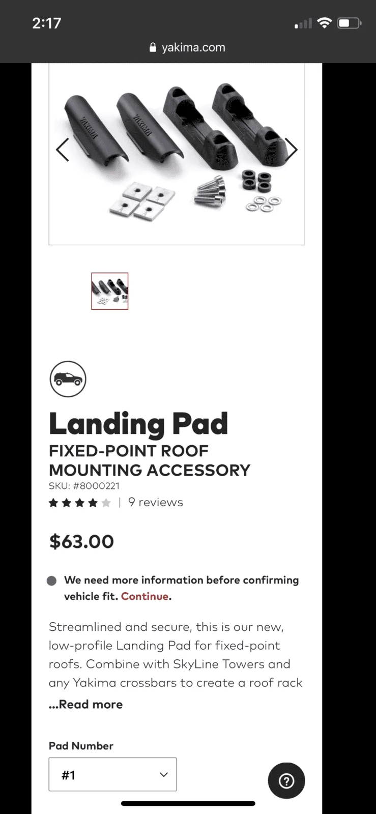

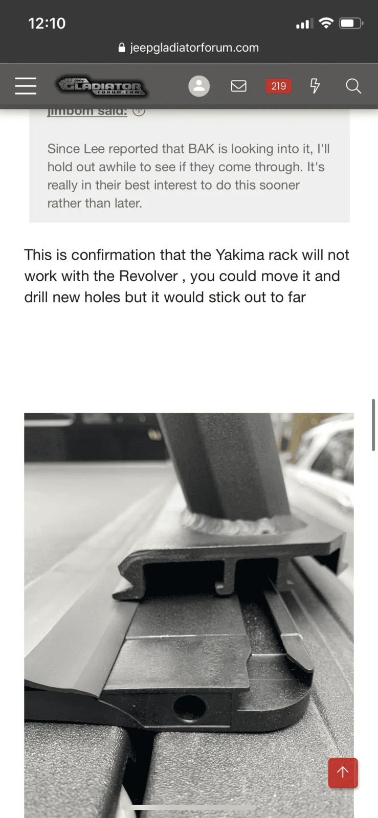

Pictures of side rails. etrailer.com shows some Truck Hero and Thule TracRac that are expensive/ugly.
upon further research (and head start from @clweed) I was looking at t-slot and Yakima racks.
Jeep Gladiator BAK x4 Revolver rolling tonneau Install and review F4C7D5F7-33F0-464C-AEC5-D4B3DE96CA6E
the Yakima skyline mount and Landing Pad #1 fits per his pictures..
Sounds like by measurements landing pad #4 fit. (T-slot nuts for #1 are 7/8 x 11/16”; #4 is 1-1/2 x 13/16”). I haven’t measured the rail with calipers but my rough pictures look like #4 would fit; may be too tight.
Jeep Gladiator BAK x4 Revolver rolling tonneau Install and review A878C2D8-CEDD-4BD2-9547-36E3D4E341CA

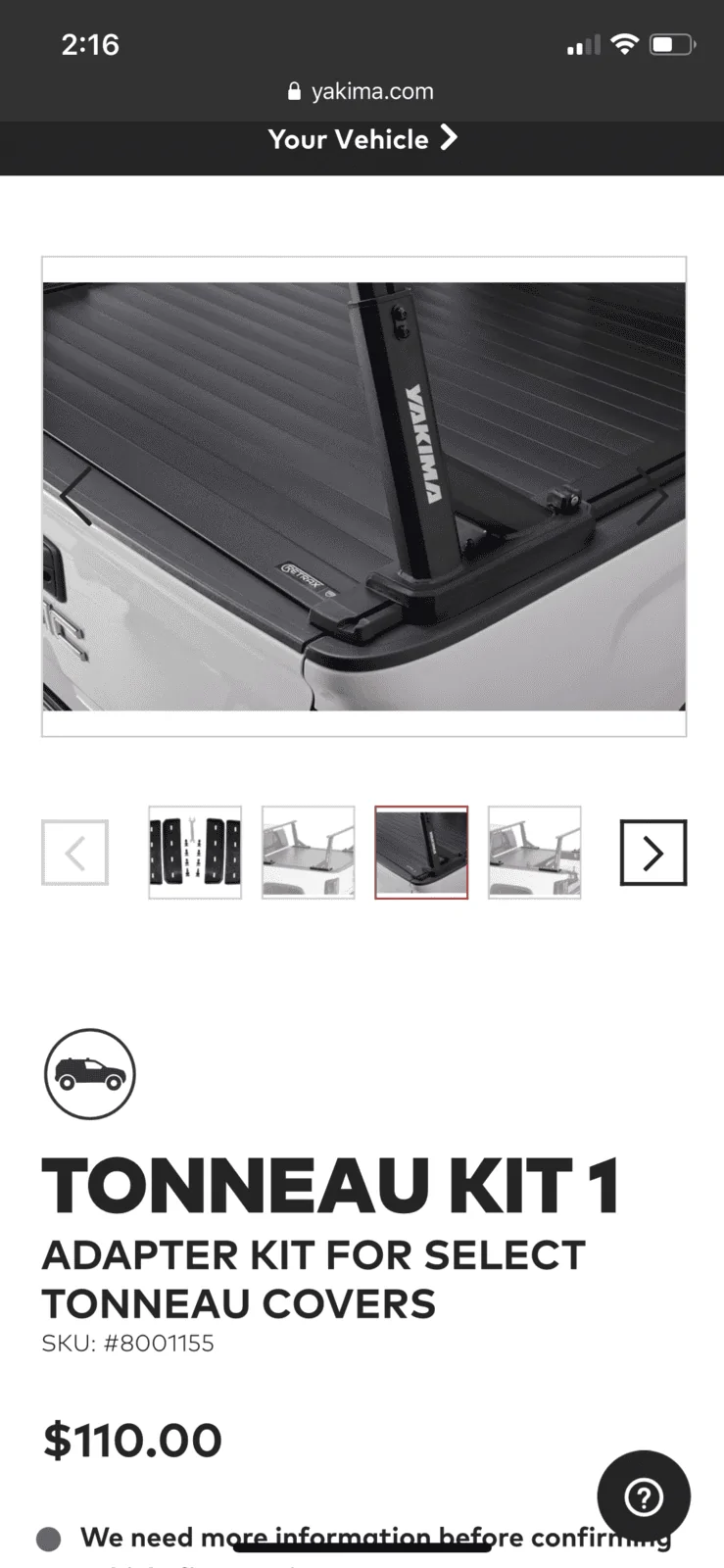

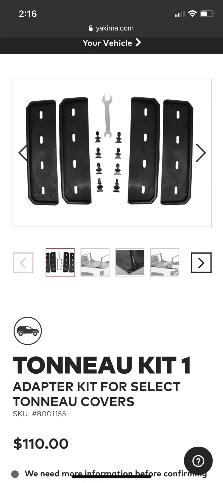

the adjustable Yakima Overhaul HD doesn’t fit the rail because of the lips underneath; however, they sell rubber base pads as Tonneau Kit 1 that look like they would work.
Jeep Gladiator BAK x4 Revolver rolling tonneau Install and review E6FD8F75-C41B-470D-8A59-1061D30E9E85

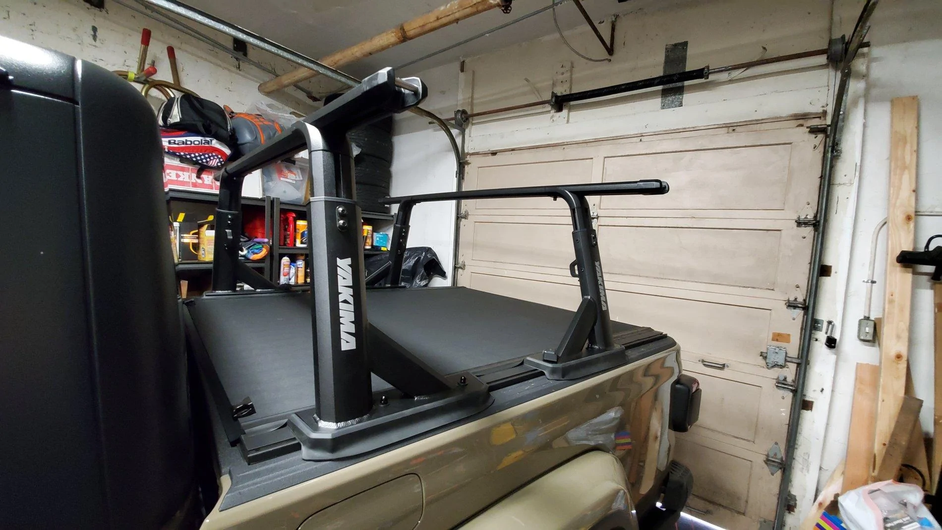

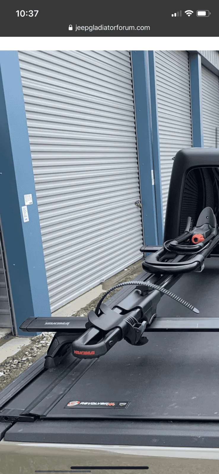

I got it to work for me.
Bak Revolver X4 with Yakima Overhaul HD with added tonneau kit.
Slides into T-slot channel.
Couple of issues you will have is rolling the cover up to the front of the cab you have to force it past the tower at the cab. (It will go past just not smoothly)
Second issue is the rubber seal on the Bak Revolver will be slightly raised resting on the towers. Nothing I was concerned about and used the system for about 3 weeks when I decided to change to a Overland build.
Jeep Gladiator BAK x4 Revolver rolling tonneau Install and review 20200618_140420

With the tonneau pads (tonneau kit 1) the T-bolts are the only thing that goes in the rail?
since the lips on the bottom of the Overhaul don't fit over the BAK rail, and you have to use the pad under it, that means the Overhaul is just sitting on top of the rubber pad, not in the channel as it should be on other trucks, and the only thing holding it all down to the are those couple bolts?
Jeep Gladiator BAK x4 Revolver rolling tonneau Install and review 1596043203783
Am I making sense?
Just wondering if it seems sturdy...

Yes the T-bolts are the only thing that goes into the Bak rails. The legs go onto the tonneau rubber pads and the extra rubber/plastic hanging over (to me) give it a little more stability. The system is made strong when bolted together with the cross bars.
The only reason I decided to switch set ups is because when using the tonneau kit you drop down from 500lbs on road rated to 300lbs on road. And I decided I wanted to install a 3 person rack top tent.
The nice thing about the Yakima setup is it takes 5 mins to take both towers out and your back to your full bed. (Once set up of course)
