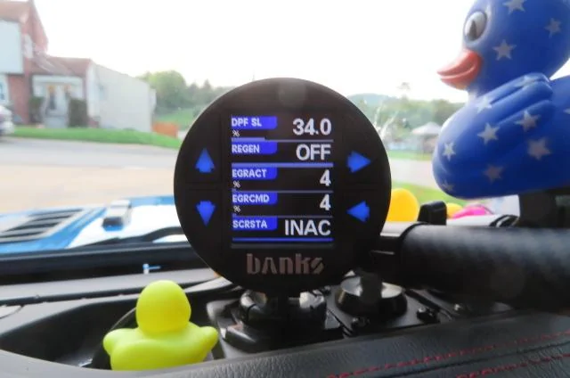

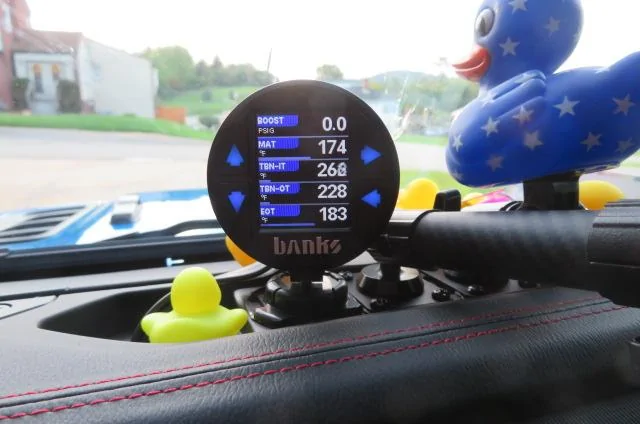

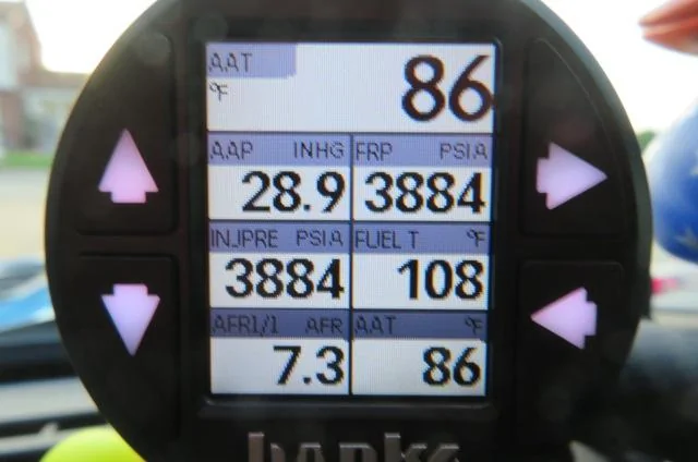

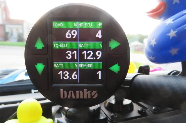

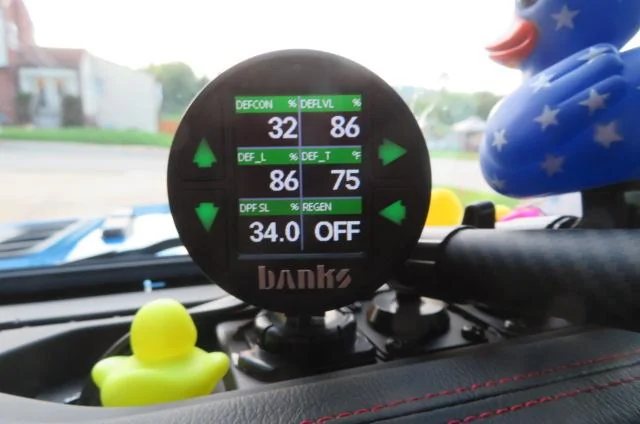

Got my Idash gauge and Pedal Monster installed. Tried installing the Derringer. Gave up for the time being. The brown plug on the sensor on the fuel rail is position facing down. Can't get to it to release the locking tab on it. I'll try another day. I have the Pedal Monster set to "SPORT 1". This really helped out with the response of the loud pedal.
Here's the pictures of my different screen faces.

You can use a long skinny screwdriver to get the connector off. Push down and slide it off.
6,392
14,577
Wish I could. The clip is facing down. I'm going to try again later this week.
