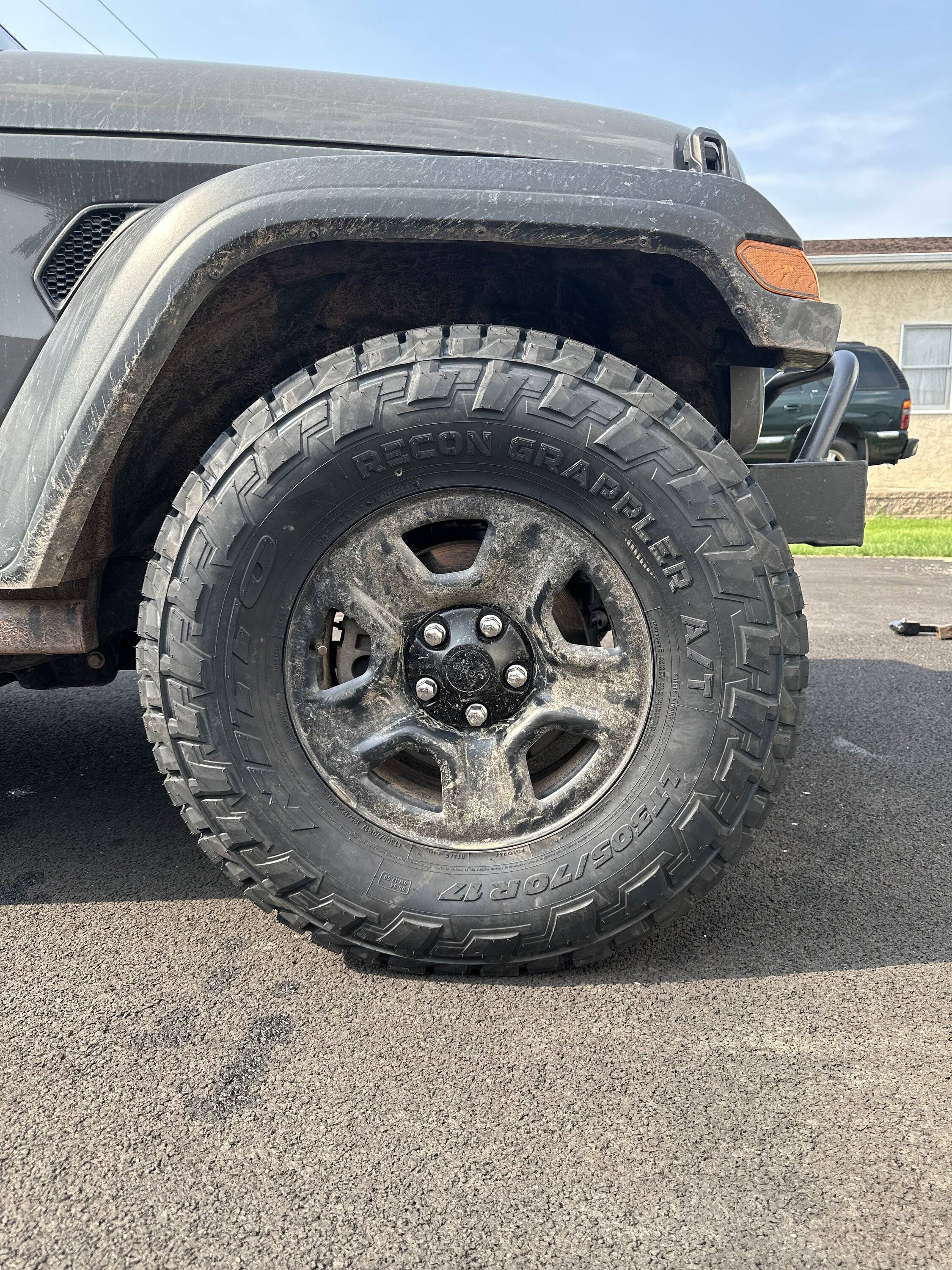

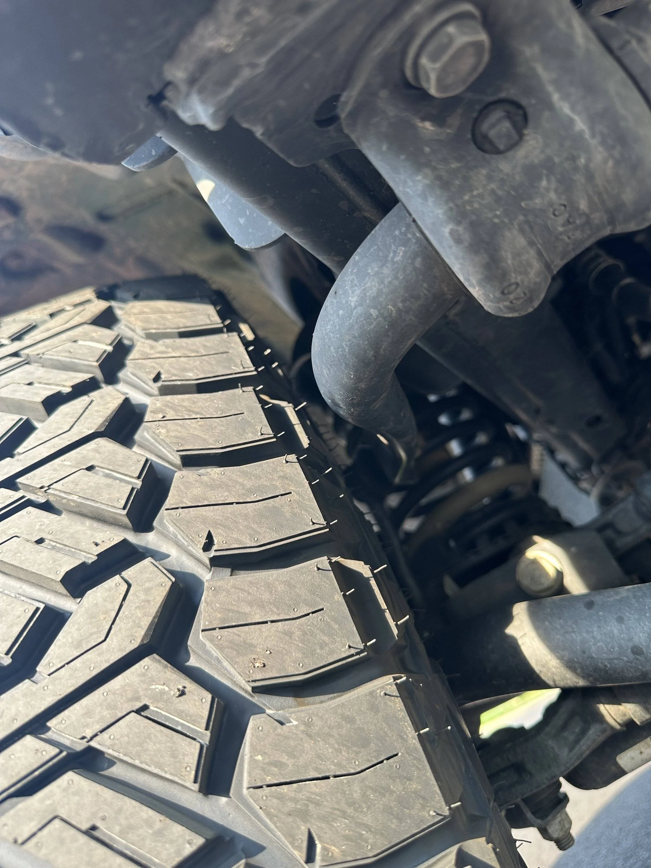

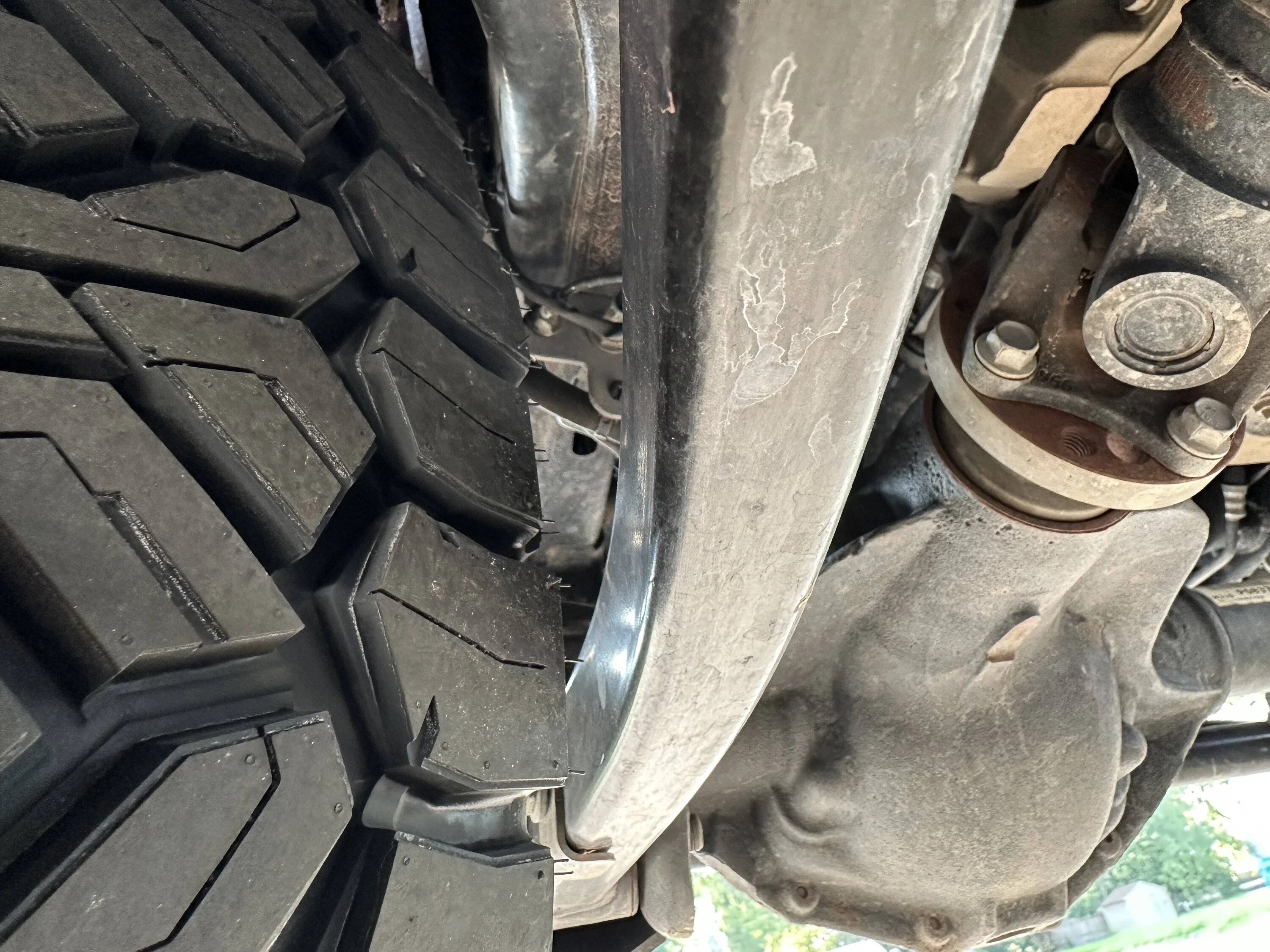

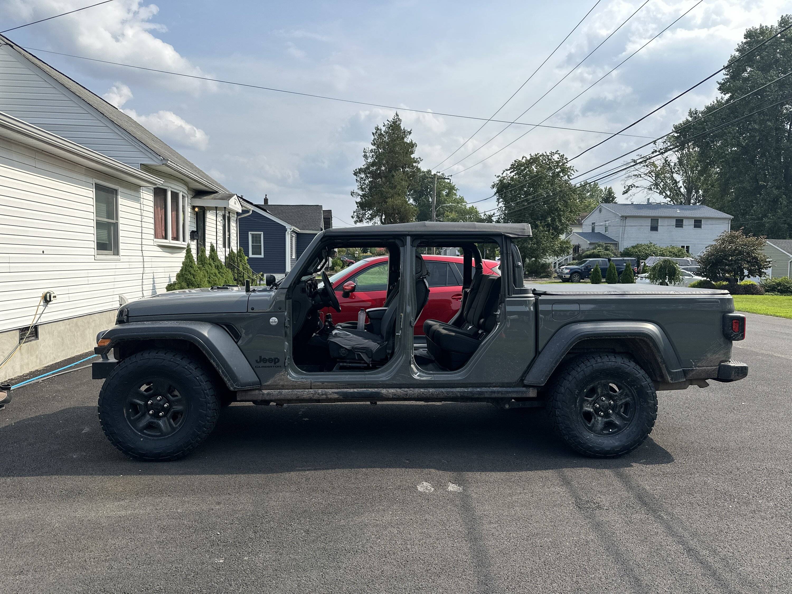

Here’s my 2021 gladiator sport, no lift, standard width axles, steel wheels, on 305/70r17. No rubbing lock to lock at ride height.
Everytime I tried to find someone with an actual base model set up with big tires I could never find it. Well here it is, this is as big as you could feasibly go without rubbing. Converted its 33.86” tall, 12.23” wide.
