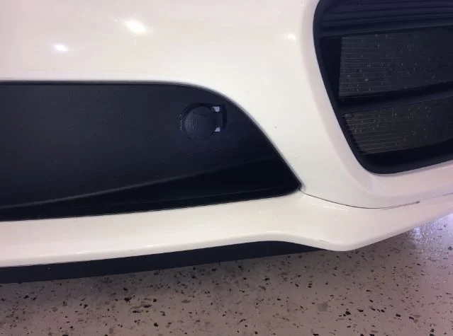

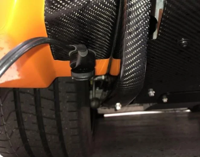

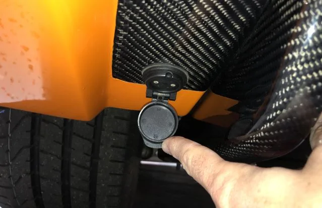

I was an early adopter/tester for a small niche market company. The company (HethelSport) put together a kit for them (although I see that they are currently back ordered there) :
https://hethelsport.com/tools/charger-connection-kit/
That's actually one of my cars with it mounted in the photo on the website. Anyway, he sells kits that are compatible with different battery maintainers. And, as a kit it comes with everything, including the snap shut cover.
HethelSport is small California company owned by a great guy named Sherman. Although you could try to piece the same kit together, you may want to email him and ask when he may be getting more in stock. Sherman's email is [email protected]
I have purchased several $thousand worth of parts from him over the years and he is absolutely one of the best retailers in any car market I have dealt with. (No, I have no relation or financial interest in his company).
If you can't get a kit from him, you can source the parts individually. They are Magcode connectors. However, I found it difficult to source them (especially the cover) in the US and if you can find the parts they will be more expensive than his kit. I have seen them for sale overseas.
