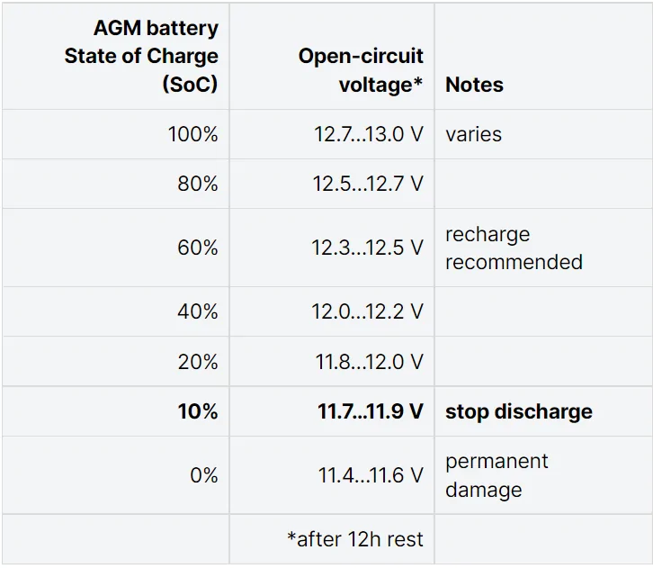

Obviously depends on the truck - some have left them sitting for a lot less than 9 months and had it not start. Mine had gotten down to 12.19 volts and it wasn't even a month.
The batteries have constant load on them, and as all such batteries will do, they lose power just over time - a natural process. And letting batteries sit lower than 12 volts for a length of time is bad for them, shortens their life, can cause sulfation to start. So it may have started, but it would have shortened the battery life, at the very least - isn't good for batteries. They should never sit and be allowed to drain down and stay low for any period of time.
The truck is a load on them,
Batteries naturally lose charge sitting, even if disconnected (it's less for AGM, yes, but it happens)

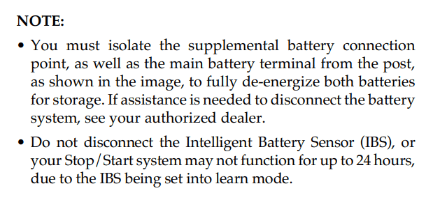

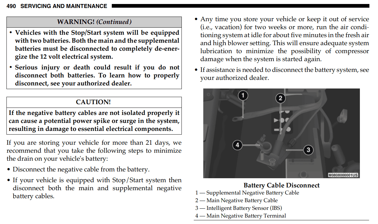

The guidance in my owners manual is to disconnect the batteries if storing for 21+ days.
180
29,512
35,119
Yeah - lowest common denominator, the book, aimed at consumers.
If when you disconnect they are not fully charged, then you let them sit and the further self-discharge, they are sitting in the end at a low state of charge.
Never let them sit not fully charged.
The book doesn't say that.
AGM batteries require full charging between uses or they will have shorter lives, so if disconnecting, I'd do a full charge of each to 100%
On AGM batteries, in general -
Batteries that are stored for long periods will eventually lose all their charge. This "leakage" or self discharge varies considerably with battery type, age, & temperature. It can range from about 1% to 15% per month.
In systems that are continually connected to some type charging source, whether it is solar, wind, or an AC powered charger this is seldom a problem. However, one of the biggest killers of batteries is sitting stored in a partly discharged state for a few months.
A "float" trickle charge should be maintained on the batteries even if they are not used (or, especially if they are not used)
Ideally, I prefer the keep 'em charged thing. Disconnecting is the consumer thing. If they aren't topped off before sitting, and they lose more charge sitting (even disconnected batteries do this) then they may drop to a point where you lose capacity, sulfation may begin.
Owner can choose -
* Disconnect (I still highly recommend fully charging using an AGM charger before leaving them sitting disconnected as they will lose some, even sitting with no connections. )
* Leave connected - and use a charger that has float ability after topping them off.
Generally, unless these are driven every day for a fair amount of time, they don't get fully charged by the truck itself. Mine never fully charges my batteries - it only did when I was driving it a lot more than I am now.
