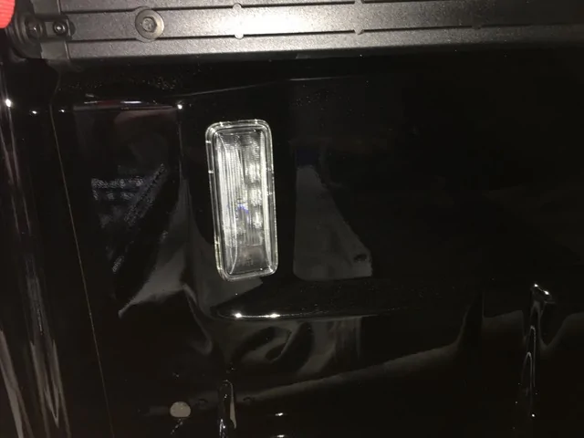

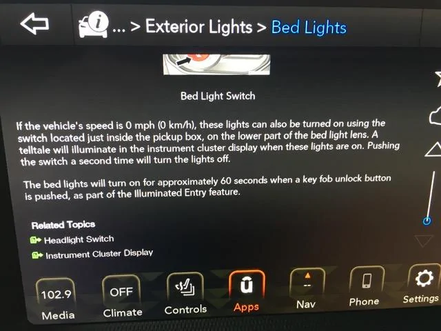

Can anyone clear this up? What am I missing?......
The operating app plainly states you can turn the bed lights on using a switch on the bottom of the lens if the vehicle is not in motion.
I can't find a button for this anywhere on the lights or the bed......

No switch on mine either. Looks the same.

I couldn't find a switch either.....

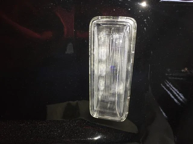

Is the lens itself a rocker switch? Have you tried using on the lower part of the lens itself?
Lens is solid and fixed. I just figured the button/switch got located somewhere else.....
Starting to look like it may be incorporated in the rollup tonneau cover lock pushbutton!!

It's almost like they changed their mind and moved it to the main light control knob and forgot to update the manual. FCA never messes up, right:whatsgoingon:

Looks like "pickup box" should actually read "cab".
Yeah, looks like "pickup box" should be "pickup cab" instead. Which is a shame because my F-150 has a waterproof push button below the LED light lens in the bed and it's been very useful when getting stuff out at night or just having extra light without having to turn on the overhead box light on the back of the cab.

@JeepCares Could you help us with this?? Is there another switch for the bed lights in addition to the one on the light switch? Manual states there is one at the bottom of the lens in the bed but there is not one there.

It shouldn't be too tough to install a water proof switch to control the lights in the bed if desired.
Hi Pat2Alaska,
I appreciate your patience while I did some research on this. This feature is confirmed to not be available. The appropriate team has been made aware that it is mentioned in the Owner's Manual as well as your Uconnect screens and it is going to be looked into. I apologize for any inconvenience or confusion this may have caused.

Lydia,
As the OP I appreciate the reply. I think it is a shame this feature was lost, especially after my first weekend camping with the Gladiator. The bed lighting could have been much more useful.
