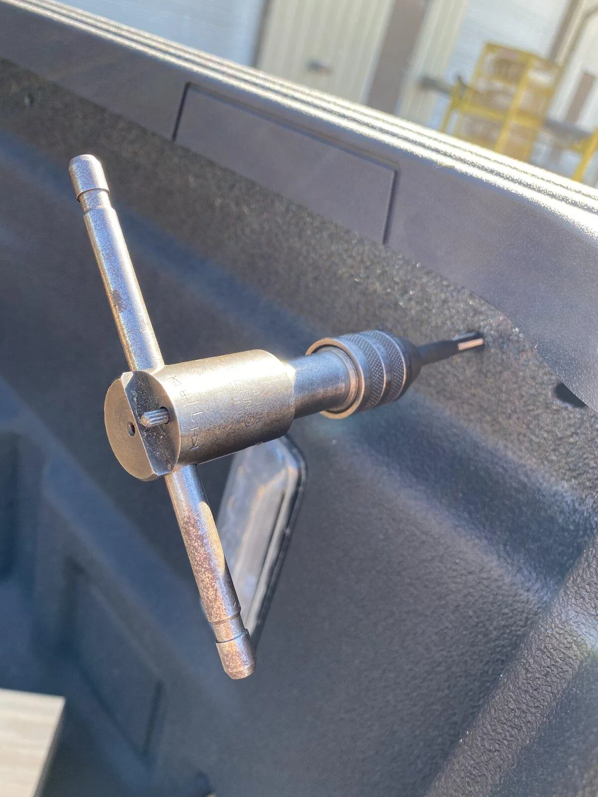

Tap. Keep it straight and go slow and easy. Should work fine. Did for me.
