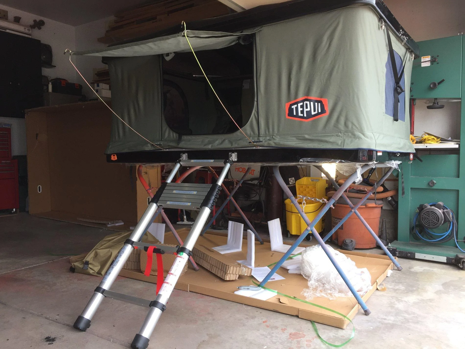

I decided to do it myself. I painted a car a few years ago and thus have a nice compressor and air lines as well as lots of masking materials leftover. (Also, I just spent some coin on a rooftop tent and bed rack and this will save me a little coin.)
I ordered a U-Pol Raptor kit. I can post a picture process if anyone is interested.

Please do!
Also curious, what tent did you go with? I just ordered a Roam Vagabond XL this morning.
