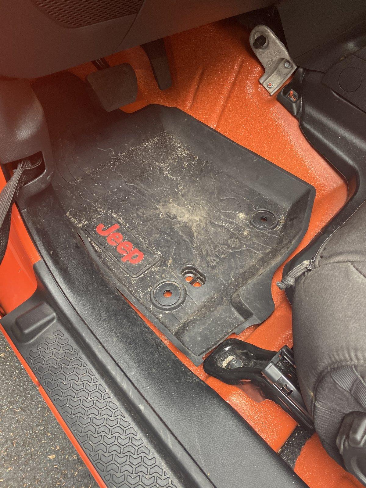

have not sprayed the floor but that stupid carpet has been out for months. Right now I have weathertech mats down and they are keeping me from having to see any of the strangeness that is the raw metal.
I know there are health concerns about some bed liner products in the cab.

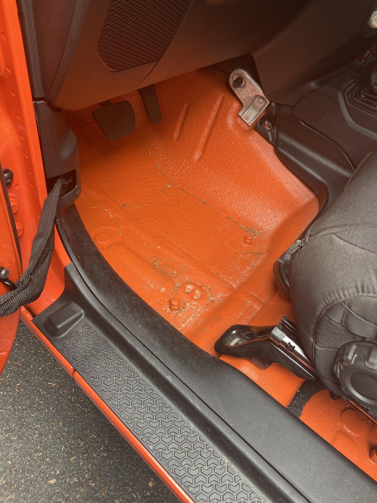

I've not done it to JT but I did put truck bed liner in my MJ floor, more noisy yes did it help in some ways with cleaning. But heat from would keep it melting in places. I had rust to form under it and rusting out. I have ran my LJ with out carpet and just floor mats quite a lot, I did think about having it sprayed in But didn't. You about have to sand blast some spots for the bed liner to stick where you cannot sand to give it "a tooth" to stick to. Same reason you can unstick OEM sprayed in bed liner then just peel off in big strips. End choice I would if I was going to take doors and top off run in mud and slop then just hose out. But without a smooth finish you will have dirt stuck in it still. Just bare paint floor in my XJ did good at washing out with rubber floor mats "with added drain holes" and plugs removed. With it I didn't have a floor rusting problem. But would get hot as heck.

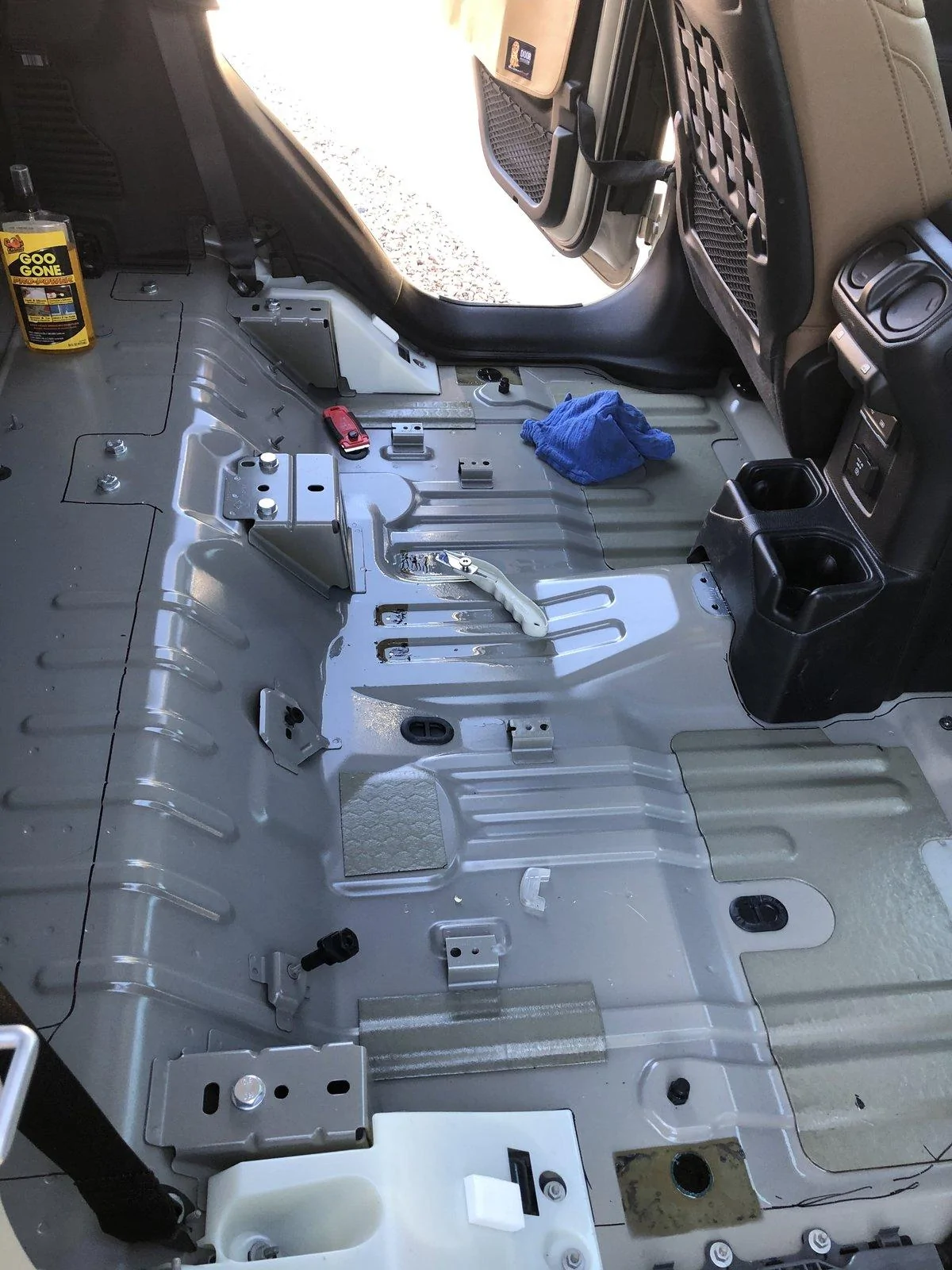

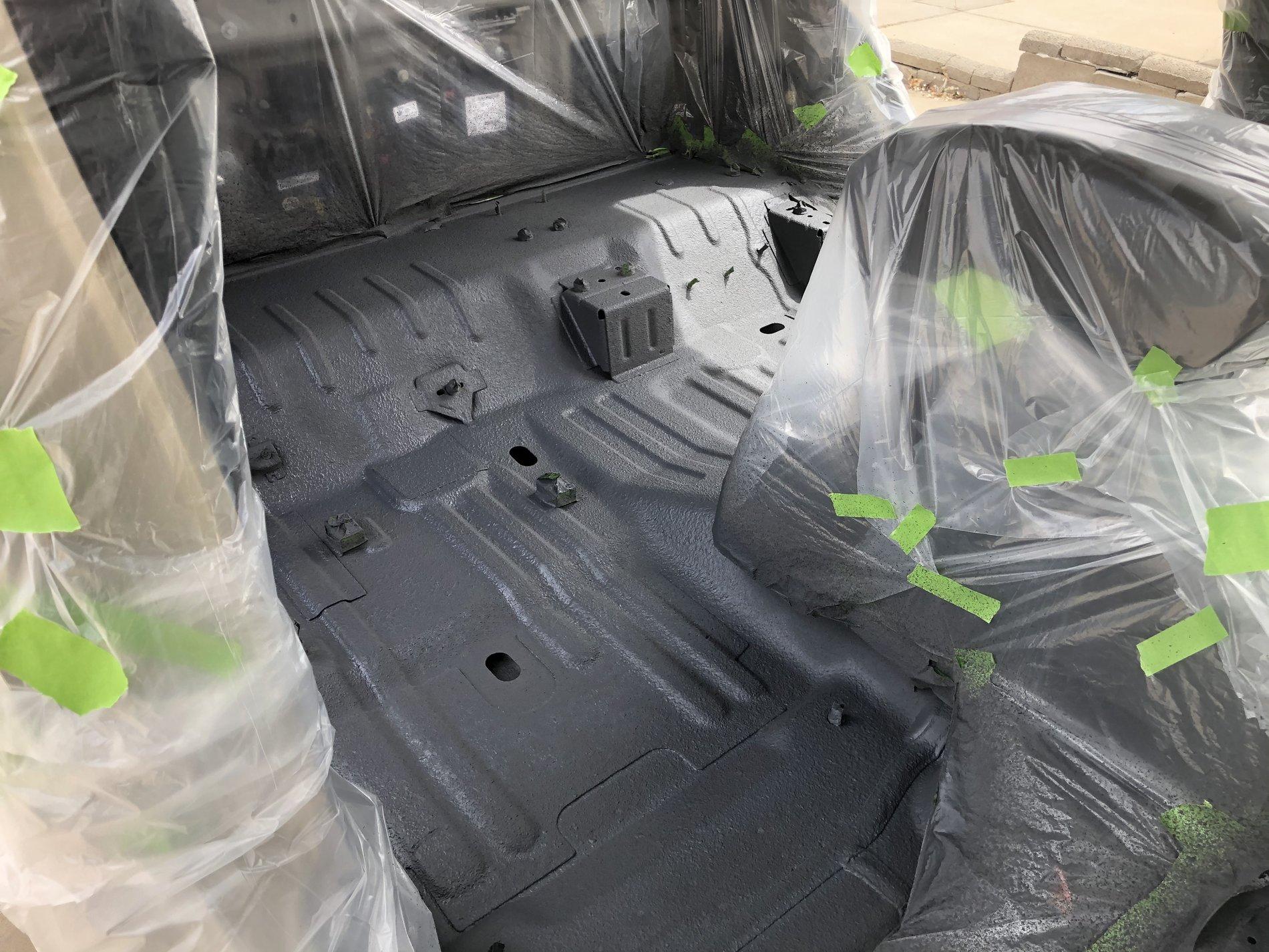

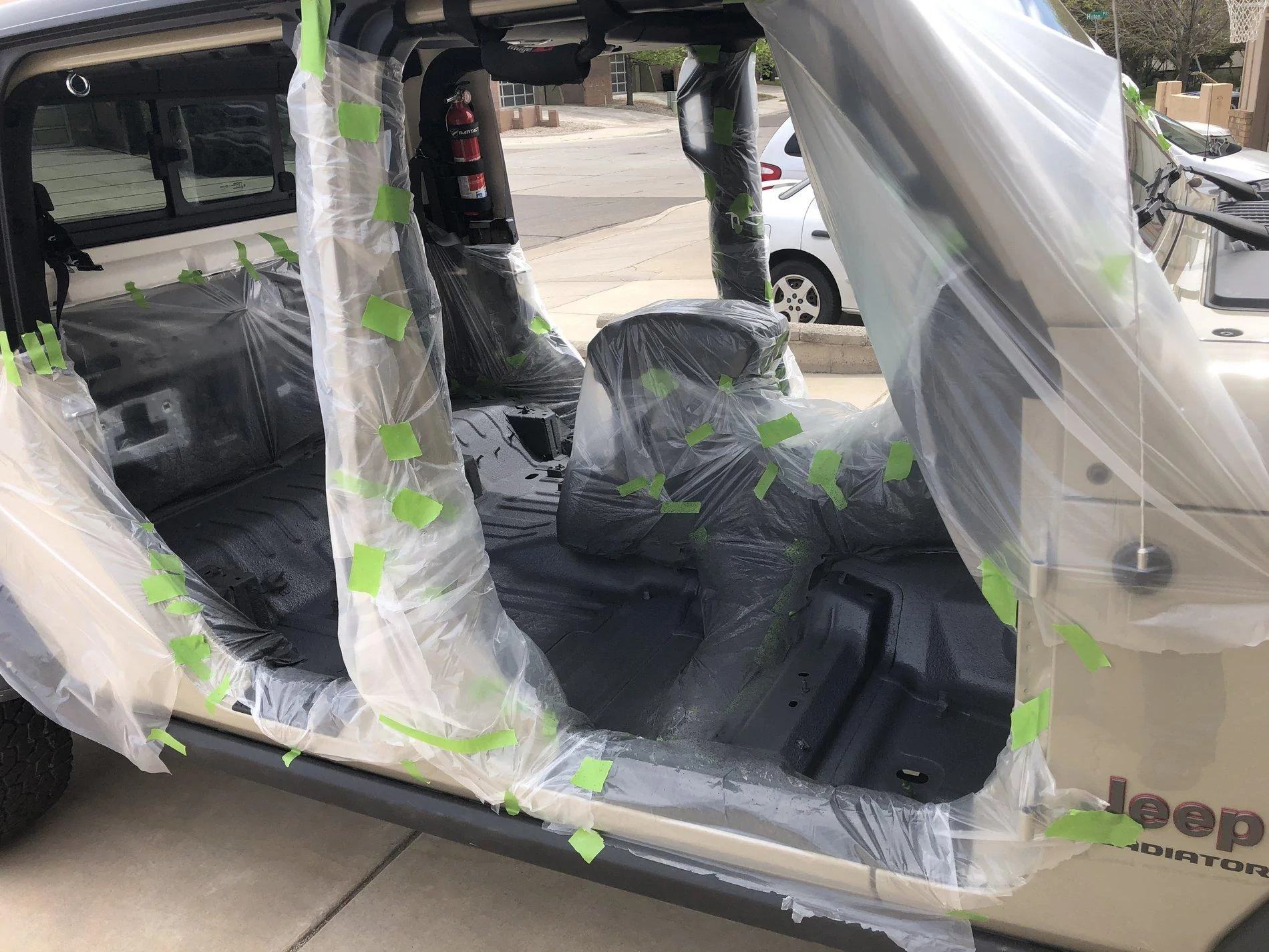

That was one of my first mods. We have a German Shepherd that sheds like crazy. Getting dog hair out of the carpet was a major pia! I stripped out the seats and carpeting and sprayed the entire floor pan with Lizard Skin. It was a four day job with prep, but came out great! It’s so easy to vacuum out or I can rinse it out by removing the drain plugs.

That looks awesome. I wonder why these don't come from the factory like that.

I thought the same thing for the entire time I worked on this. It would be so easy in the build process before everything was installed.

It’s a little quieter. The first coat is a sound deadened and the second coat is a thermal barrier. I can’t say how much it has helped because I got ceramic tint on all my windows and I have the Hot Head liners in. The vehicle is very comfortable as far as temp and noise. The main reason I put it in was to make cleaning easier and eliminate wet carpet.
