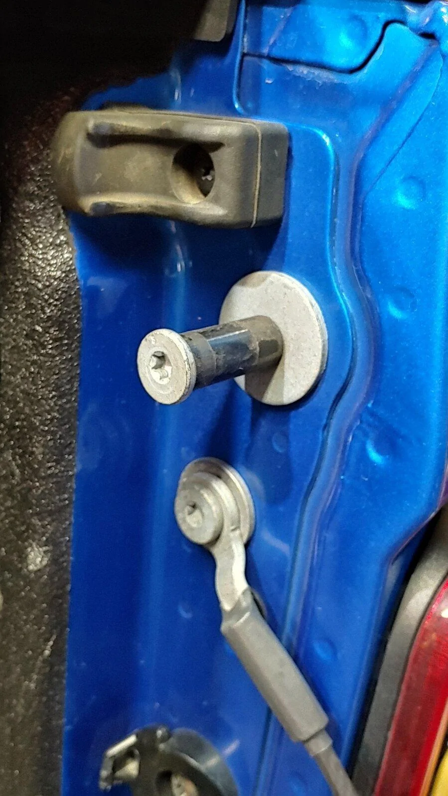

180
29,415
34,988
You adjust these exactly as you do car door strikers. There's a socket just for strikers.
When properly adjusted, the tailgate sits flush with the body and doesn't rattle and you can't shake it.
It's identical to adjusting the doors I've done for years - except there's one on each side to deal with. Loosen it, move it up, down, in, out, and tighten it back up and test the fit again.
The tailgate should close/latch and be held firmly against the rubber bumper above the striker.
This is a decades old latching system. Loosen using the big torx socket - the hole it goes into is large, and it can move around as needed, then be tightened back up again. That's the reason for that big washer - the hole back there is large for adjustment.
