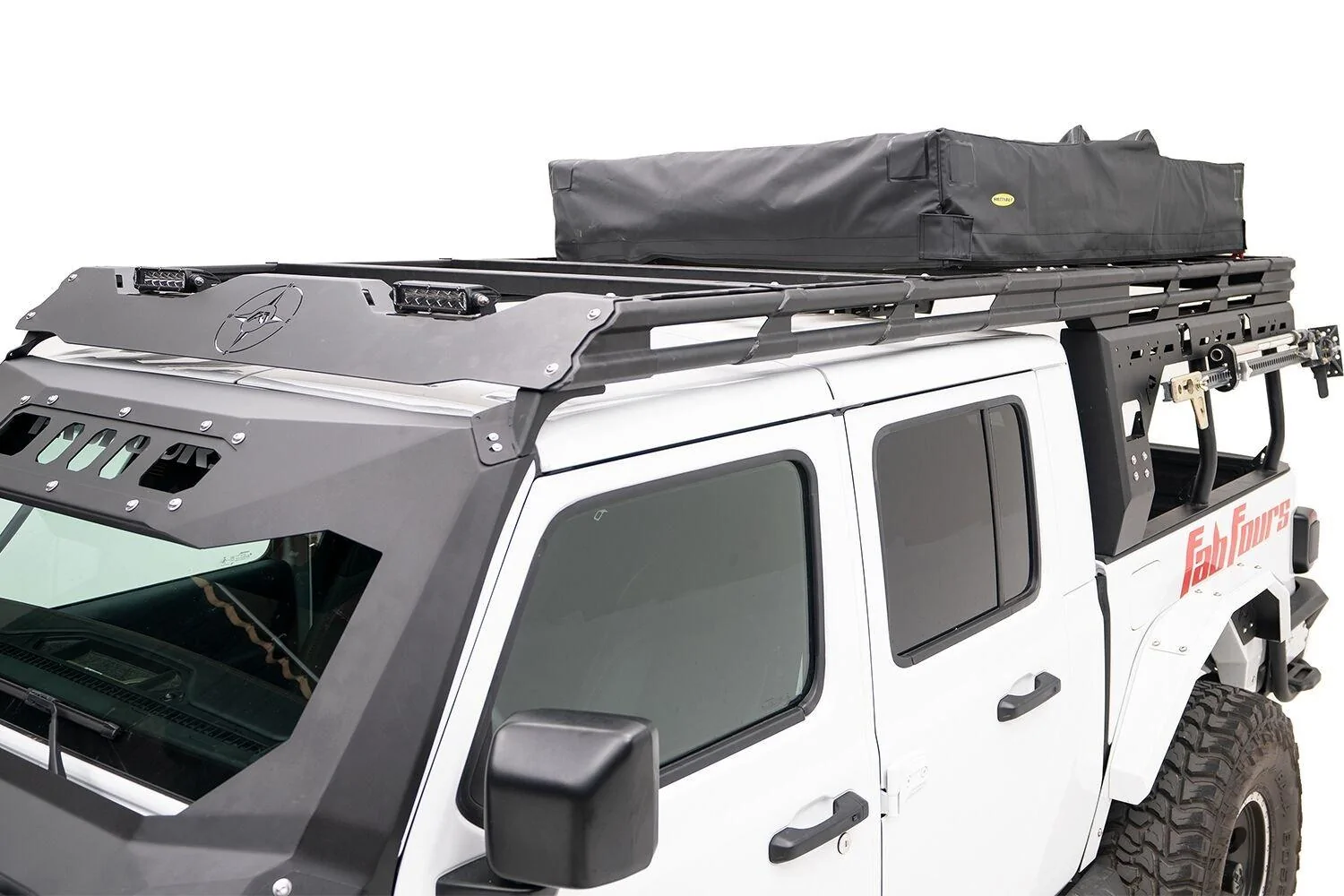

Ideally I'd like a bed-rack and roof-rack combination that could go together for added storage ability. I looked at the Fab Four combo, but the front part over the windshield just kills it for me.
Jeep Gladiator Bed Rack, Roof Rack, and RTT Recommendations Please fabfours-jtor-02-1-overland-rack-extension-2020-jt-4

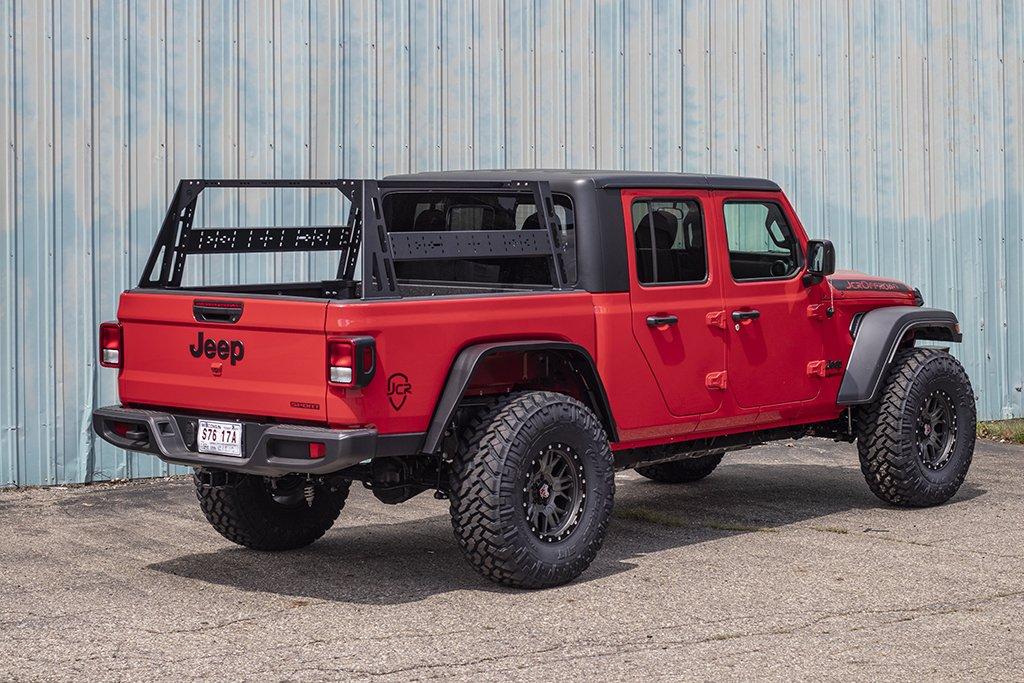

ETA: I am thinking about going with the JCR full bed rack and half roof-rack. Does anyone know the static weight capacity? Dynamic on-road capacity is 500lbs so off-road should be half that, and static should be 3x that?

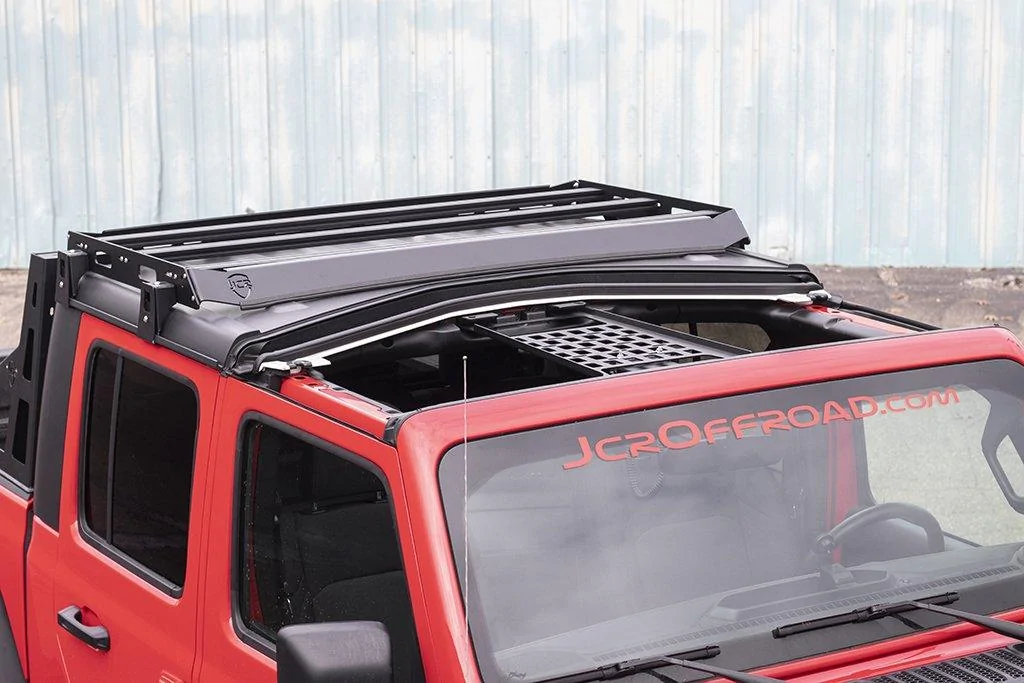

https://www.jcroffroad.com/product/JTBR.html
https://www.jcroffroad.com/product/JTRK.html
Jeep Gladiator Bed Rack, Roof Rack, and RTT Recommendations Please JTBR_1
Jeep Gladiator Bed Rack, Roof Rack, and RTT Recommendations Please JTRK_9

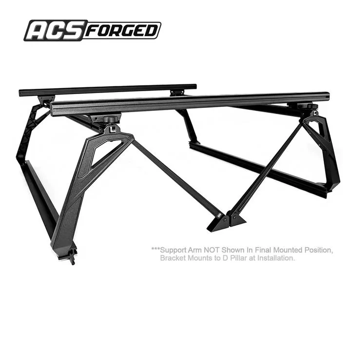

Of course the best option would be a Leitner Forged rack with its 1400lbs static capacity, 800lb dynamic on-road, and 400lbs dynamic off-road capacities! But it is the most expensive and hardest to install
https://www.leitnerdesigns.com/prod...go-system-rjr6l-za5tb-c9hda-cy93l-h3sap-gzrwt

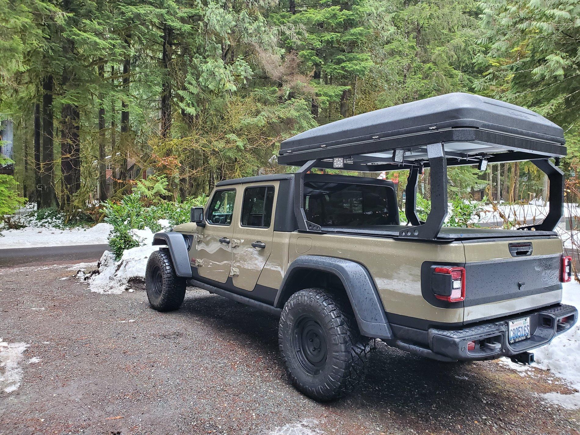

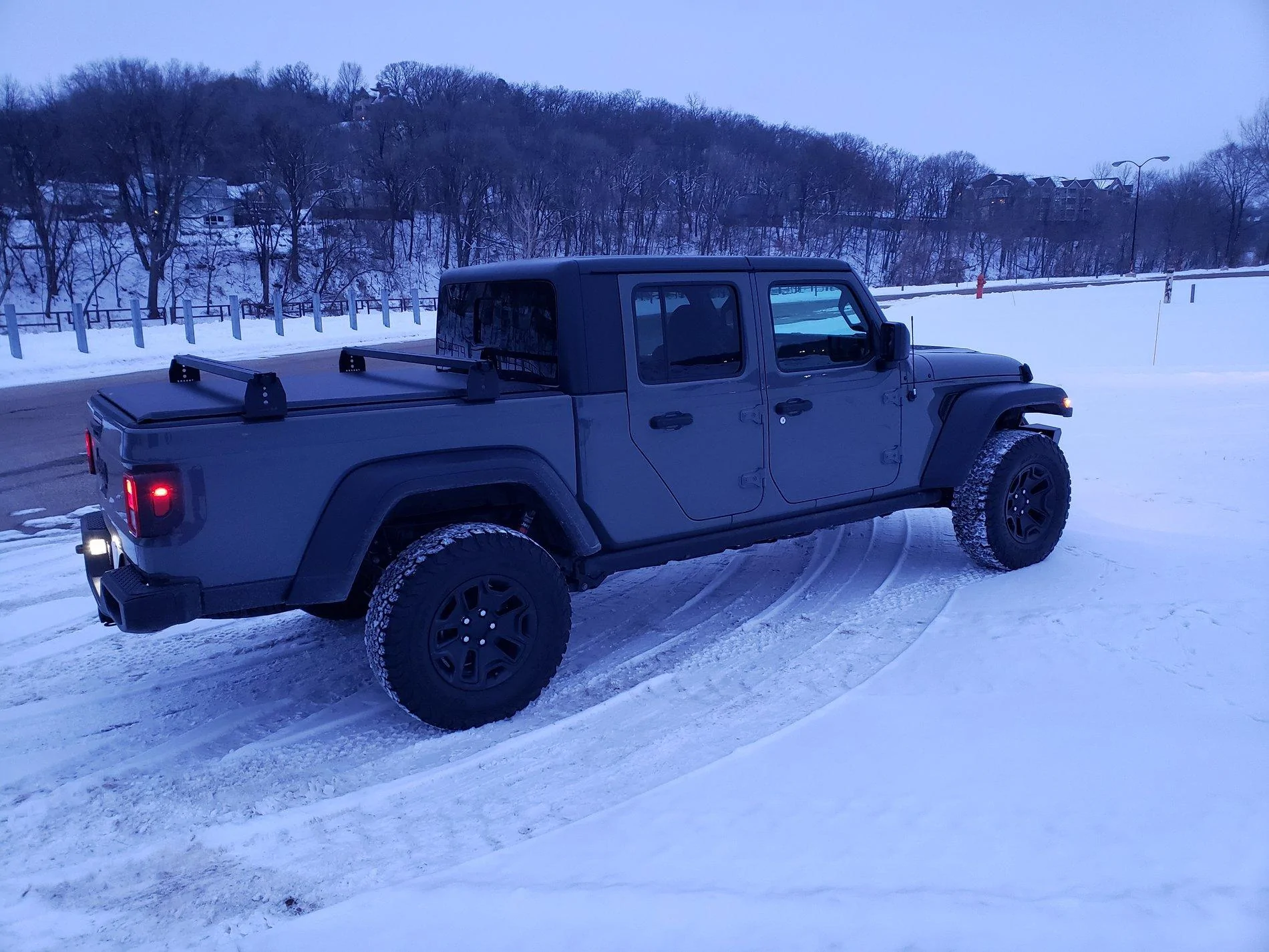

So I have a partial solution, not sure if it is at all what youre looking for. I used voodoo crossmembers for my bed rack. The crossmembers are removable for tall items and the tent is low profile while leaving the bed open for gear and allowing my cover to roll up. You could add a roof rack after if thats still a goal.

I would like the rack to be higher to keep the rear-view relatively clear. The goal is to keep items in the bed, under the tonneau cover, and the rtt on the rack, so that it is as level as possible with gear kept on the roof rack.

Got ya, yea she'll feel a little tippy moving the COG up. Just be extra careful if you disconnect the swaybar. If I see anything I'll do my best to remember this thread.

Looking at the first photo, I dont understand how you can have a rack bolted to the bed AND the body, considering the two move independently of each other.

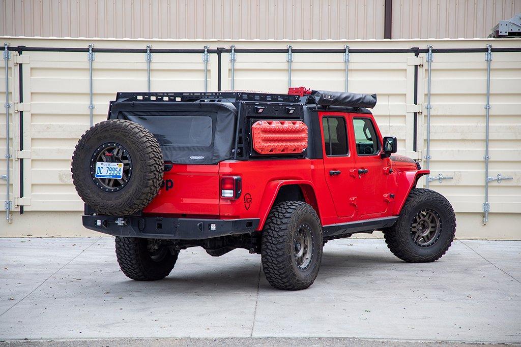

If you are looking for a rack that fits with a tonneau cover your going to be pretty limited right now as they are not a lot available. From my research I found https://www.max-modular.com to be the one of the only companies that makes a full height rack that fits with a tonneau cover. If you are looking to sleep a family of 4 I would really look into the iKamper style tents (Tuff stuff, M.I.A., Roofnest, and many others make this style tent for a more reasonable price.). For the reason that they are really easy to set up compared to a traditional rooftop tent. They also displace the weight better, which is really helpful when you have the tent up in the air.
I have a tepui kukenam which is claimed to be a three person tent. In reality it fits two people comfortably and maybe a small dog. I have enjoyed it quite a bit and would say it is worth the money. I have always had the tent mounted low so I cannot speak as to how it feels to have a tent above the cab. I went with the Ace engineering upper decker. This was due to the fact that it keeps the tent lower, provides secure storage in the bed, has a cargo tray on top for more storage, and is really modular. The only downside to it is you can't really mount a full size hardshell tent like the iKamper I mentioned. You have the get the smaller versions that max out at 60" wide which at most would fit two adults and a small child/infant.
One thing to consider with a roof rack is the height of the vehicle. If you life your gladiator and put 35's or 37's on it, it gets to be a pretty tall vehicle. Anything that you put on the roof rack will become difficult to access especially if it is any heavy items.

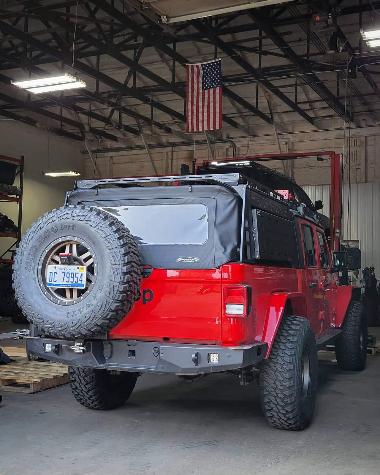

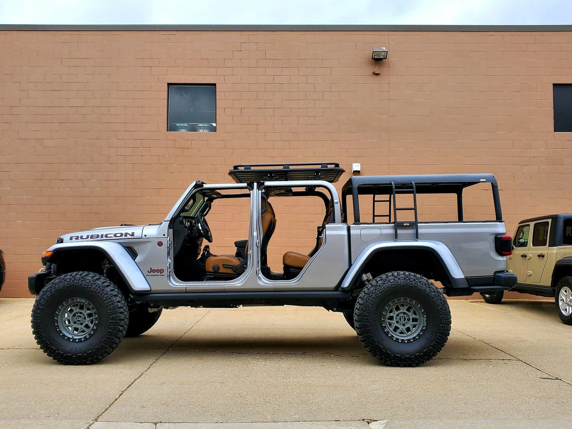

I think for under $2k you can get a custom rack fabbed up and get exactly what you want out of it. That is exactly what I did. Also it can be done out of aluminum and significantly reduce the weight. My rack weights like maybe 70 pounds max.
My rack may not be the direction you are going but posted it to show that a fabbed rack can look just as nice as the production racks.
This RTT is the iKamper skycamp. I think it measures 60"Ă—84" closed. It's a good size tent.

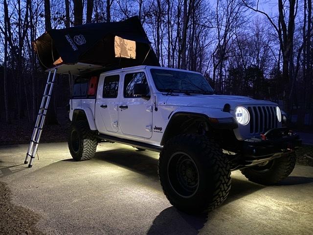

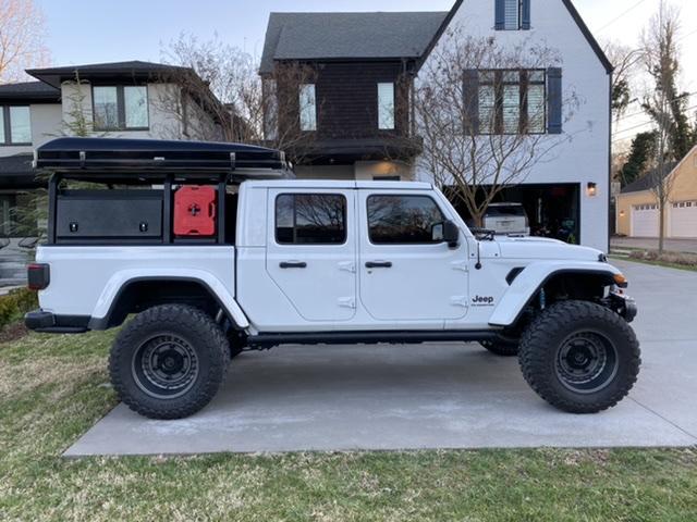

Not sure what your budget is, but I approached my process asking similar questions. Eventually what I wound up with is:
  • Nuthouse Industries full-height rack (can also be made with removable cross-members) - aluminum, light weight, has lots of additional storage and can be fully customized with lighting, etc.
  • IKamper Skycamp 2.0 RTT - as the member above posted, it’s an amazing tent with huge amounts of room. Sets up in about 2 minutes, takes down in about 3.
Photo below of the setup:

Has anybody purchased the Fab Four overland rack with extension? It does have a more basic A pillar front mount (not just the armor version), but like someone else mentioned, how does it work if the truck bed articulates or flexes? I really like the idea, but unsure how it will work.
