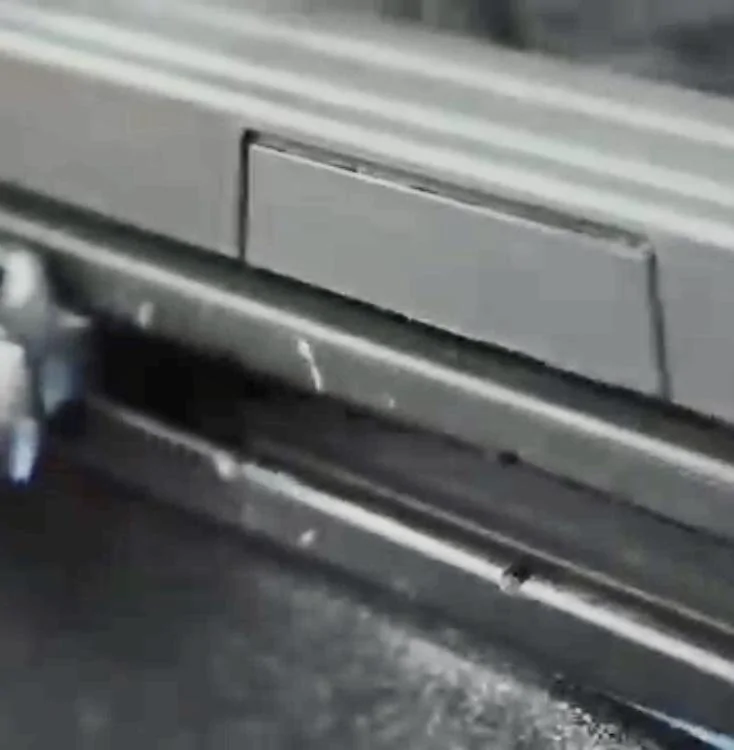

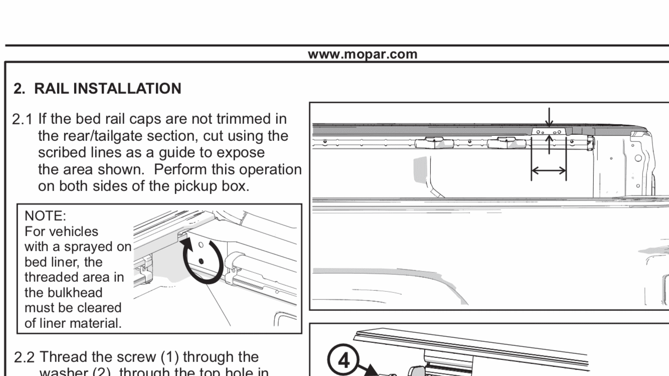

Got a simple question. I already have a Mopar hard tonneau cover. Waiting to see a Gobi and Sting Grey before I order my truck. In looking at the instructions there is a little piece of plastic on the sides of each rear rail that has to be cut out. There’s 2 threaded bolt holes behind these sections. And you bolt the sides of the cover rails to the sides of the truck with these 2 bolt holes. The instructions say: Cut using the scribed lines as a guide to expose the area shown.

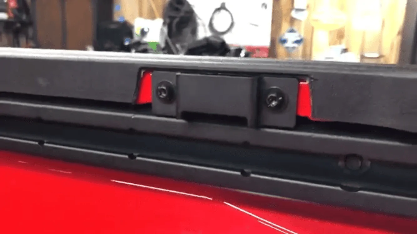

The red truck shown has a soft trifold tonneau cover.
Anyone know the best way to cut this section out? I could easily put a flat screwdriver into it and lift up with the screwdriver to break it off. But would hate to have that break some off the surrounding plastic in the process. Or I guess I could try a razor blade knife to cut it out. Not certain how well that would do with cutting plastic with a razor blade knife. Anyone ever cut this section out in order to install their tonneau cover? How did you cut out this section without messing up the surrounding plastic? Thanks for your comments and suggestions.

I would think a fresh utility knife would do just fine.

I just watched a very long and very boring video of a guy putting on a soft folding tonneau cover and he used a box knife cutter (razor blade) to cut it, easy peasy. Now I know.

Remember too that a heatgun or hairdryer can be your friend when cutting plastic.
