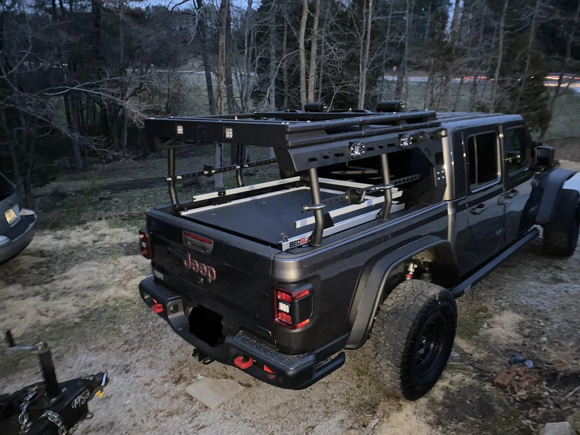

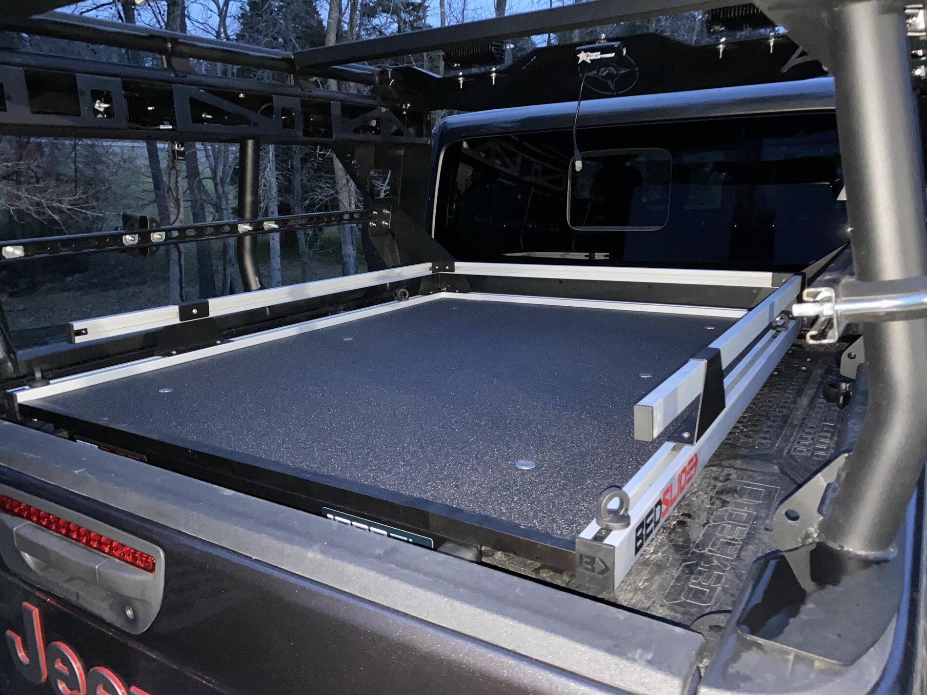

So I got the bed slide installed tonight. I’m not totally sure about it but I think it will work out. I was dying trying to climb between my bed rack and the decked drawers. This seemed like the best solution.
The mounts that bed slide makes do not work with the gladiator decked system. You have to drill directly into the decked frame. It barely fits with the trail rail front mounted.

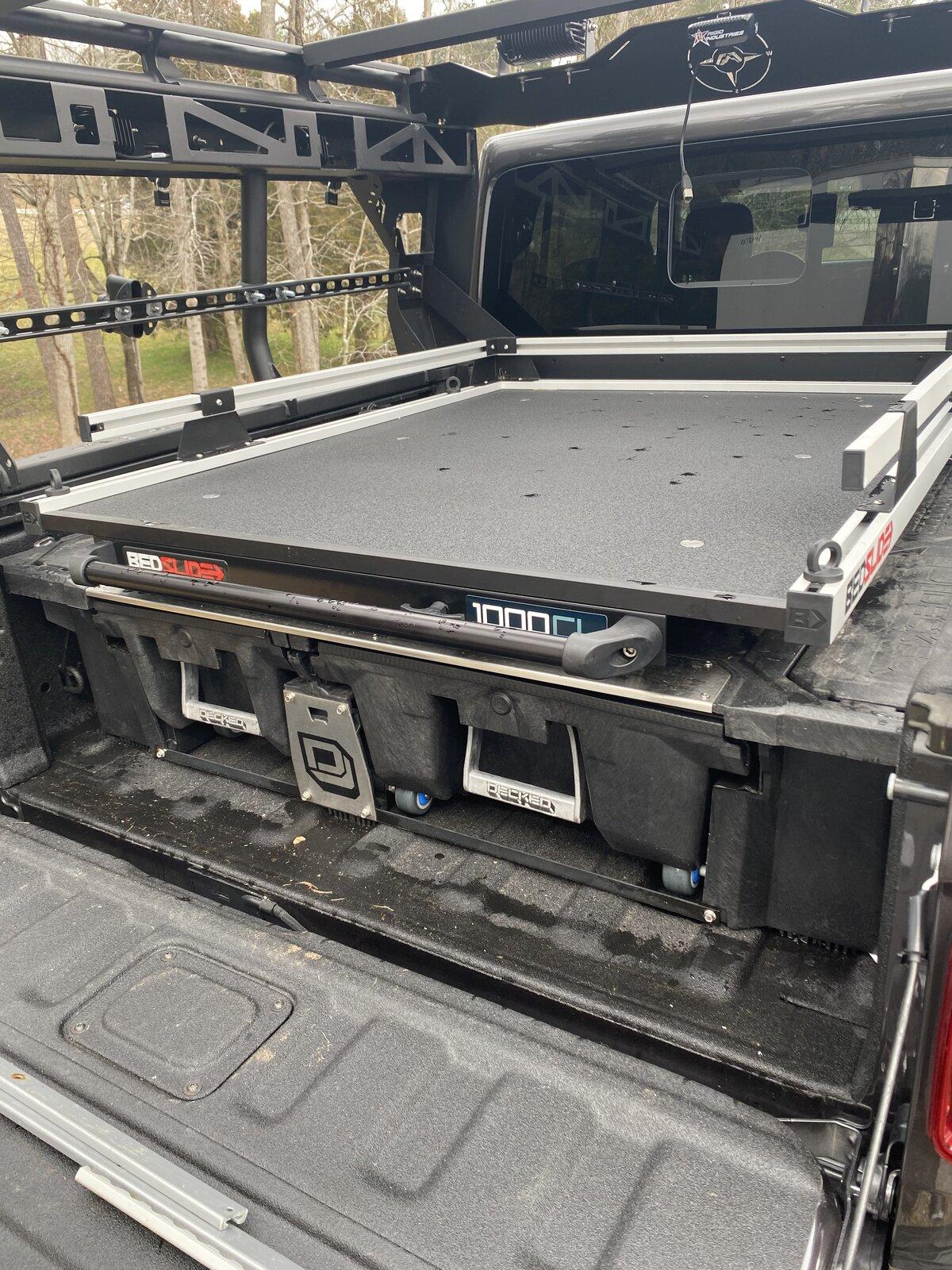

Haven’t used it too much. I did test fit some stuff for my next trip. The 24 gal action packer fit side by side. Then still room for Cooler or more containers. Definitely makes it a lot easier to reach the front of the bed.
The bed slide is not as smooth as the decked drawers. It feels solid though.
I’ve got to work on finish wiring all my lights and scene lighting so it will be ready for my next trip but there just isn’t enough daylight or hours lol.

Looks great and I hope it works well for you! I did something similar with a fridge slide on top of the decked drawers - needed to drill through the t-rails to find the metal tubes. Very solid ... and the access and organization is wonderful.
Well done.

Thanks, yeah it’s kind of a pain to mount stuff and makes me a little nervous but decked says it’s fine for the 1,000 lb slide. Hoping to never find out differently.

I missed it at my first glance in your pictures, but looks like you are using the bedslide that would sit between the wheel wells without the decked system...I am picking up a used decked system tonight and really like the idea of a bed slide on top like your set up, but would since the decked system sits above the wheel wells, bedslide should make a wider version that sits the full width of the bed...I do however realize you would lose the access to the two front storage compartments on the sides of the decked system. Catch 22...not sure what is more valuable? I am actually thinking of designing my own slider and maybe I will notch the front corners to accommodate the best of both worlds.

So the slide just barely clears the ammo cans. It is fairly close to tailgate opening too. Not sure if you can gain much for the extra work of fabricating it. Worth a shot though if you have the tools I suppose.

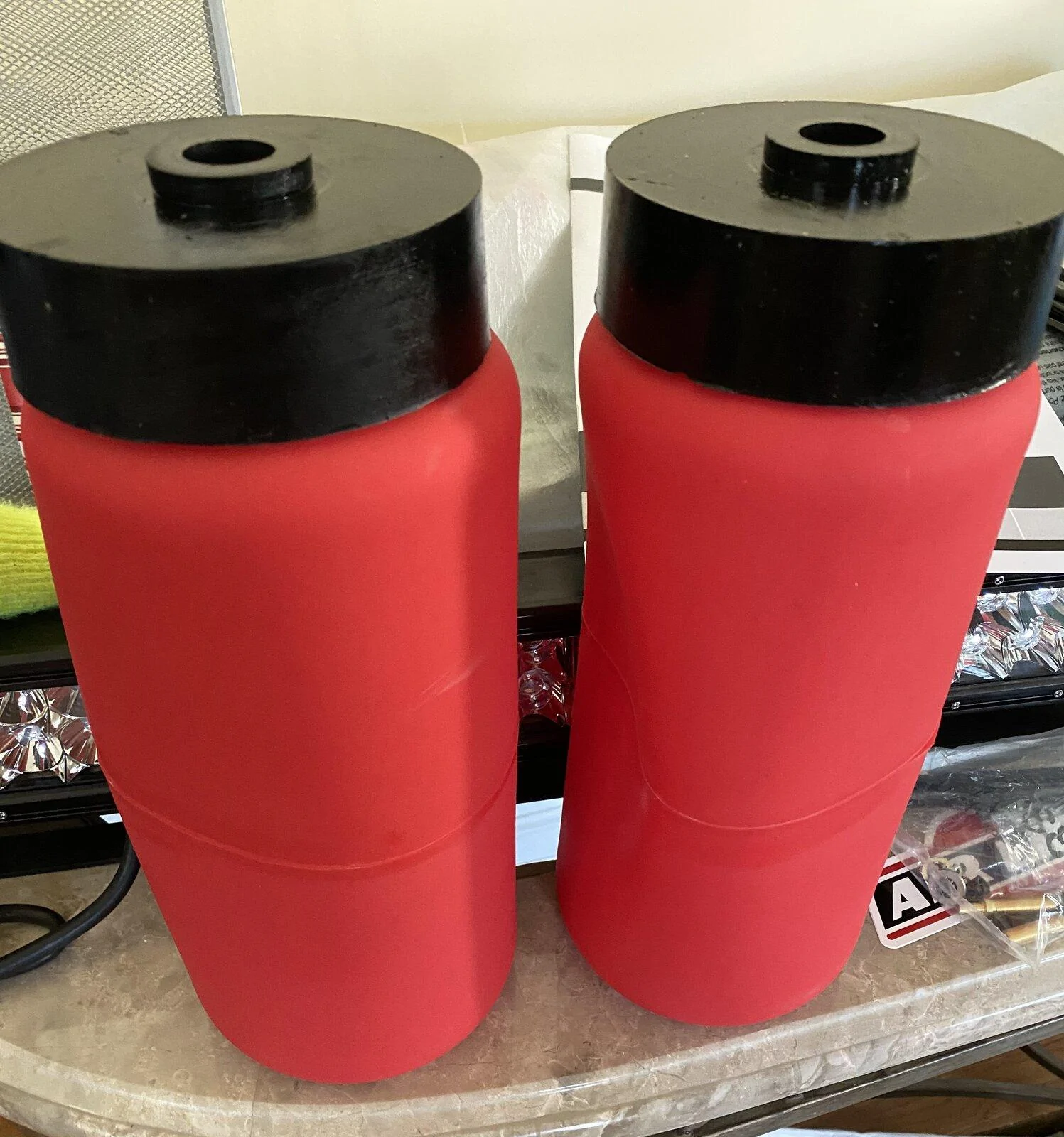

Do the airbags address comfort, performance, capacity, or some of each?
Stitchedupseats
Stitchedupseats
Nov 27, 2020
283
307
North Carolina
22 JTR
No sway at all with my trailer now, back height is back where it was stock, ride is less bouncy now too. So I guess a little of everything is improved. For 86$ - can’t beat it.
