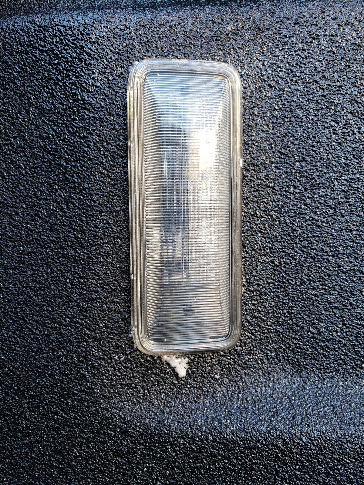

Took my less than week old baby in for a bedliner while the bed was perfect. I was assured they had done one, and they had an experienced installer. When it was done I noticed something strange about the bed lights. One wasn't flush and the other was stuck on with gray gasket sealer. Needless to say I about passed out. They had removed the lights, breaking the clips rather than mask around. They are buying new lights, but the added thickness of the liner underneath is going to be an issue again. They cannot answer me what happens to the paint if the liner is removed to allow the bed lights to install flush. Anyone else run into this issue? Thanks

My Line-X guy masked off my bed lights for that reason. You might be able to score the edge around the light and pull the liner up but you'll need to hit a very delicate balance of deep enough to remove it but not so deep you hit paint. It's not something I'd trust a shop that did a poor job to do.

Sweating over nothing.
To properly apply a bed-liner they would have had to sand down the bed and scruff it up to really good to properly bond, what they have to do to fix the lighting issue isn't even an issue to worry about.
My lights were removed, not taped over. I don't even think I’d want them to tape over as that would not adhere properly to the surface. Also done by Line-X

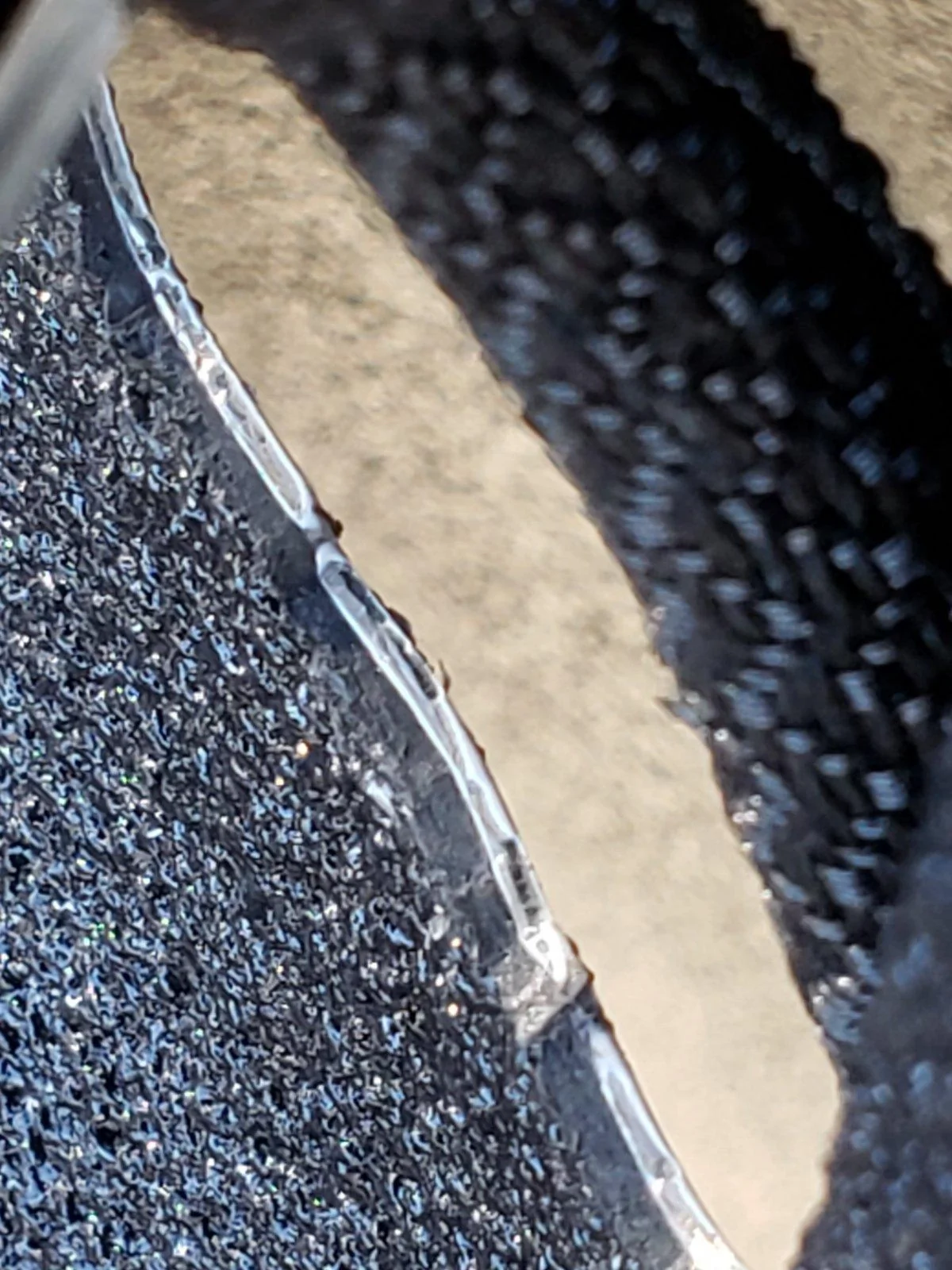

Here is the bottom of the opening where the fixed tab goes over. The guy tried to push it on and bent the metal. He then tried a knife to clean the liner but also removed the paint.

Exactly this, when they apply spray on bed liners the paint underneath isn’t anything you’d want to see again. The liners are awesome for protecting the bed, but they aren’t there to protect the paint.
http://www.toffliners.com/application-process/ (don’t know these guys at all, but they had nice pictures, hope linking is ok)
article linked shows the standard process of scuffing the bed to get it ready for liner. You can definitely get it perfect again. If the shop does bad work they may not be the best guys to fix it, but it’s a very fixable issue.
I totally understand the worry though, these are such beautiful Jeep Trucks. Congrats on the new ride.

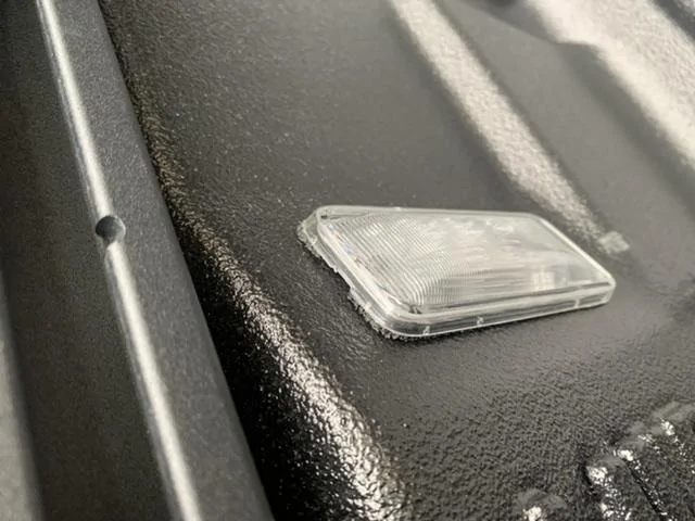

I'm not sure if we are talking about the same issue. I realize the paint must be scuffed. My question and issue was with the removal of the bed lights. The attachment method requires a certain thickness, which as designed is sheetmetal only. With the bedliner material added, it's too thick for the lower tab to engage and the upper to press and clip in. I went to a dealership that uses a name brand liner and they mask the lights. I was just wondering what others may have experienced with there JT.

The dealership masked over mine. They didn't need to remove the lights at all. I wouldn't worry about the paint underneath so much,but it would be a concern if the lights don't install flush. This stuff amazes me. I'll give my dealership credit for masking the lights but they did bedline over every screw or bolt in the bed that wasn't removed and they also bedlined the holes of the ones they did remove making it a job to reinstall the tie downs in the corners.

I was saying from a new truck stand point and my OCD I wouldn't want mine not sitting flush. Mine do sit flush in my bed but they masked over mine instead of removing them which is how I have saw it done mainly. Not sure why they would go through the trouble of removing them.
