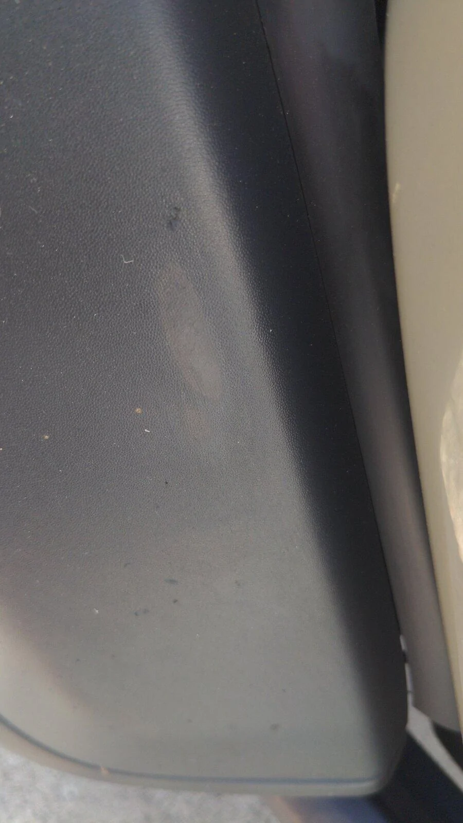

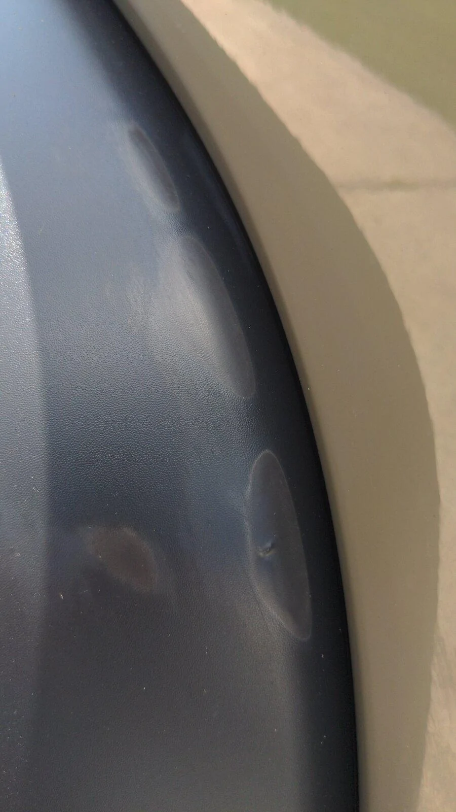

Not my first choice but my OCD's starting to kick in. I got some kind of chemical or something on my passenger side rear one and after a few attempts with different products I have had no success getting the spots to go away. I have no idea how it happened either. Pictures for reference, ideally I'd prefer to replace it but would like to find two from the same Jeep for the rear so they would match as far as age goes. Don't really want to buy a new factory one because then you will tell which ones newer. Figure the bedliner would hide the imperfections that are in it as well.

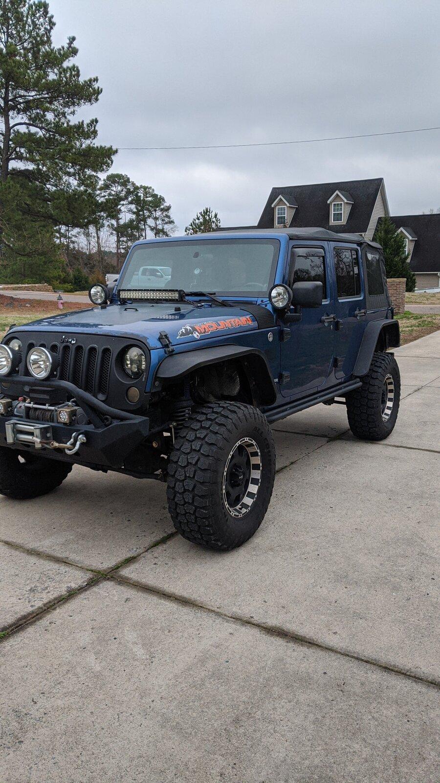

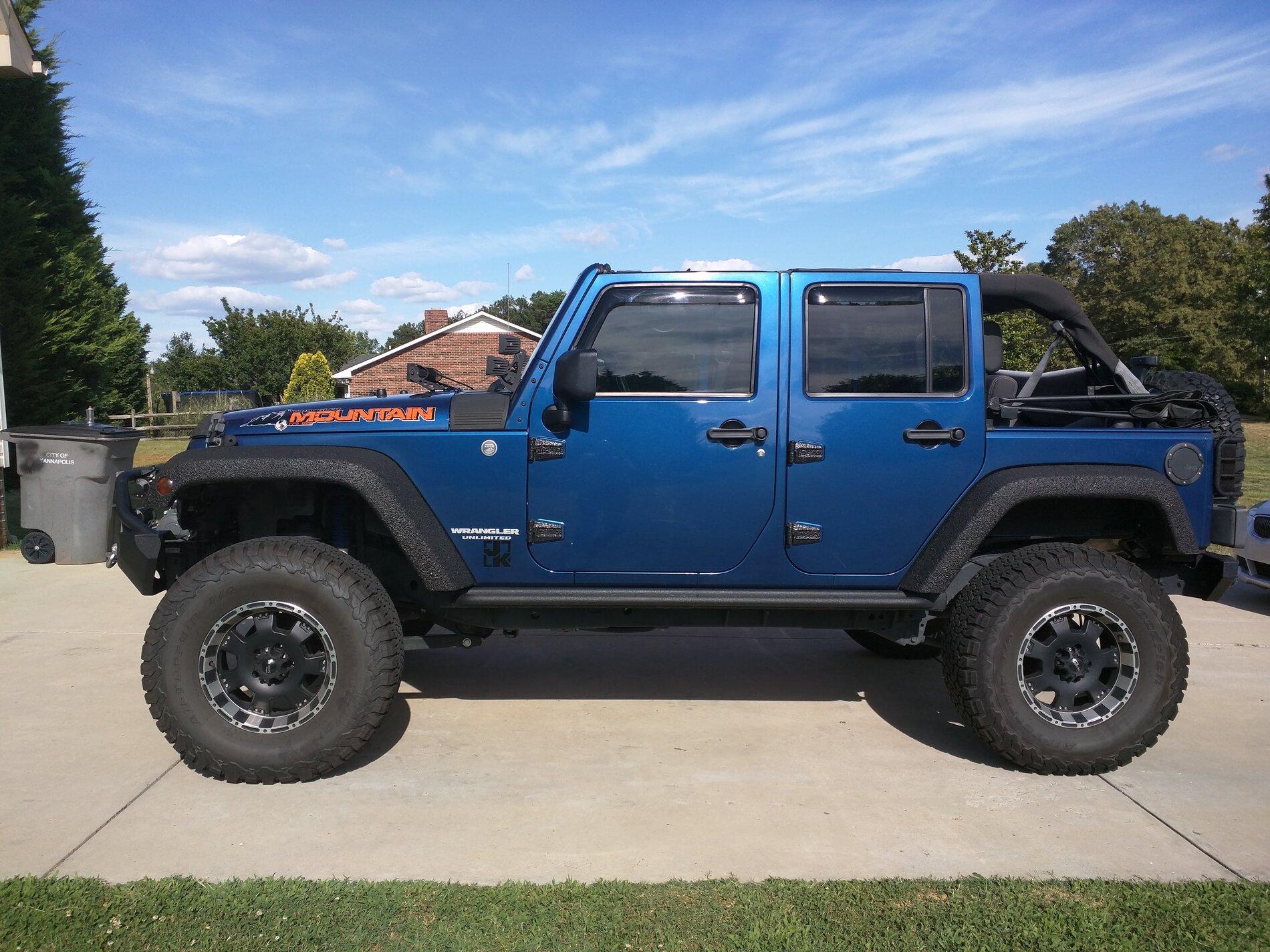

I had my fenders done in Scorpion Liner on my JKU. It never faded but it did start coming off in places after about 2yrs. Good thing about it was that it was easy to fix because of how textured it was. I paid someone $125 to do it. They did my hinges and fenders. Hinges never came off or faded in the 4+ yrs i had it on them. This was Scorpion Liner.

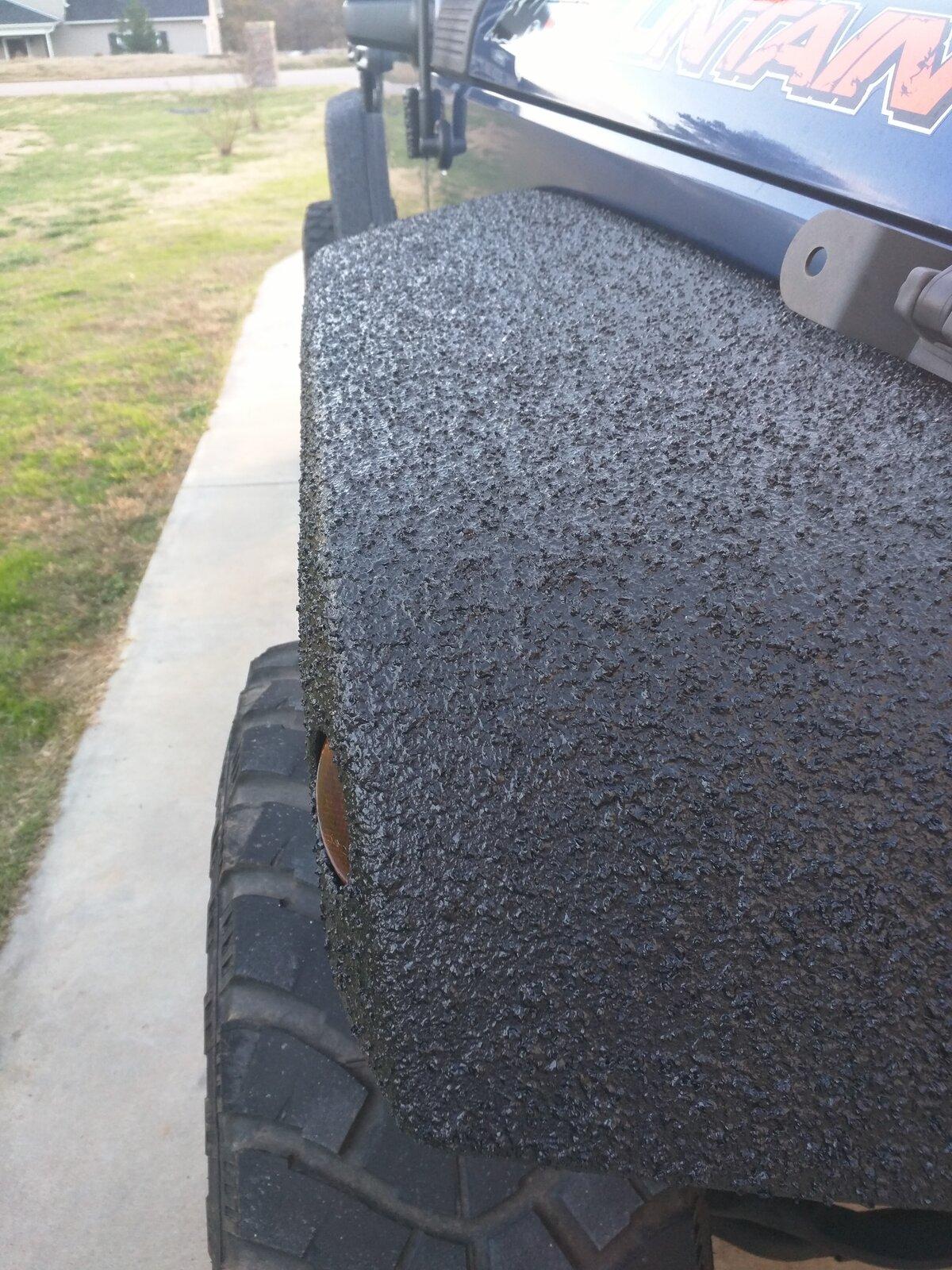

That's it about 5 days before I sold it and bought the JT, hinges still look good. That was February of last year, I had the hinges done in 2015.

I agree, if I do mine I'll probably go with Herculiner because it does got a finer finish. The guy who did my fenders and hinges mixed some diamond flakes in with it so it would have a more textured appearance. I liked it at the time but for my JT I would prefer something a little closer to how they already lookswith a small amount of texture and maybe a tab bit darker.
