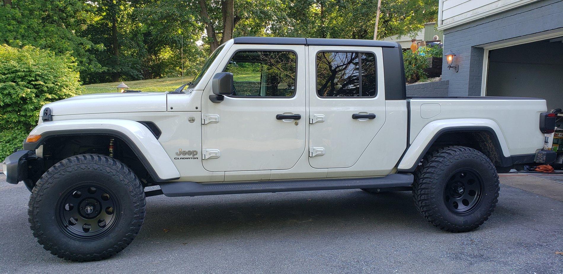

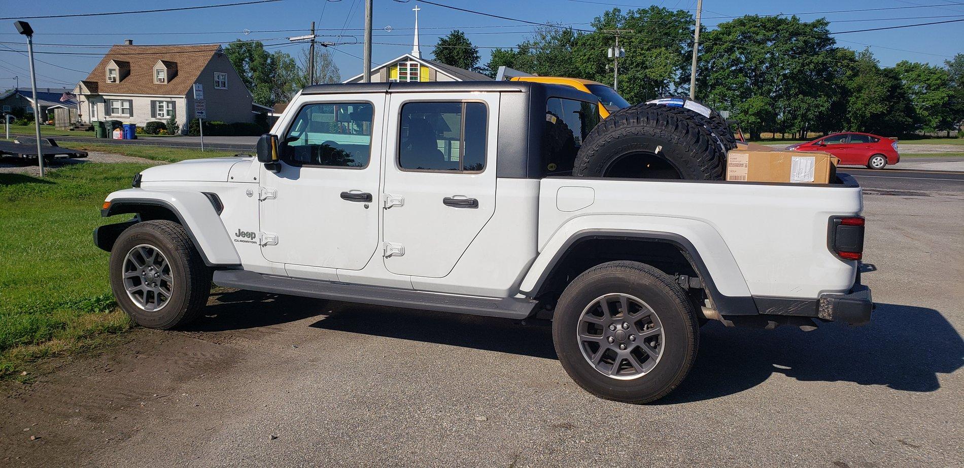

Before and After: Overland on 35s. Rubi takoff and 2"spacer kit

How would the 35's had faired without the Rubi suspension and spacers? I know they fit well on the Rubicon but don't see many overlands on 35's not lifted.

I have 285/75 18 (measure 35) on my factory overland wheels and it was fine not lifted. I ended up doing a leveling kit but just for aesthetics.

I read so many articles and opinions of what would and wouldnt fit that it was overwhelming. In the end I opted for the Rubicon take off mainly for the shocks. The 2" leveling kit was for extra clearance just in case. Everyone had me scared 35s would rub without having Rubi fenders. Hind sight they would have fit w/o the kit but still love the way it turned out and it has room to flex.

I'm in the same place and have come to the conclusion that a Rubicon take off, teraflex 1.5" level and .75" in the rear will give me the stance and clearance i am looking for with ~35's. 295/70r18's specifically so I can stick with stock rims.

I am running Rubi suspension with leveling front (I think .5 or .75) and I plan on getting 35x11.5r17.
This helps me feel better about clearance.
I will run the tires as is and then do the AEV spacer lift if I rub. Thanks again!
