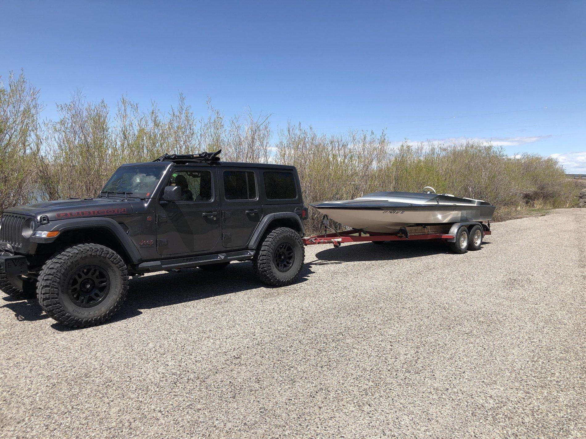

@MattCone_TX I am in a similar situation. Where I live Diesel and regular gasoline are within a few pennies of each other. At todays price I calculated out the fuel cost on 100000 miles at 18 mpg ( my average in my wifes gas v6 gladiator) and a lofty goal of 28 mpg (3.0 Diesel). The gas would use 11777.6 gallons, the Diesel would use 3571.4 gallons. Todays cheapest local price is 2.19 unleaded and 2.20 Diesel. This means $12166.6 of gas and 7857.08 of Diesel for 100k miles. This is a difference of $4309.52 in 100k miles. According to literature the DEF system needs filled every 10k miles. I think it holds 8 gallons. So 10 Def fills using Sams Club DEF price of $11.98 per 2.5 gallons. Lets say we use 85 gallons of DEF in 100kmiles, 34 cases costs 407.32. There are some assumptions here but I think for some people the Diesel does recover some cost and is more fun to drive. I do my own maintenance so I pay a little more than what a gas engine costs (currently figuring about $75 at 10k miles over $40 at 6k on the gas.)
I had a JLUR with the 2.0 turbo running 37" Cooper STT pro tires. My actual mileage was about 14.5 MPG but it was fun to drive. I left the 4.10 gears in it and really only noticed I didn't use 8th gear as often. The only reason I sold my JL was to order this diesel. The 440 ft lb of torque is really why I purchased the Diesel gladiator. Anything else I might see is only a bonus.
