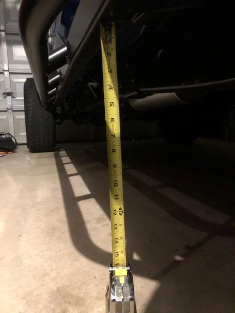

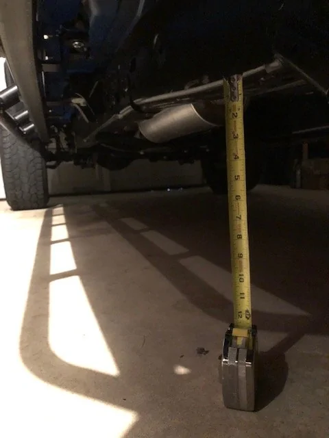

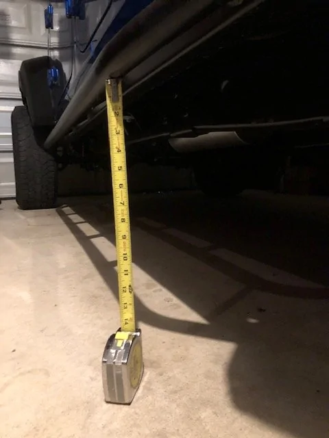

Brian,
Here are 3 pics ...
The tubes are 1.5" lower than body mounted portion of the slider.
But, the tubes are 2" higher than the frame.
Jeep Gladiator Best Combo Rock Slider Rail and Step height of slider at mounting point
Jeep Gladiator Best Combo Rock Slider Rail and Step height at end of slider
Jeep Gladiator Best Combo Rock Slider Rail and Step height of frame rail
Most forum members will recommend 'angled up' sliders. Angled up will perform a little bit better in some offroad scenarios ... allowing the body to roll further before contacting a rock which gives you a little more 'clearance' in that way.
Even so, you are far more likely to set your JT down on a frame rail or skid plate than the angled down slider. Even if a rock is situated outside of your frame and you set your JT on the angled down slider, it's made to support that weight. Both angled up and down will 'stiff arm' rocks and such that are next to your rig. For me, the greater gains in step functionality out weigh the very minor gains in less common off road situations.
You may want to ask guys whose off road experience exceeds my 2yrs of off roading how often the angled up slider will make a difference over the angled down slider. You might also want to watch a bunch of youtube offroading videos on terrain you're likely to drive ... watch to see specifically how often the angle of a slider would make a difference.
Best of luck in your decision!
(The good news here is that I really do think you will be happy whether you get an ACE slider, or a RockHard slider up or down.)

Thanks Jed for your great photos :) After receiving them and the below response from Rock Hard, I decided to join the other 99% of Rock Hard nuts in da world. Hopefully I won't regret it.
Brian,
Thank you for choosing our sliders! Angled down sliders sit 1.5" lower overall than our angled up. 45-degree difference is all. 99/100 of our customers order angled up. It's the traditional look everyone loves. We offer angled down simply because there were enough requests.
