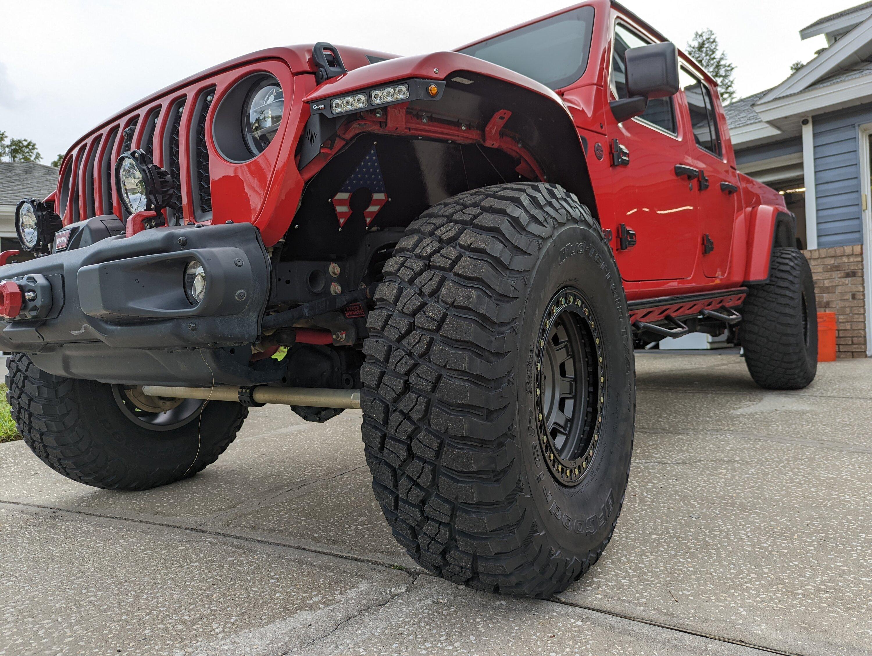

Quake also offers a 3rd option which isn't so slim of an LED which is what I went with mostly to be different. Its been on a few months, no rust, no issues, quick and easy install as well.

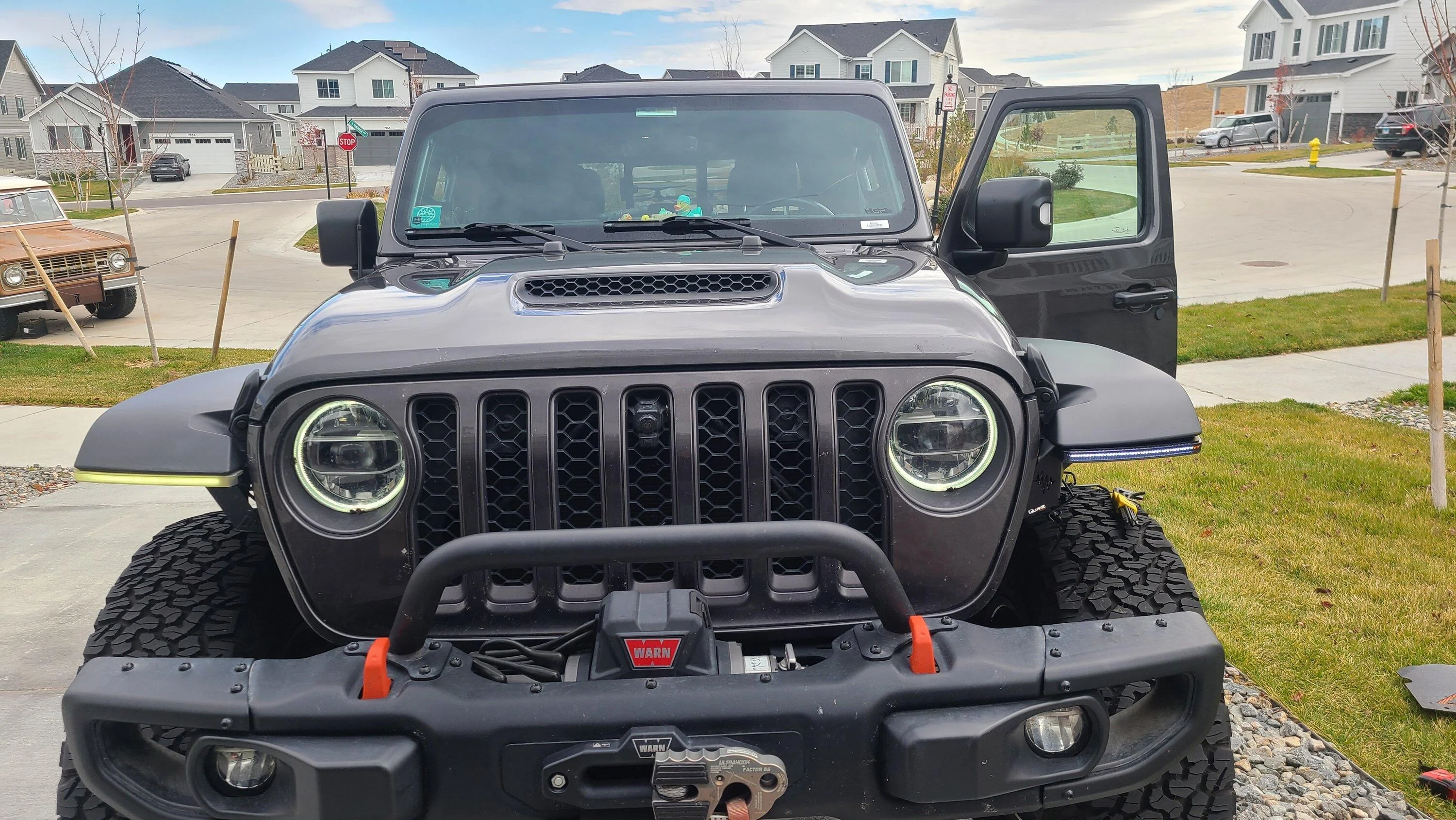

Here are pics with the install completed
I am just up the road near the Aurora Reservoir

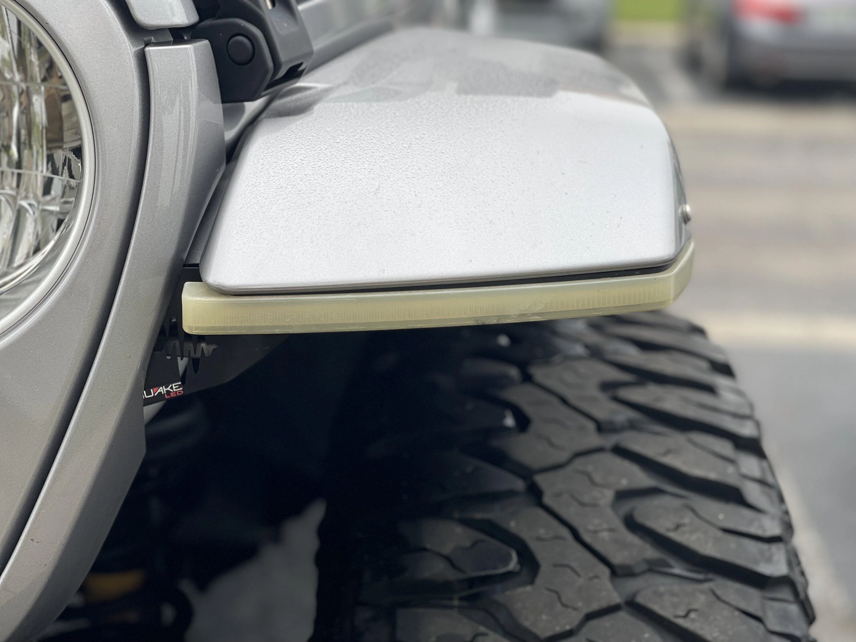

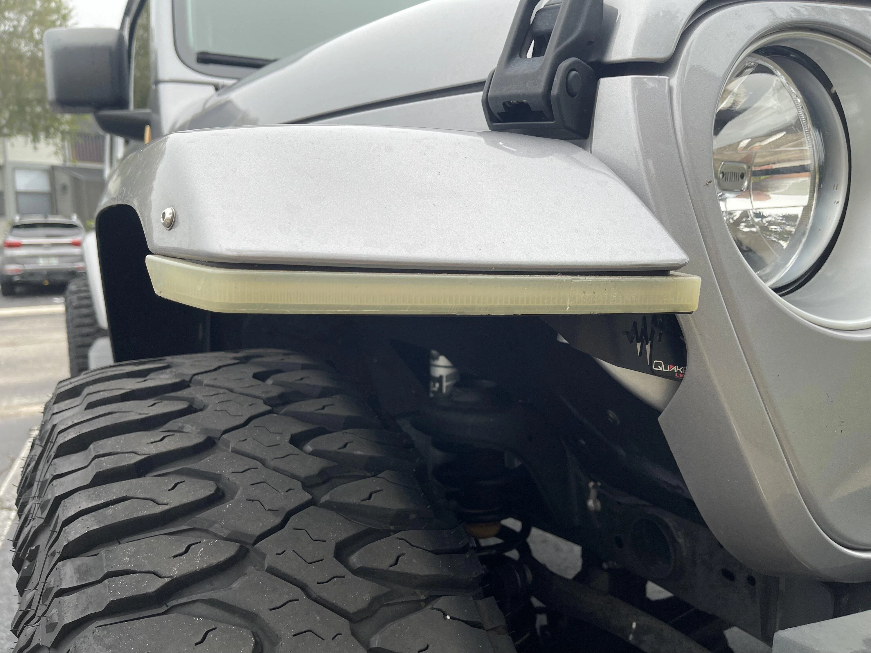

Jumping in here to say I have been running Quake's LED fender chop kit for the Overland model since April of 2021.
Here are pics of what the lens' look like as of this morning. I've reached out to them repeatedly and struggled to get a response - and they have limited who can and can't reply to their instagram posts, which is kind of a big red flag for me moving forward.
