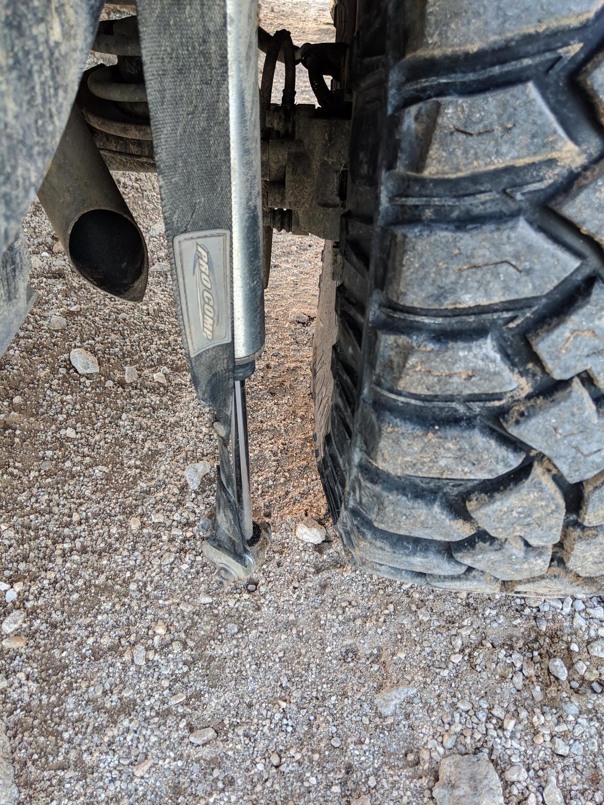

Air bump bottom out function is important. I have led Baja runs the past 20 years and got slowed down past Zoo Road on the way to Matomi Canyon this past February. Hitting the bumpstops all day led to my MX-6 Pro-Comps failing before Matomi Wash! Having active compression control would have really sped things up that day. I will take a look at your website today.
