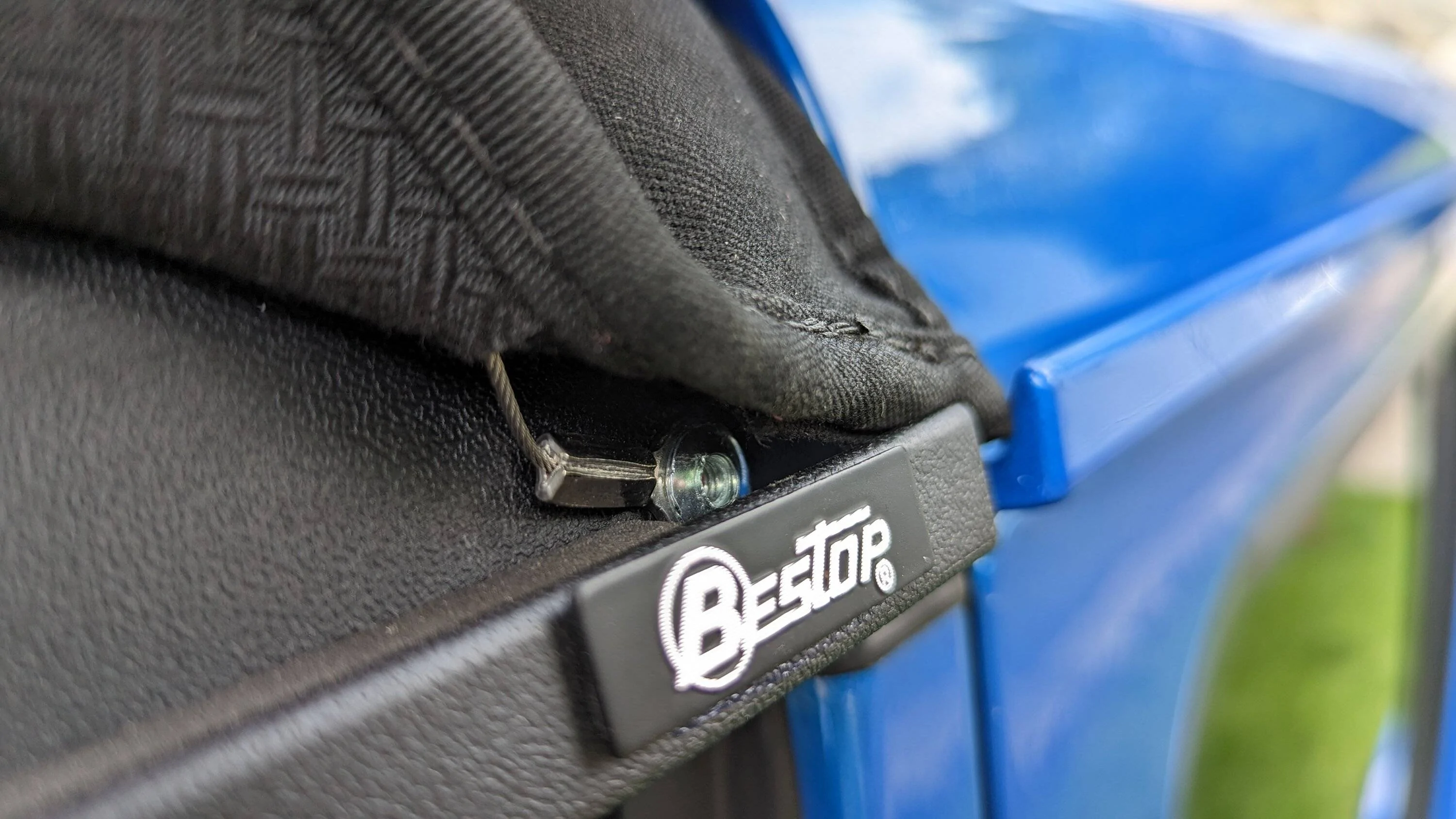

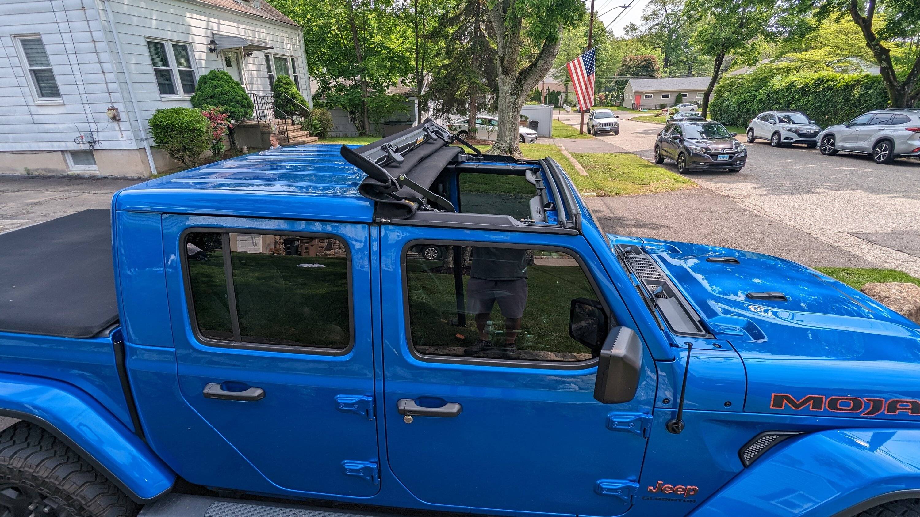

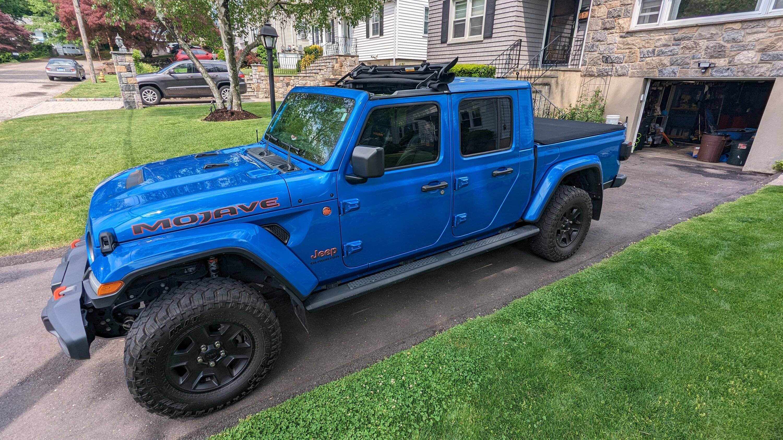

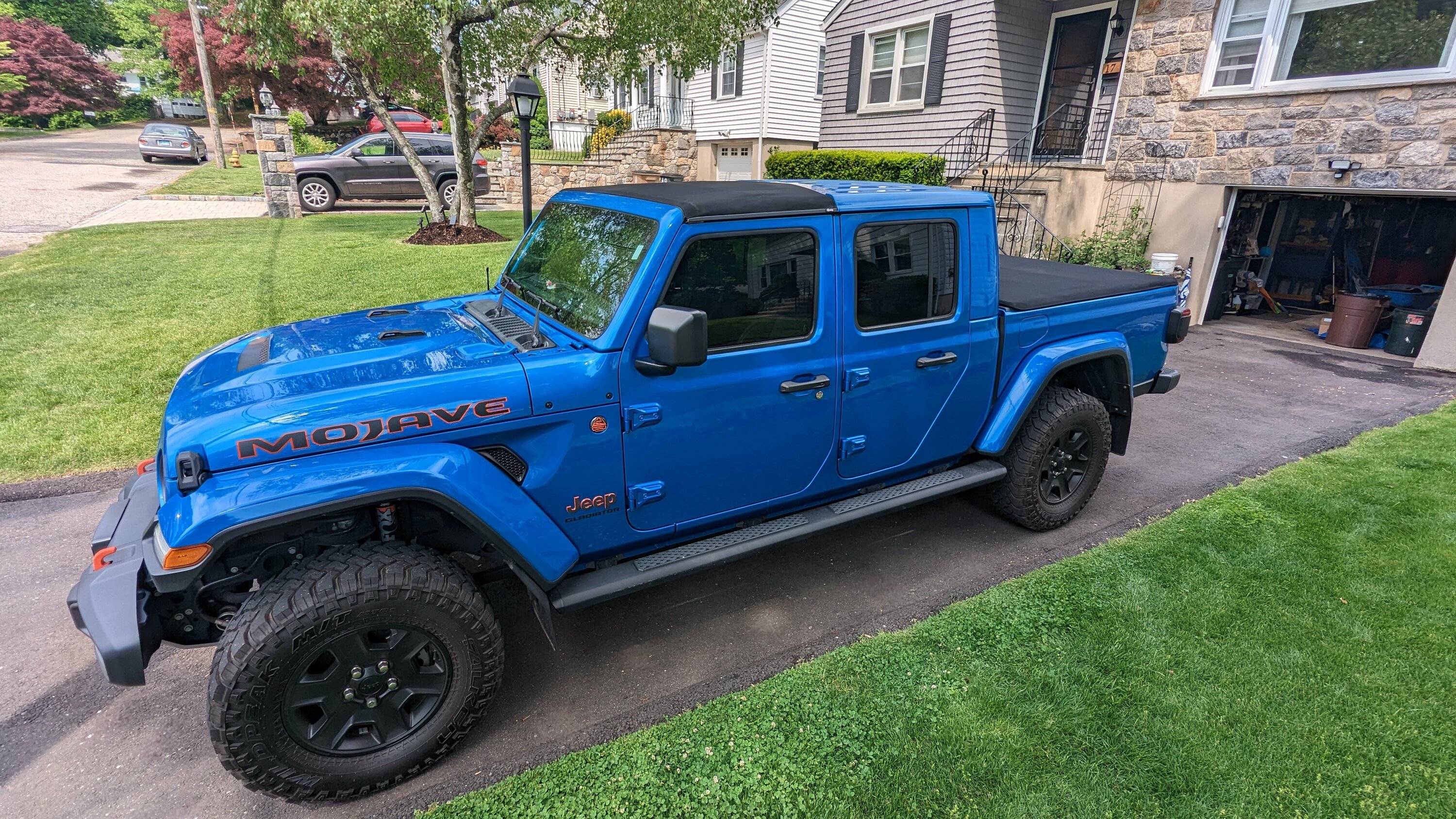

Haven't seen this posted yet on the forum so I thought I would share my experience.
I received my new Bestop Sunrider Soft top yesterday and I installed it today.
After reading multiple reviews and watching numerous u tube install videos I noticed some of the most recent comments generated from this past month on the Bestop u tube install video comment section stated that they got rid of the dreaded "z clips" and that they should update their install u tube video?
Turns out this was true and the "z clips" are now as I would describe them to be "o clips". Seamless 30 minutes install and super easy. My neighbor helped me out but it can be done solo too. So far loving the mod.

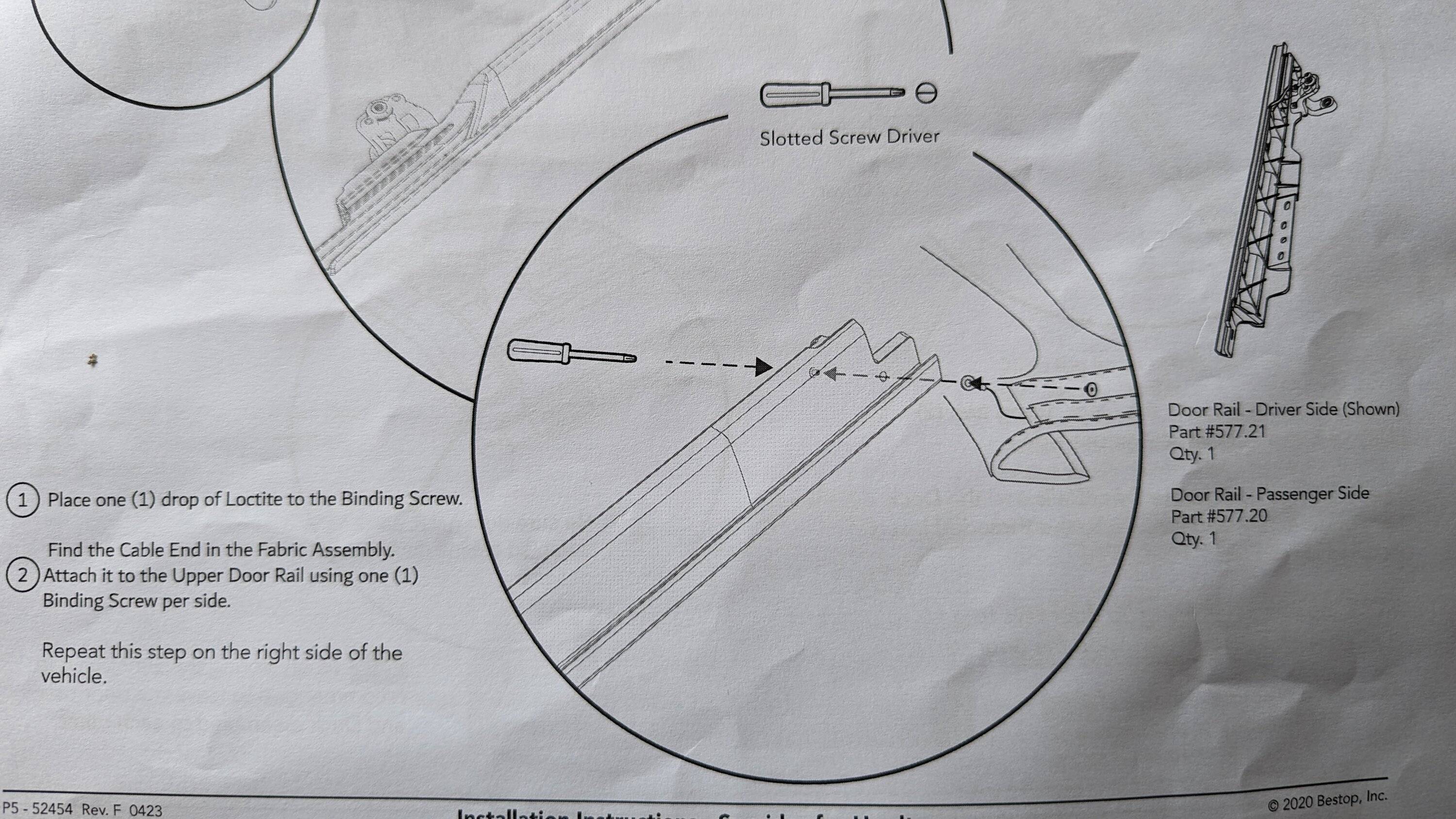

I forgot to take pics of the "o clips" before install/ attachment. Follow the written directions as you must screw the "o clips" in and attach them to the brackets first before mounting them to the upper frame. I made the mistake of following older posted install videos.
Great job by @Bestop on the update!

People Work?

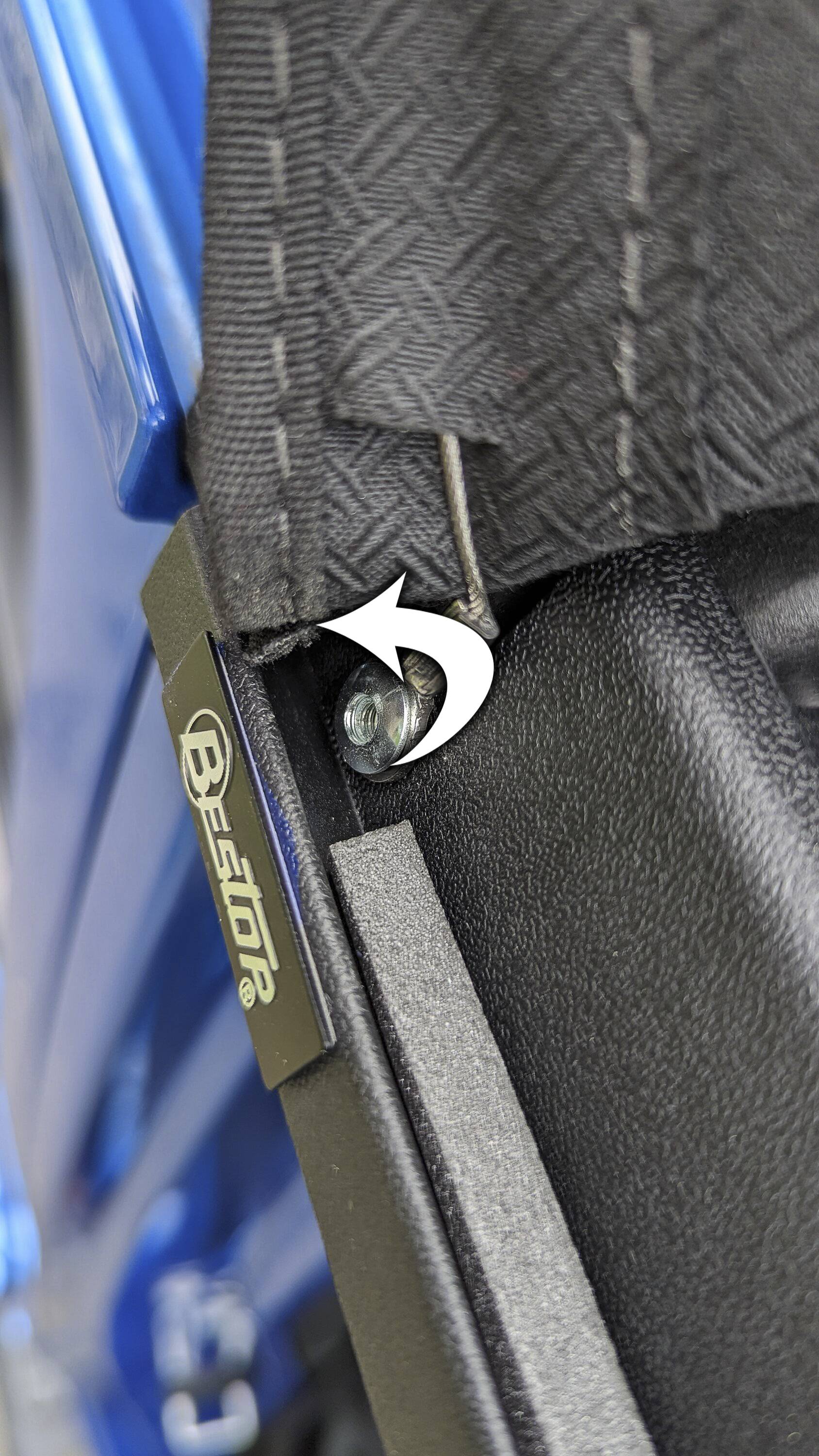

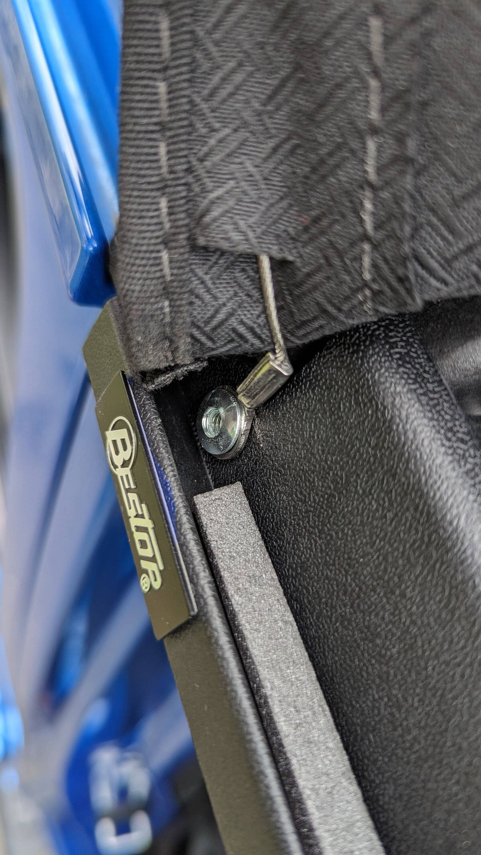

Does it stay loose to pivot on the axis of the screw?
This one looks like it would be less likely to fray if rotated a bit.

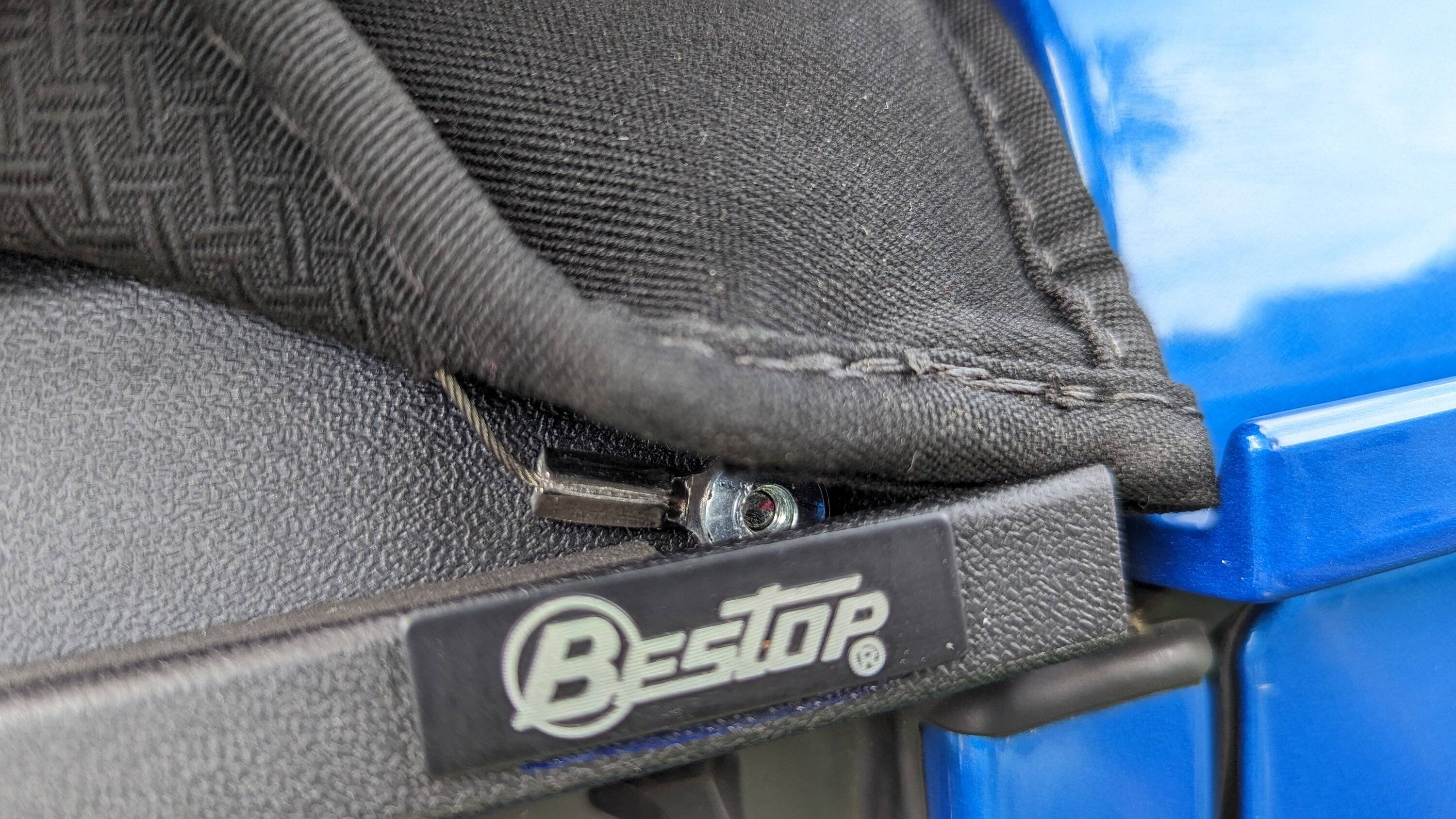

Jeep Gladiator Bestop Sunrider Update - No more "z clips" PXL_20230521_144504605

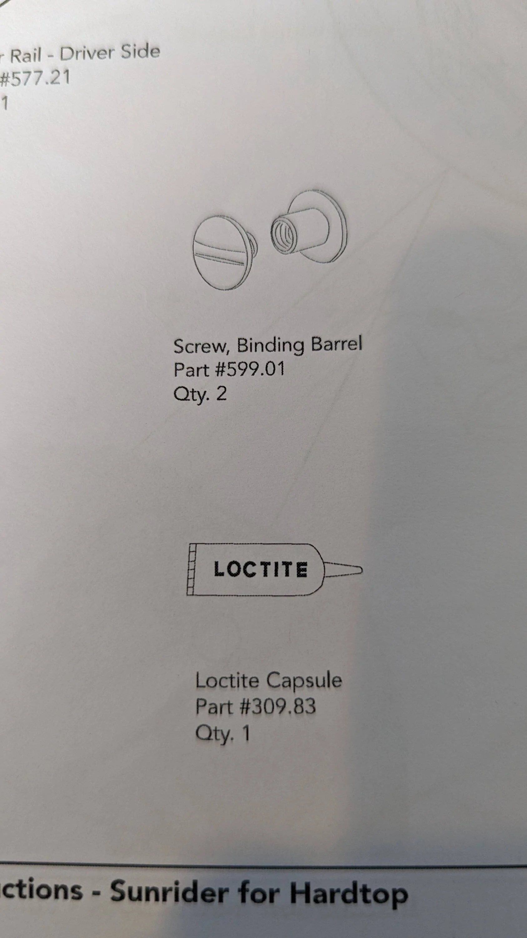

Yes it does. It attaches to a screw and a binding barrel that has a little give to it. They even provide a little loctite to apply on the screw.

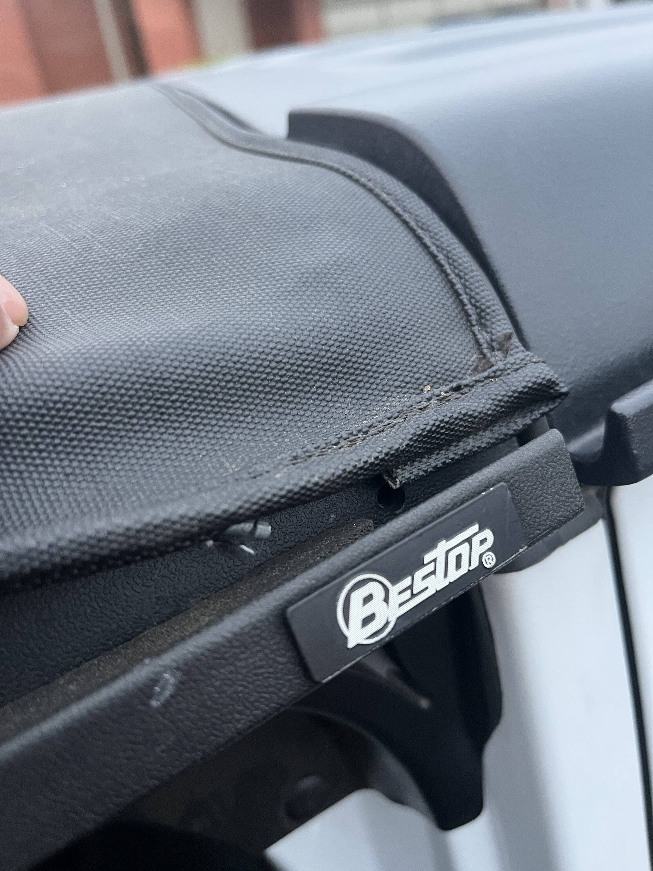

just noticed one of my Zclips was broken. Reached out to bestop and they refused to help without a receipt. Who keeps those??? Can someone provide a link on those rings. I made a splice repair with aluminum fittings but itā€™s not strong enough. wouldnt recommend the sun rider to other based on poor design with poor support unless you keep all your receipts.
Jeep Gladiator Bestop Sunrider Update - No more "z clips" IMG_4276
Not sure where you purchased your top from? If you bought directly from Bestop they would have your information on file.
With an expensive purchase like this I always either buy directly from the company or an authorized dealer. By doing so you will always get a digital receipt along with setting up an online account with the company.
Looked up Bestop warranty page and they are pretty tight on what is warrantied and to whom (original purchaser), how long and original receipt being needed.
I learned this same lesson on some Teraflex stuff and keeping receipts for warranty claim.
