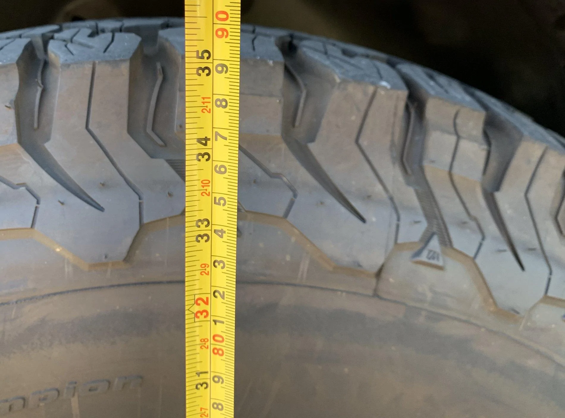

curious is someone has measured the actual size of a 37*12.50*17 K02 mounted on a 8.5" or 9" wide wheel.
wanting to go to a wider wheel and might add 37's at the same time, trying to stay as light as possible and K02's are on the very short list. don't want to add a lift yet or regear and curious if they measure closer to a 36" tire.
just for reference my 315/70/17's K02's measure 34 1/4" on a 7.5" wheel @ 29psi.

Btw I am not lifted. Nor have I re geared. I’m a sport s and am overall very happy with the outcome. Did I lose power. Yes of course. But I feel it’s perfectly fine as is without gears. I’m going to add a lift just cause I want it for looks.

perfect, appreciate the info.
that's actually less than I expected, was hoping for something closer to 36"... I would use a 8.5" wheel, would should give it a little more height. but that will not be a drastic change over what I'm currently at, which is good or bad depending on how you look at it. 5lb weight increase, less than 1" increase in size, and another $1500... OR I could just wait and change when my 315's are worn. knowing this I would have most definitely gone 37 K02's from the getgo.
I agree, I wouldn't regear either.
now I'm wondering how big the 39" KM3's are... don't really want a 13.5 though.

Those are 37x12.50r17 ko2 you have with no lift and no rubbing on a Sport?

sport s.....quadratec recon wheels push the backspacing out

Running. 37 ko2 on my rubicon. No lift. Stock wheels. Only slight rub when pulled hard all the way to one side

Most 37’s measure about 36” on the wheel and about 35.5 on the truck. Same for my Falkens.
I think people doing 37’s on stock gears are nuts. even if i had stayed on the stock 33’s i would have regeared to 4.33 or 4.56.
