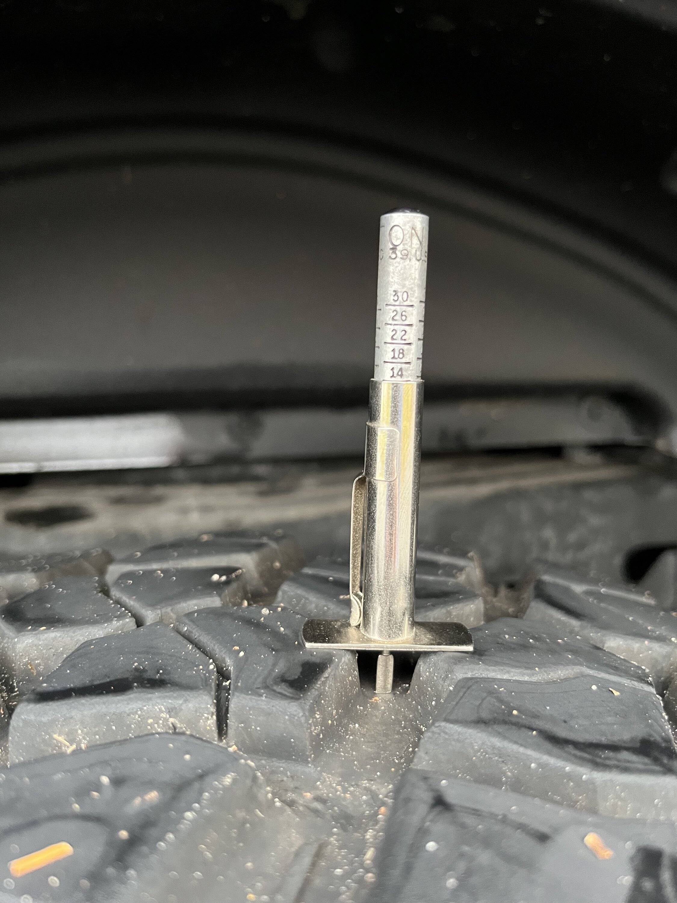

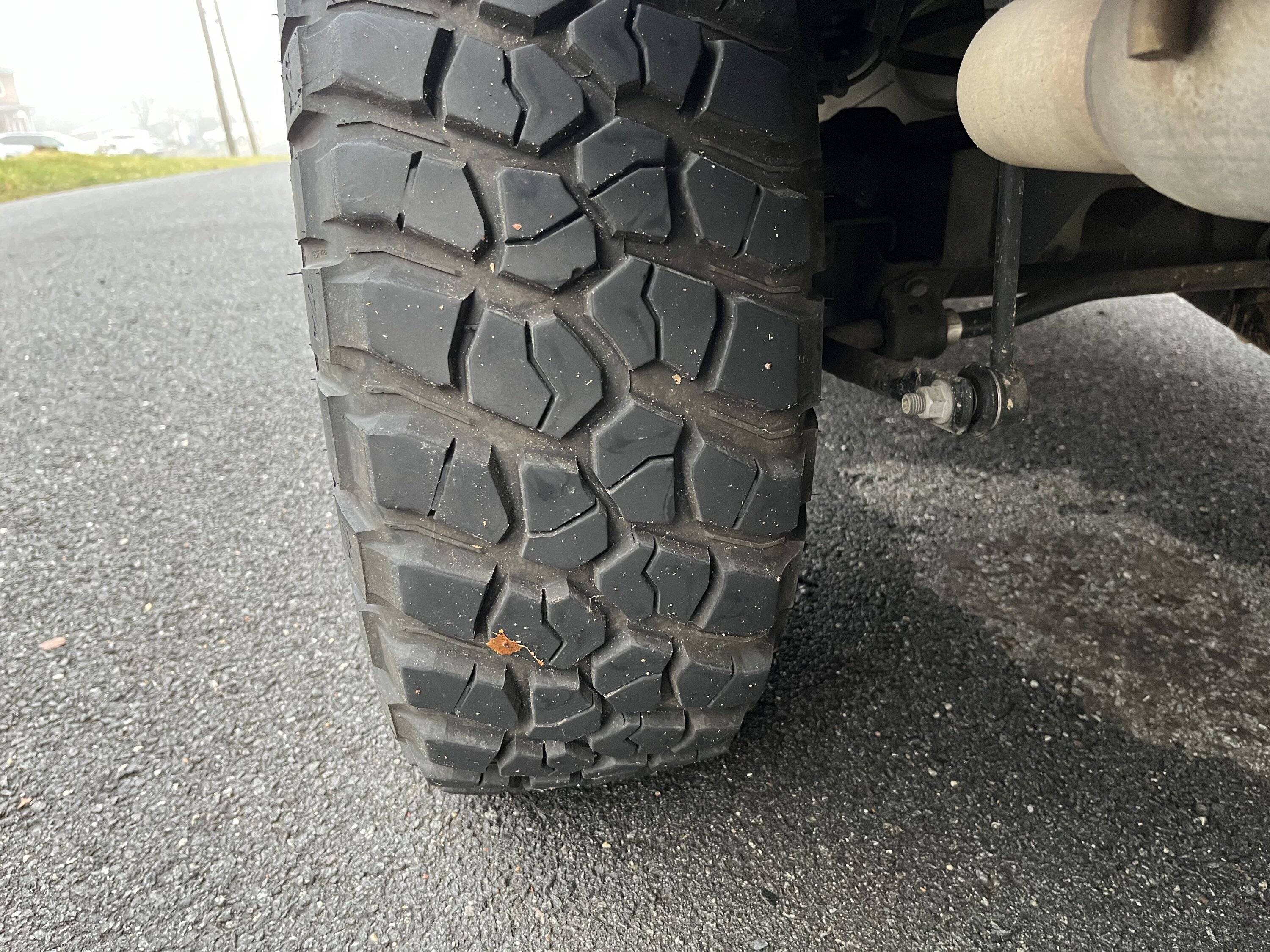

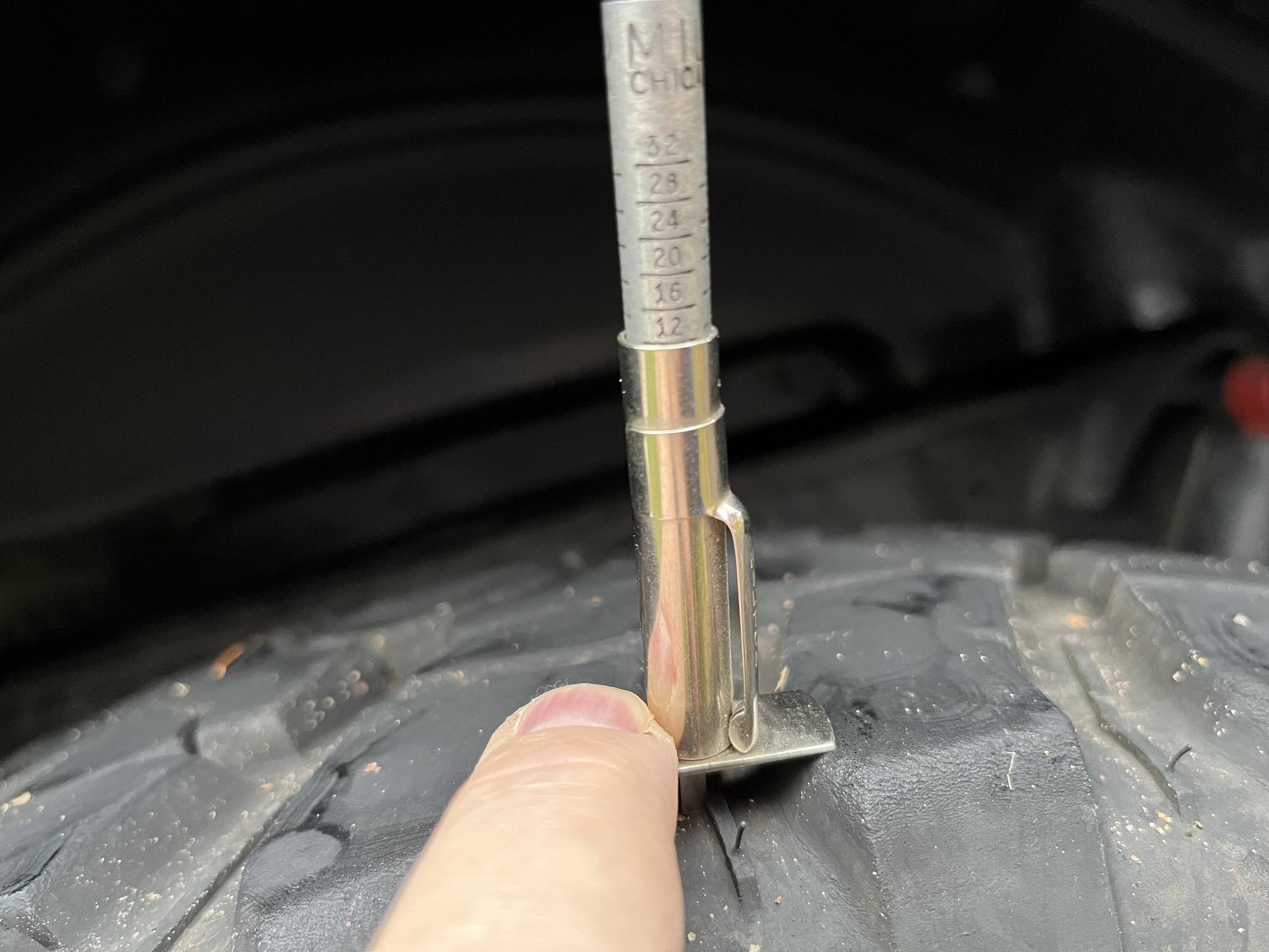

BFG MT KM3 Wear Report @ 12,500 miles, @~42-44psi
All Factory JT Willys ZF8 Pentastar, Hardtop
One tire rotation at 8500 miles.
Factory BFG tread depth measurement based on unused spare = 18/32
Fronts = 12-13/32 remaining depth
Rear = 13-14/32 remaining depth
Takeaways:
  1. Less than 1/32 variation from center of tire to either deep shoulder measurement. Very good. Indicating good alignment and near ideal tire pressures for the purpose of longevity.
  2. Recent winter blend Highway MPG was 19.5mpg. Very acceptable, IMO.
  3. Given the rotation schedule performed, the front tires have 50% more rear-axle time, and it would appear that the JT's (or the driver) are a bit harder on rear tires than fronts.
  4. The tires are loud, but not significantly more now, then when new.
  5. The tires have resisted excessively chopping.
  6. The tires are slick but very predictable in the wet.
  7. Offroad performance is outstanding.
  8. Dry performance has been moderate but predictable.
  9. Very satisfied overall and I will likely buy them again should I go MT.
  10. I have never encountered an offroad situation where I have wished for a larger tire. I'd rather squander my money on other more meaningless, wasteful, and destructive vanity purchases.
Jeep Gladiator BFG MT KM3's | Wear results after 12,500 miles IMG_8226
Jeep Gladiator BFG MT KM3's | Wear results after 12,500 miles IMG_8229
Jeep Gladiator BFG MT KM3's | Wear results after 12,500 miles IMG_8231
Jeep Gladiator BFG MT KM3's | Wear results after 12,500 miles IMG_8232
