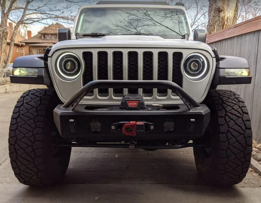

So I have done a couple retrofit swaps with my previous 2010 FJ Cruiser before selling it for the current 2020 JTR I own. I've always enjoyed doing the retrofits and my last retrofit to the FJ was the Morimoto MLED 2.0 Bi-LEDs (Jan 2020). My JTR came with the halogen headlights and like others have mentioned they are junk and borderline dangerous IMO. I recently purchased the Oracle Oculus 9" Bi-LEDs after reading positive reviews about them.
I chose not to retrofit the JTR this time for the following reasons...
1) Time Savings = took only an 1 hour to install the @ORACLElights Oculus 9" lights vs 2-3 days of retrofiting
2) Less adjustment set-up = typically you remove the entire reflector housing when doing a retrofit so that means to have to orient the horizontal beam plane (usually done with a "keyed ring" included with the retrofit but you still have to be mindful to make sure it's good before re-baking the headlight shut), vertical plane and correct width between the hotspot of the beam in relation to the centerline of the headlights
Basically I just really wanted something more plug and play this time around since the aftermarket seems to be doing a good job with the fully assembled units.

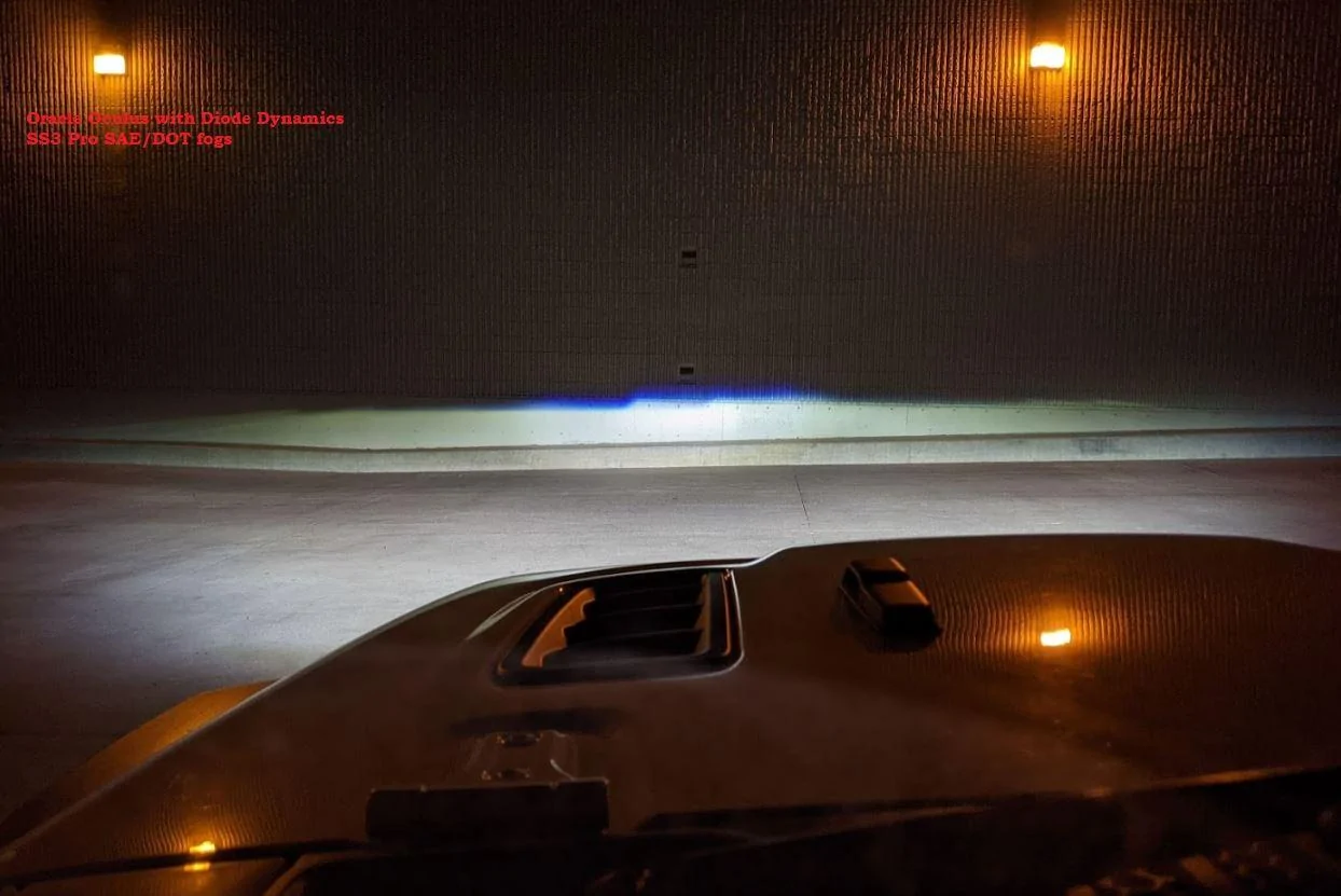

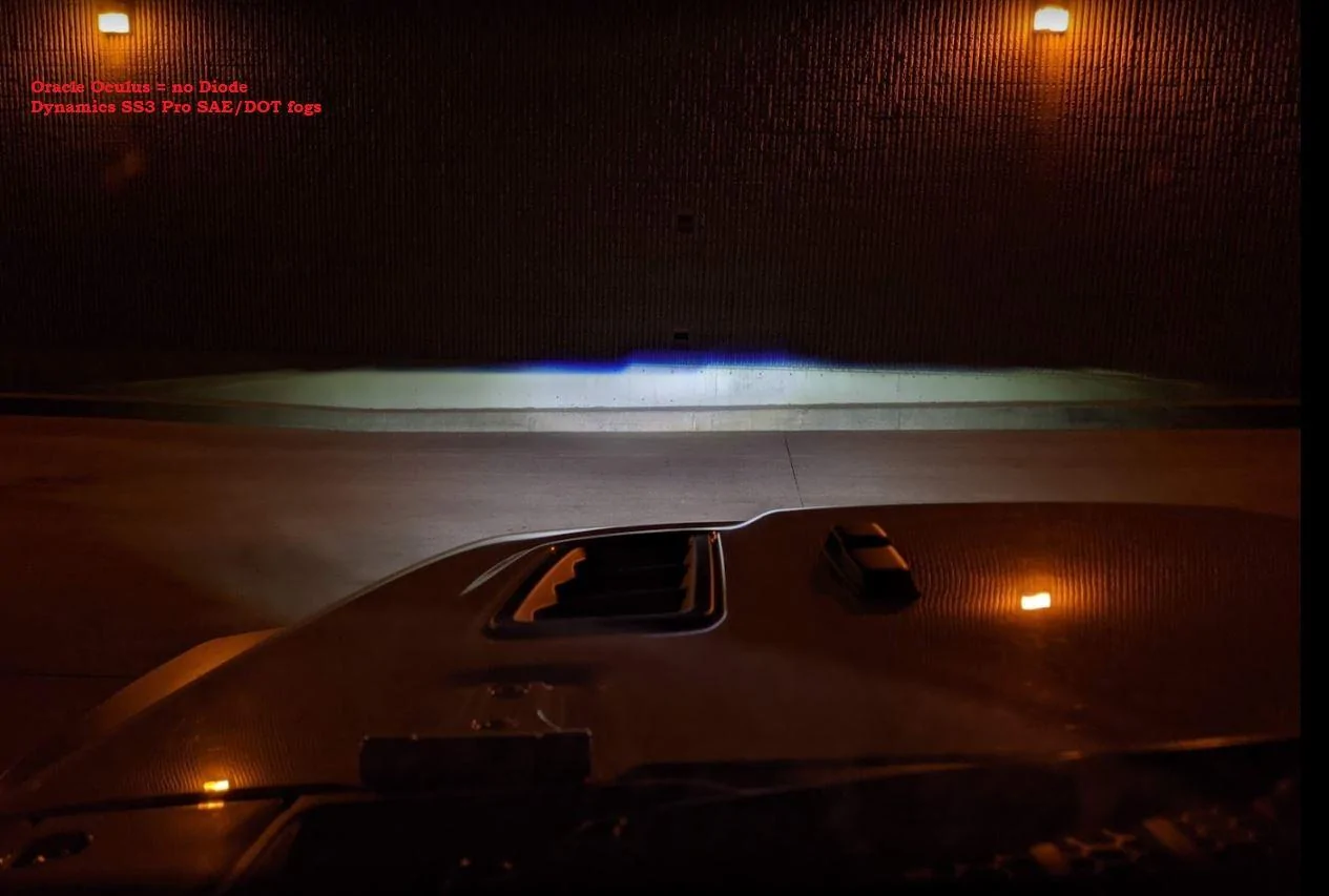

- Good 6K white light color... matches my Diode Dynamic white color of SAE/DOT fogs for reference
- Good cutoff line with a steep "step" in the vertical rise of the cutoff
- VERY nice high beam output

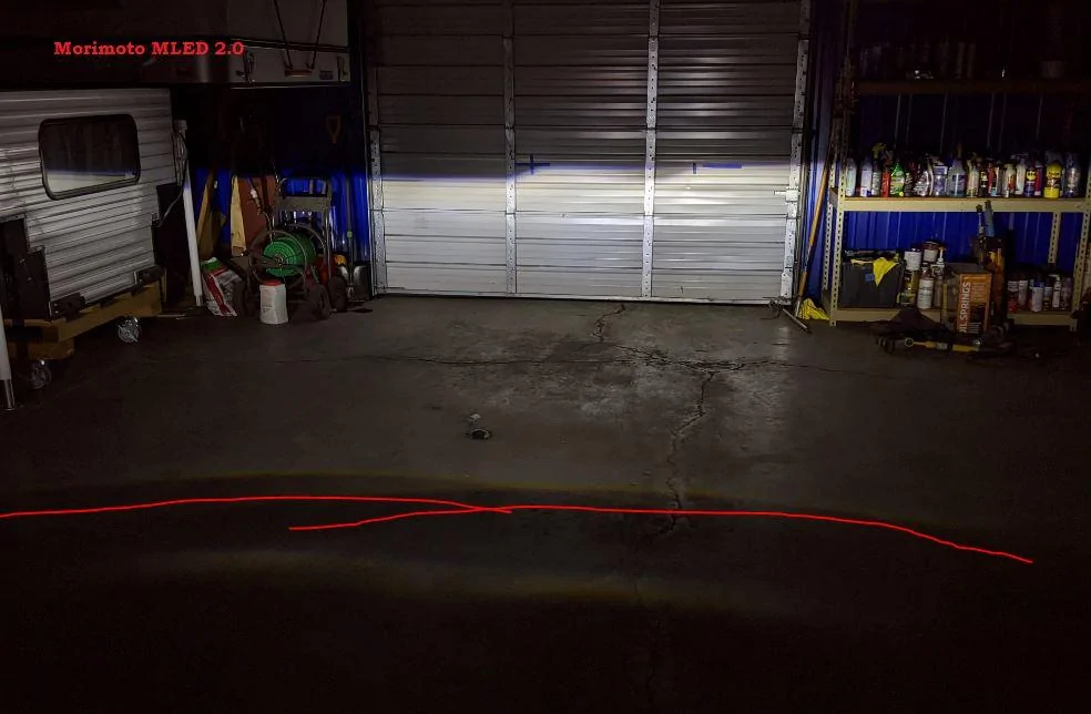

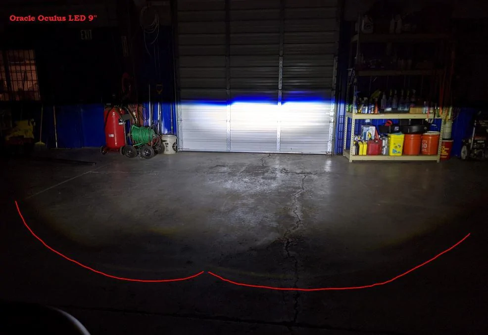

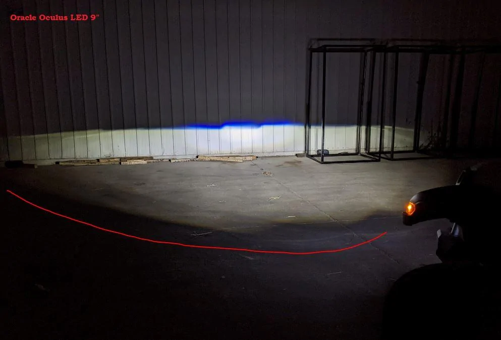

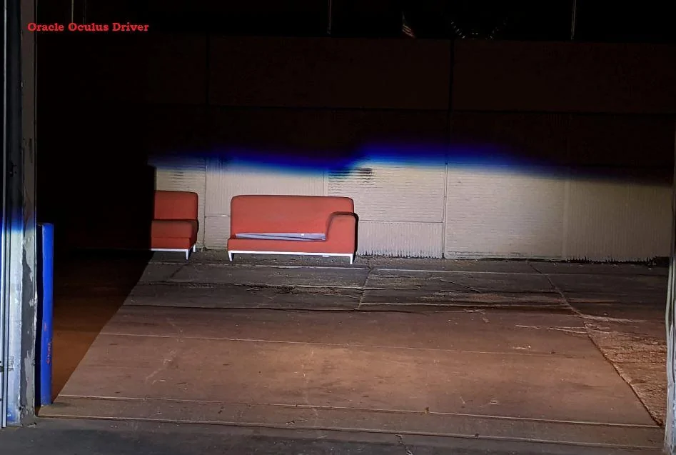

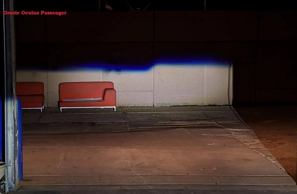

- Inconsistent cutoff performance in driver side vs passenger side... see the pics where the driver side beam is a little more sloppy overall that the passenger side
- The bowl of the projector creates a "U" shape for the foreground limiter vs the Morimoto MLED 2.0. This makes the overall beam pattern more concentrated in the middle like a flashlight circle output rather than a smooth, uniformed, wide dispersion of light like the MLED 2.0 (see red drawings in pics)
- Beam pattern is not as wide as the MLED 2.0's... fog lights are making up that difference currently
- Unable to adjust the beam center distance spread in relation to centerline of the headlights (I know I called this out as a positive at the very top but I'd like to be able to adjust this if I want)
Pros =

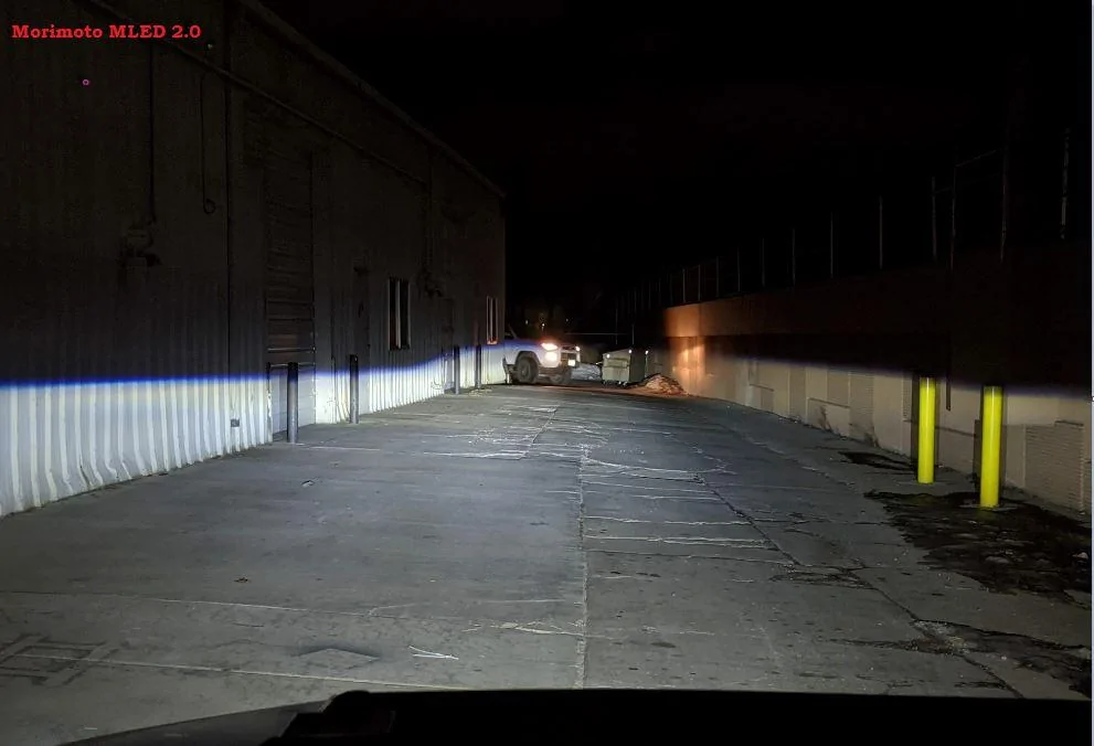

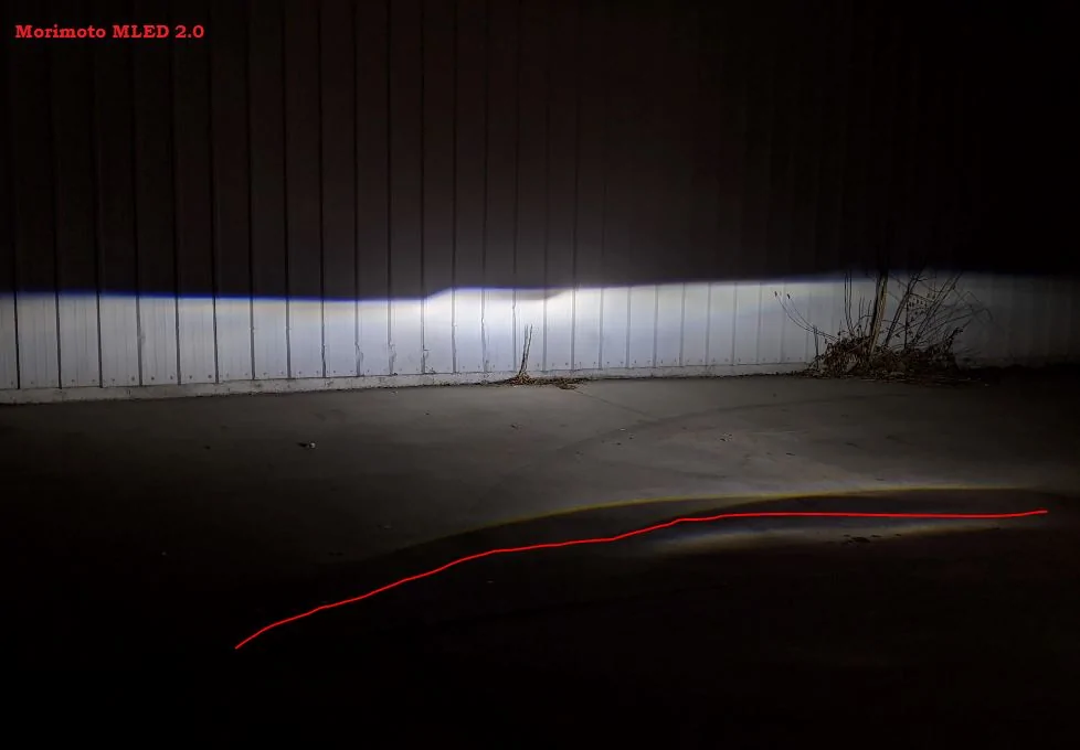

- Very precise cutoff line throughout entire beam pattern on both driver and passenger sides
- Wider beam pattern overall with lighting performance all the way to the edges
- Good 6K white light color... matches my Diode Dynamic white color of SAE/DOT fogs for reference (tied with Oculus in color)
- The bowl of the projector creates a "frowning upside down U" shape as the foreground limiter. This makes the overall beam pattern less concentrated in the middle and creates a smooth, evenly dispersed, wide projection of light (see red drawings in pics)
- Vertical rise in cutoff line is more "sloped" than "stepped" (this is a personal preference that I like a more vertical "step-up" transition to the horizontal beam)
- FULLY custom setup with plenty of human error to factor in the setup
Conclusion: I personally think the Morimoto MLED 2.0 Bi-LEDs have better overall performance.
