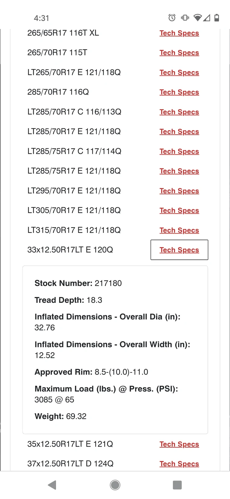

Not true at all and discount tire has a chart to go by that says you can mount up to a 37 12.5 17 on a 17x7.5 wheel. If you couldn't do it safely they wouldn't do it.
That's their chart

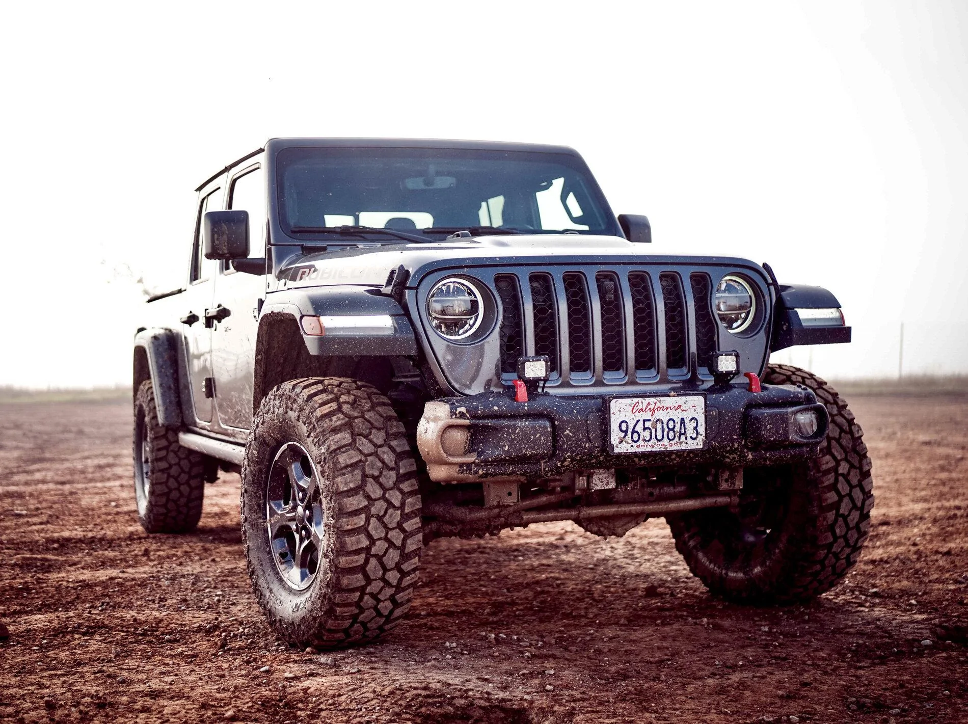

Mine that they mounted 37 12.5 17's on

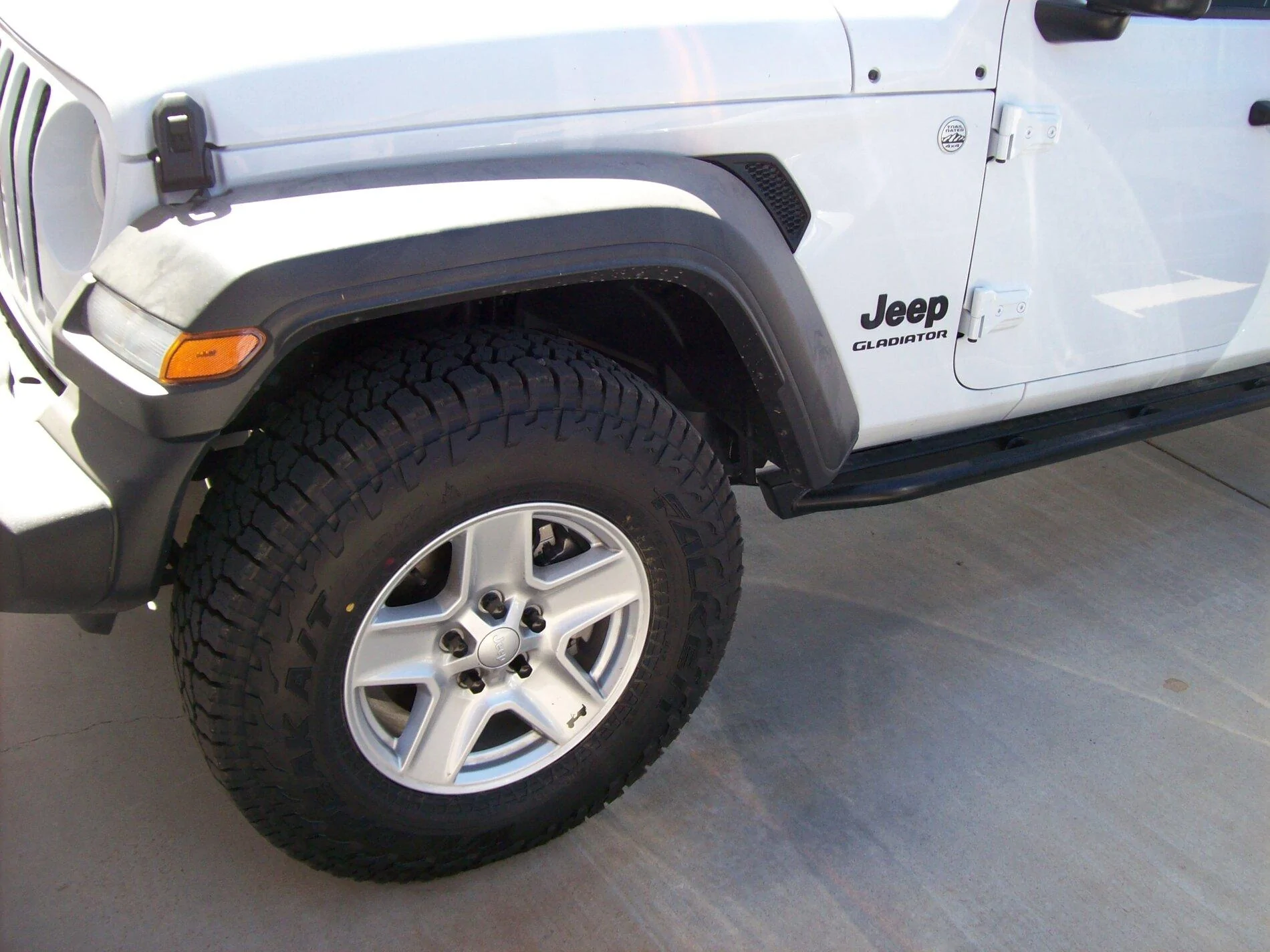

I made a conservative choice, 33.1" height spec, same width as stock on my max tow sport s. No issues with them and they have performed very well in all conditions I have encountered. Falken Wildpeak AT3W 255-80-17 E.

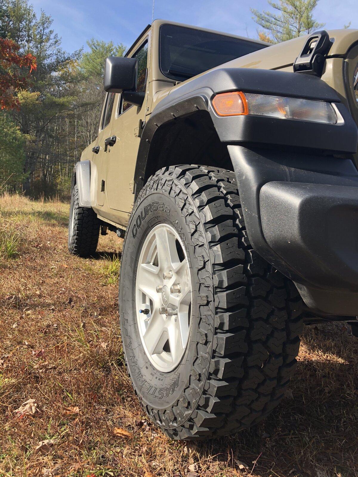

285/75/17 Mastercraft Courser CX
1 1/2” leveling kit
Zero issues with stock wheels
Truck does have max tow option.
