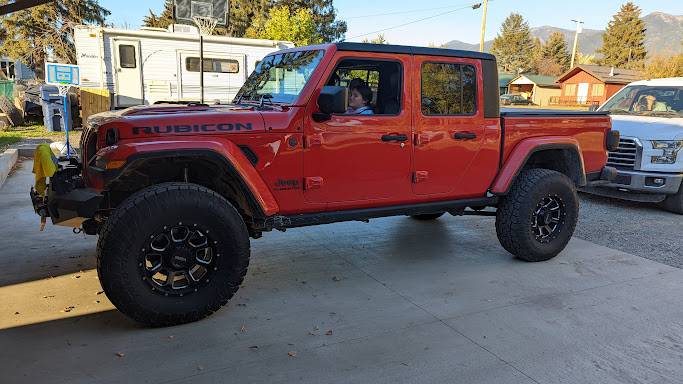

I have the Standard Capacity springs with this kit. https://www.aev-conversions.com/product/jt-2-5-dualsport-rt-suspension/
Constant weight is a Warn bumper and Warn Winch with steel cable. Running 37s Toyo Open Country AT3.
Shortly after install.
Jeep Gladiator Bilstein 5100 PXL_20221015_231925672

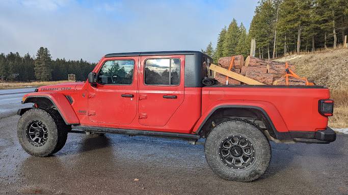

Here it is with a small load of heavy firewood. Was a little wetter than I anticipated.
Jeep Gladiator Bilstein 5100 PXL_20221126_185116700
How does it ride with that full load of firewood? Based on that pic I probably will need their HD springs. I'm assuming that load of wood was probably 200-300 pounds?
