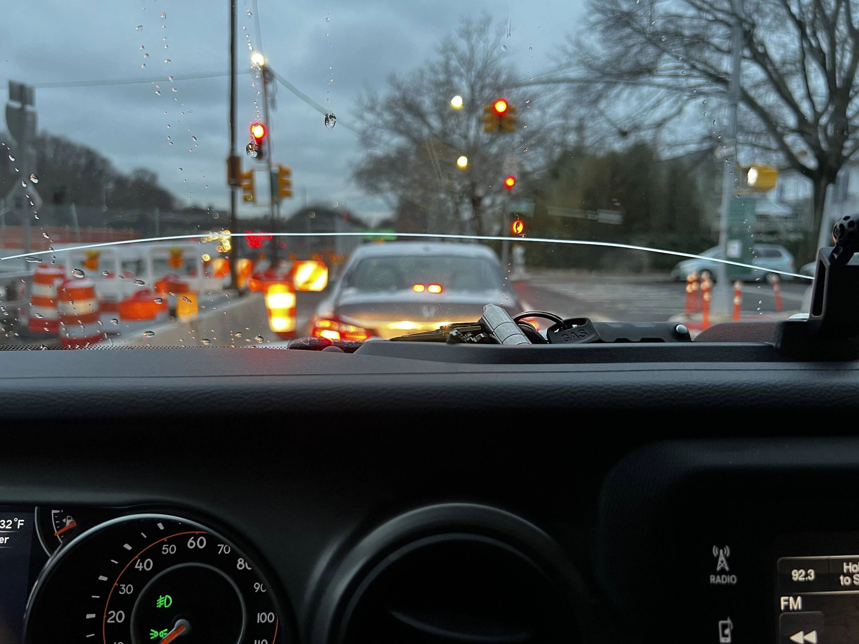

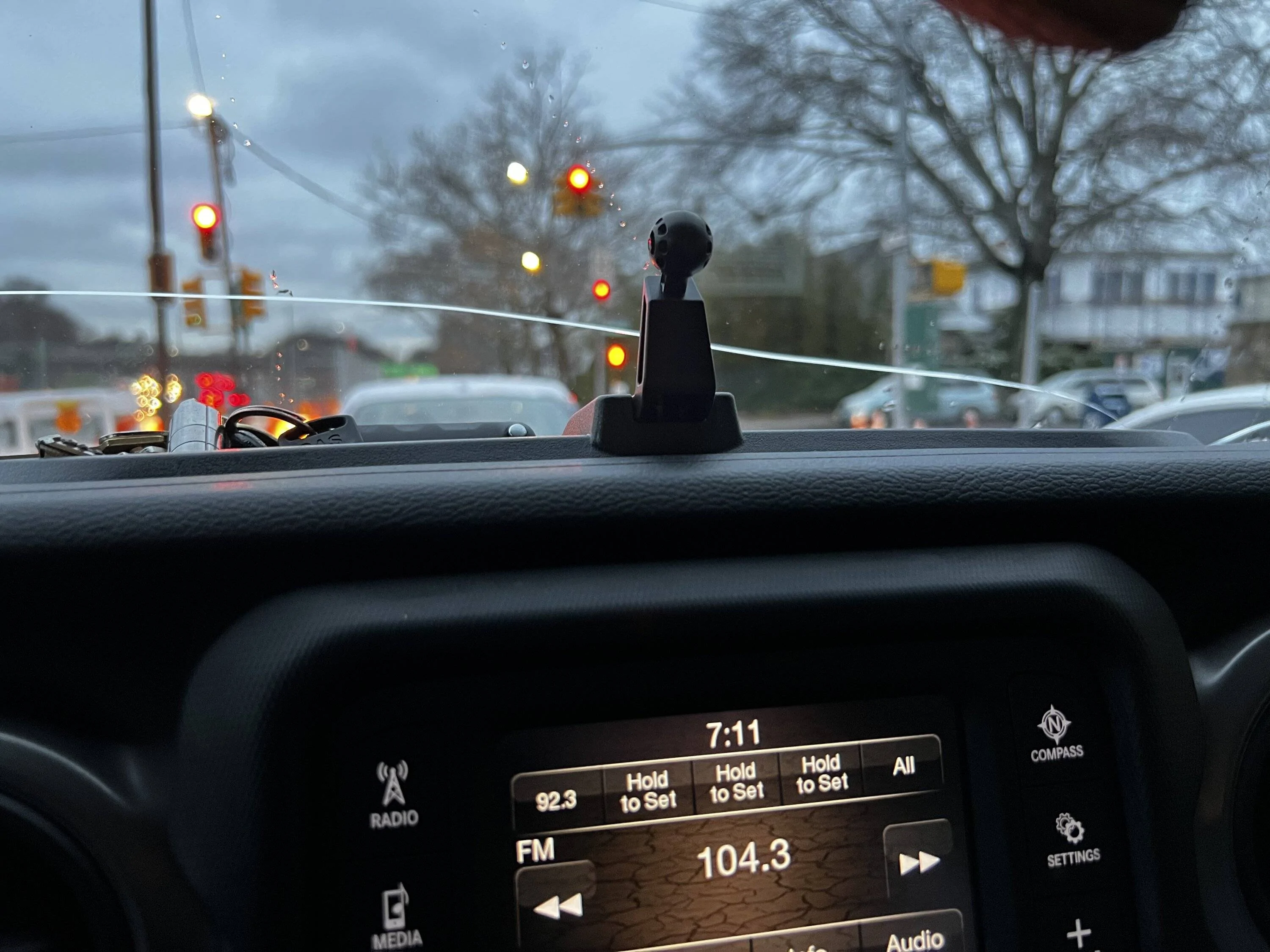

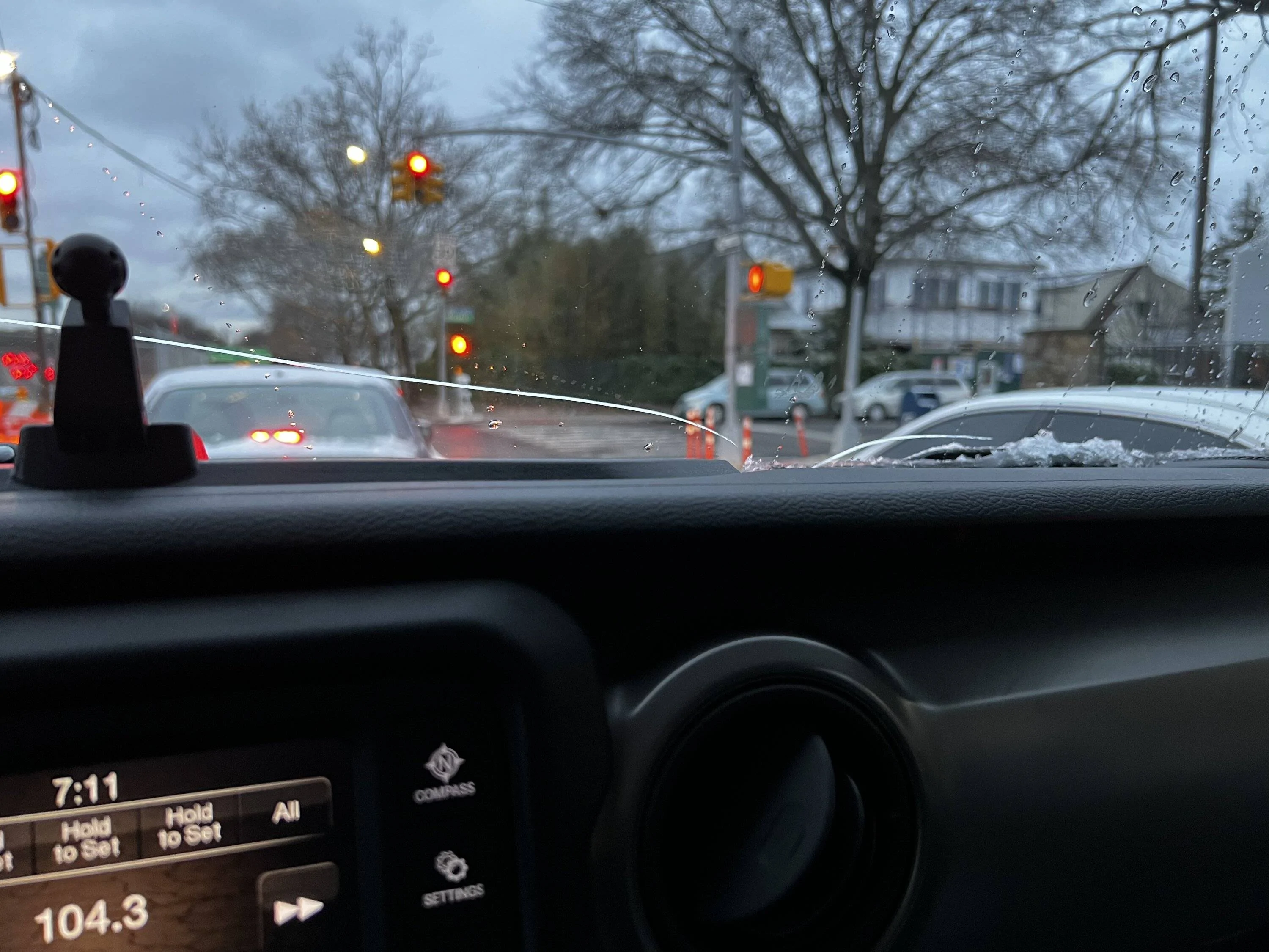

Low 30s this morning in AM. Had my windshield defroster on with heat at 70% or so. Windshield thawed completely and after about 6-7 mins of driving, stop at local bagel shop.
Turn truck off, go inside, come out 5 mins later to this:
Jeep Gladiator Bizarre windshield crack this morning B1742503-6652-4A77-BE42-75089839132A
Jeep Gladiator Bizarre windshield crack this morning D1436A56-1F5E-449A-8DDB-A87EB63F250B
Jeep Gladiator Bizarre windshield crack this morning D802E366-9B6F-459C-94F2-4407A26EF59E
Across the entire windshield. The only thing I can think of are the temperature changes back and forth from cold to hot to cold again.
Nothing fell on my car either. Gorilla Glass my ass....
Should I go through insurance or dealership?

It never hurts to run this through the dealership process first. You may end up with a replacement at no cost. Worst that can happen is they say no, and you move on. Never hurts to try though.
From your photos, it would be difficult for them to argue that this was impact related in any way. They'd have to show an impact point. Without that, the case for a manufacturing defect is pretty valid.
And this has nothing to do with it being Gorilla Glass or not. There's a clear misconception out there that GG is supposed to be impervious to cracks. Not sure where that comes from, but it's not true. It's just a different type of glass with different attributes. It won't prevent every crack or chip from happening, especially stress cracks like this.

One cold November night I was driving up 95 from Fayetteville to MD to come home for Thanksgiving. I started to get fogging on the windshield, so I turned on the defrosters and within a few minutes my auto-dimming rearview mirror cracked and spilled its fluid all over the dash. This was a 95 Land Rover mind you, but windshields are likewise susceptible to cracking with extreme temperature deviations. As Sharpsicle mentioned, this can happen to any type of glass, but thinner and larger panels are more prone.
To cut weight manufacturers are using thinner glass and depending upon how resilient the mounting is stress cracking can happen. I suspect something in the jeep mounting inhibits deformation and so stress develops.

That looks similar to the Crack mine developed when I took it in for its first oil change. Dealer repaired,replaced it for me. I dropped it off and no Crack they did oil change and tire rotation pick it up and cracked go figure. They insisted there l was no way they did it but fixed it for me free of charge as a gesture of goodwill. Gorilla glass also.

Yeah, what he said. Here, they take the thing in, and use a crazy great glass cleaner that takes off even the worst bug glue nature can dish out, the glass shines after they clean it. And then they have a bright magnified light and look it over.
On my first one they found a really teeny - and I mean hard to see but I did see it and agree, chip that was the root cause.
Had that not been found, it would have been warranty - they flat out said "maybe warranty, but we have to look". Dang.
Impacts are "generally" more likely to go vertical on these.
The horizontal are more typical of stress cracks.
I had an almost identical crack across my F250's windshield after using the defroster hot and heavy on a cold snowy/icy winter morning. It went side to side.
These being glued into a solid frame but one that is movable with stresses and temperatures, it's another reason they are more prone to breaks like that. The frame isn't as stable as when it's part of the structure itself. They are hinged at the bottom, two bolts at the top - it's not an ideal situation for flat glass.

Look closely at the bottom of your windshield where the 2 cracks in your last picture dip below the dash. I would bet there is a small chip where those 2 cracks join near the bottom edge of the glass. I've had other vehicles get a small (I'm talking barely visible) rock ding at the window edge which couldn't be seen from the inside due to the black surround coating along the edge of the window. Any miniscule chip near the window edge will easily propagate a crack.
A chip on the edge will guarantee a crack. I've done enough windshield replacements and salvaging, and trim swapping to know - you so much as hear the sound of a metal tool against the edge of the glass, get your checkbook out - or in the case of our cars - might as well not bother trying to salvage the windshield for re-use.
I've got a good example sitting in a car next to my shop - trim removal went awry - 6 months later, the glass cracked a nearly straight line. Oops.
