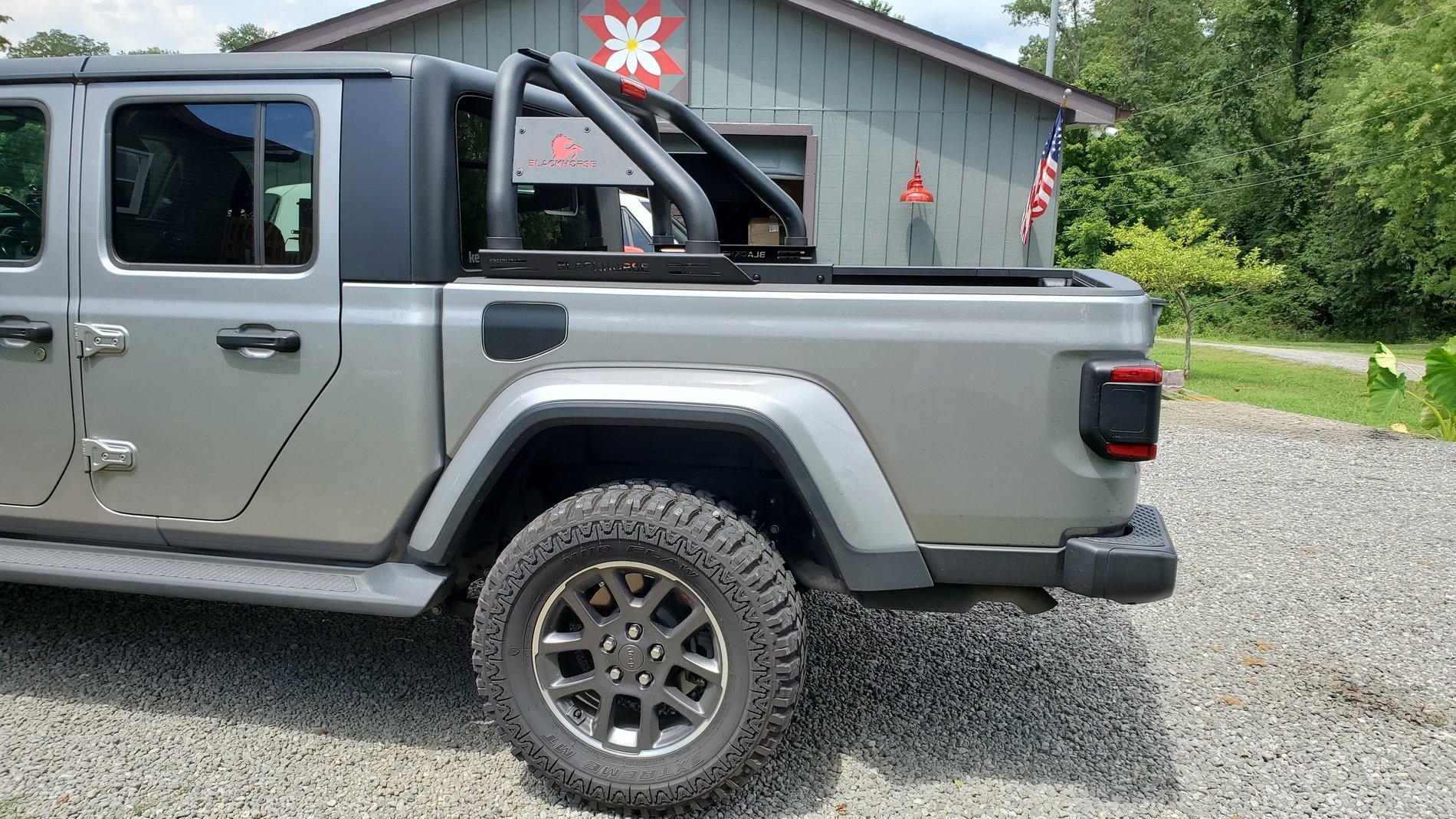

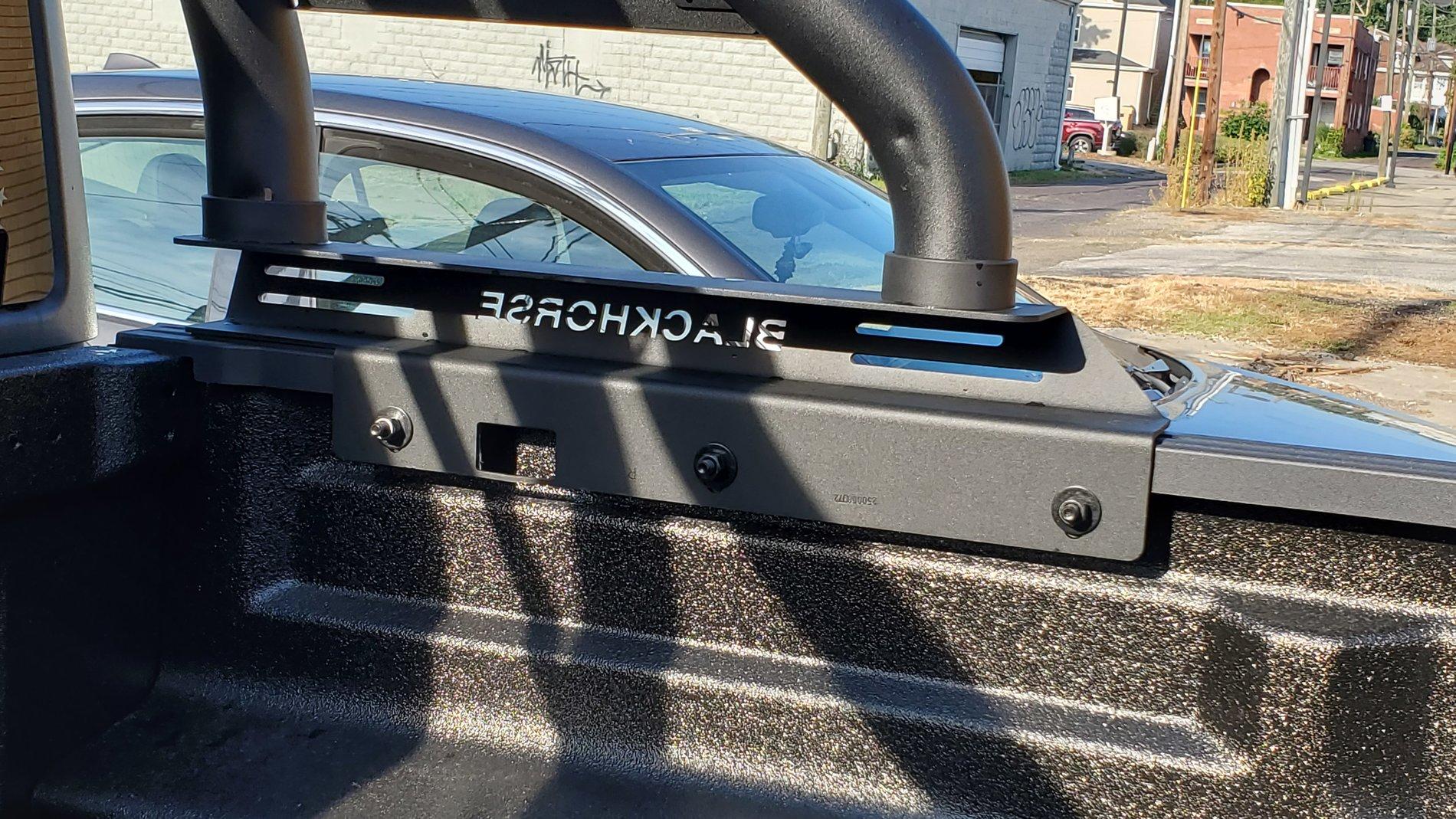

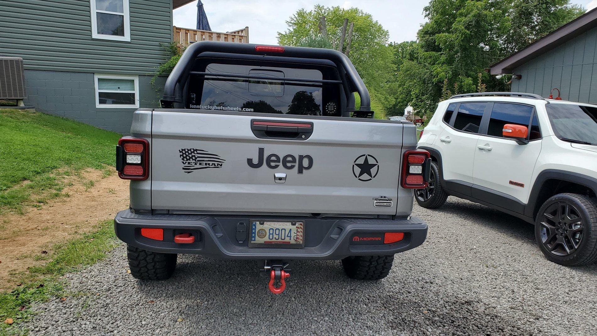

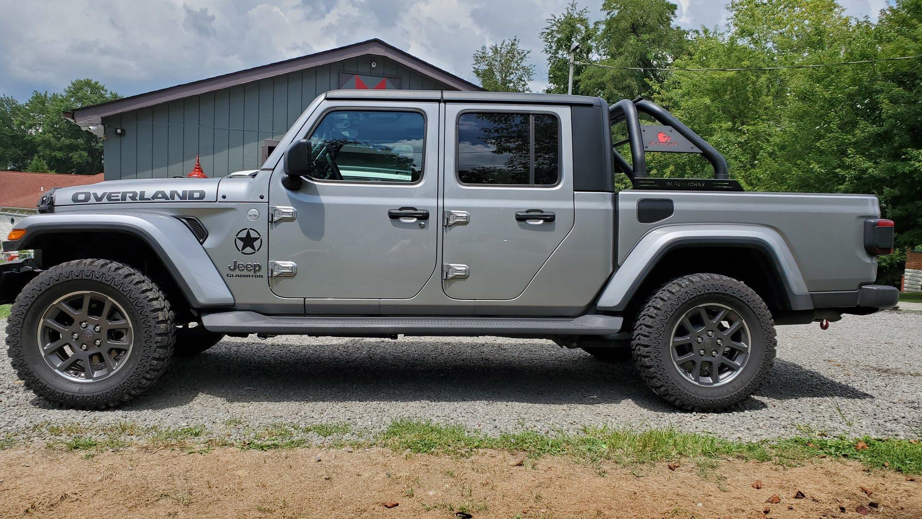

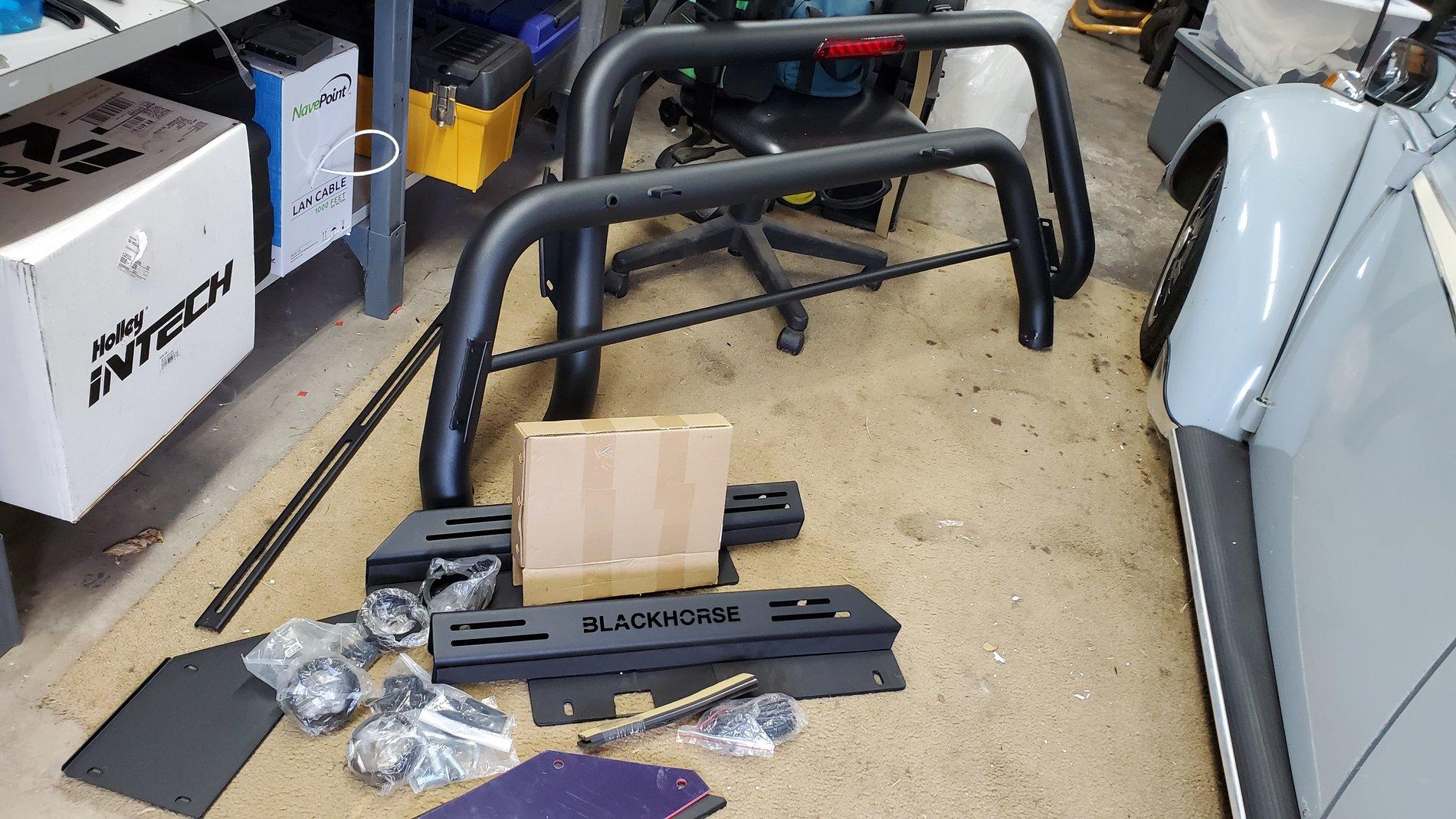

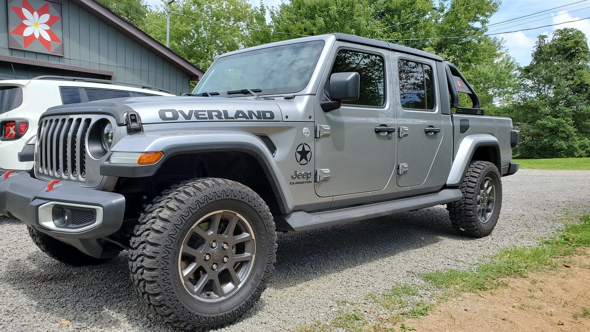

As I mentioned in a previous post, my roll bar was damaged (dented/paint chip) on the very end of one of the bars. They're sending me a replacement part, but that didn't prevent me from installing. I can replace the damaged part when it arrives. Love the way it fits, doesn't make the truck look too long. So far, impressed with the quality and fit. Takes about an hour to install, no drilling necessary. Still have to connect 3rd brake light and decide on a light bar or not. Maybe old school off road lights..

Looks great!! How was the install? Is that designed to mount into the cargo rail system if you had that as a option?
Looks like there is room for a tonneau cover to mount as well
Thanks for any info you can share

Do you have a cover you plan on using? I was told Tyger T3 tri fold will work this this blackhorse rollbar

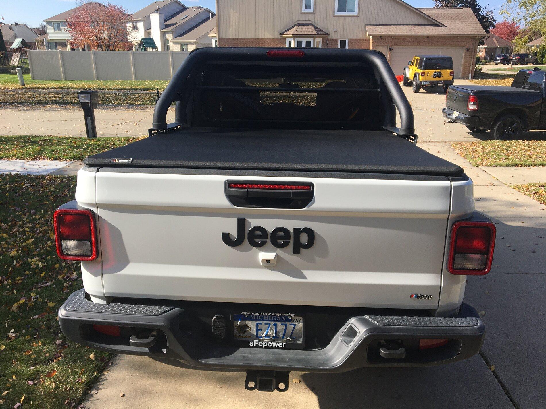

I like the design of this roll bar. What are your thoughts after having it a little longer? Did you install a tonneau cover yet?
I have a soft roll tonneau that I think would work with this, but it looks like I would only be able to roll it up about 2/3 of the way. I could probably make that work. How long is the top of the mounting plate that the bottom of the bars mount to? I think this would give me an accurate measurement of how much roll up room I lose for my tonneau cover.

Its about 27 1/2 inches. I have a tri fold and can fold up 2 of the 3 sections.

Thanks! Looks good. Is it easy to wire up the 3rd brake light?
I put 4- 6" LED spotlights forward and a 32" lightbar facing rear. Wired up to the auxiliary switches from the factory.
Jeep Gladiator Black Horse Roll Bar Installed 20201222_160839
Nice! How well do the lights work on the roll bar being that far back from the front of the truck? Was it fairly easy to wire them up? I've been thinking about adding the aux switch kit from Mopar, but all the lights I look at don't seem much brighter than my headlights/foglights.

Thanks. I didn't wire up the 3rd brake light because its in the tailgate. I'll be putting on 4 KC 6" daylighters.
I had them on my ram rebel crew cab on a roll bar and the light was good and didn't reflect off the hood that much. They were spot vs flood so I got to direct the beam right where I wanted

Did you ever hook-up the 3rd brake light provided in top of roll bar ? I ran provided wiring inside roll bar and now just have it tied off. Is there a location to best connect to existing brake light wiring ? I just finished install on my 2021 Gladiator High Altitude and looks terrific. I also have a hard Tonneau Mopar factory installed cover unit, and the Black Horse special bracket provided w/ their Part # RB09BK looks and works good. I can fold back two full panels on Tonneau cover, and just needed to buy 1' long strap extenders to secure cover in that position, with cover resting against roll bar posts (rubber part of cover is there so it doesn't scratch roll bar). You need someone w/ very small hands to install front-rear end cover M6 bolts.
